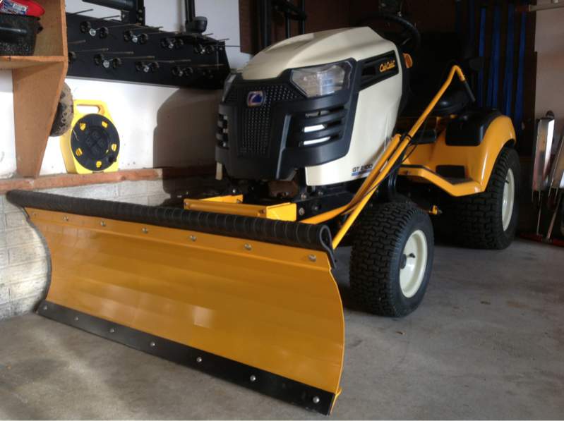

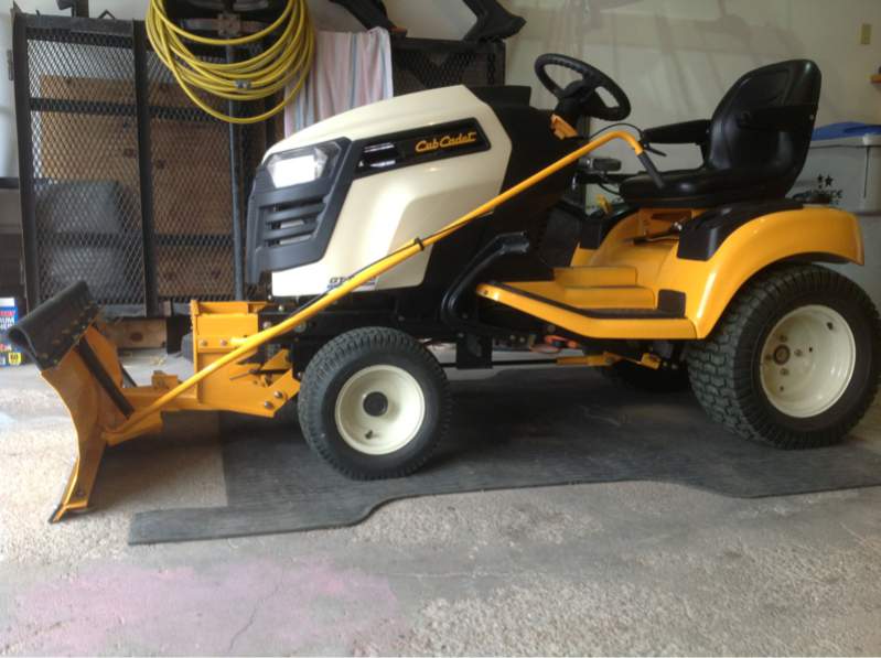

Hi Milo,
It sounds like you are looking for the exact set up I purchased last May. I was looking for a real "garden tractor" not just a mower because I mow some fairly steep hills, tow my dump cart and 4x8 trailer and rent a commercial aerator twice a year. I also needed a machine that would move snow as I live in a circle and clear it and 5 steep drives. My previous tractor was a 1978 John Deere 210 with a 39" 3 blade deck and a 42" front blade, that old girl was built like a tank and served me well for years but it was getting to the point where I was repairing as much as operating so she had to go. What did I purchase you ask, we'll after much research I found out a new model Deere with the capabilities as my old unit would cost about $8000, my budget was about 1/2 that & the only tractor I found in my price range heavy duty enough was the 2000 series Cub Cadet. So I went to a real Cub dealer and checked them out, they use the Kohler Command series engines, and are in my opinion one of the best small engines made today, they have shaft drive and a cast iron hydrostatic transmission that holds 6 quarts of fluid! I too started looking at the GT2000 but they had a price special on the GT2100 with 23HP instead of 20HP, 23x10.5x12 rear tires and electric deck lift which also lifts the front blade, all for only $100 more, sold! I can tell you, after having it almost a year it has well exceeded my expectations, I liquid loaded the tires, put on 2 link chains and about 200lbs on the back and my GT2100 pushed snow like a 1/2 ton pickup, but better cause I can get into tight spaces, the electric actuator lifting the blade would have been worth $500 more! I just got 5 yards of dirt to construct a landscape berm and with the front blade was able to push, form and compact the soil without having to lift a shovel. I have the 42" deck because I have allot of hills and landscaping so I can get in and out of tighter spaces, it turns on a dime & with the mulch kit it minces grass & leaves to bits. I can pull my 4x8 trailer loaded with a yard of mulch around my yard & up the hills with no problem, and with shaft drive there are no belts to slip or break, in fact theres only one belt on it, from PTO to mower deck! I have seen photos of one with a Johnny Bucket front loader and rear sleve hitch, these are rated for ground engaging equipment.
IMO the Cub Cadet GT2000 series is easily the best new garden tractor for the money available today.
See photos of my new love (don't tell my wife).
