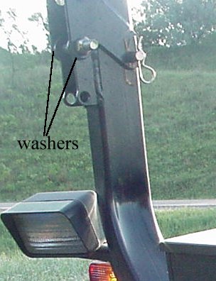

Initially I had problems with getting the rops unfolded. I purchased some washers that fit the rops hinge bolt. Remove one of the hinge bolts and insert washers as needed to keep the rops in the correct position when unfolding. You may need to add washers to the other hinge bolt also.

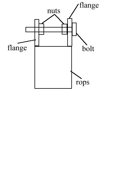

I also had to slightly spread the flanges with the pin holes. I did this by putting a bolt through the pin hole with 2 nuts on the inside of the flanges. Then take a 2 wrenches and turn the appropriate nut to spread the flange. This may make more sense if you look at my simple sketch. I didn't have to spread it very far to make it work smoothly. I can put the rops up and down with one hand without any binding.

I also removed the keyring type pin holders and replaced with pin spring clips(not sure on the name, see picture). I am sure the keyring type are more secure, but were very time consuming to put in. I know that things that take too long, don't get done. I wanted to make sure the rops was fast and easy to fold and unfold, so I didn't get in the habit of Not putting the rops up when taking the tractor out of the garage.

As to spreading, I'm not sure whether the best solution is spreading the flanges or maybe there is an adjustment for aligning the uprights. I'll get back here after talking to the dealer.
