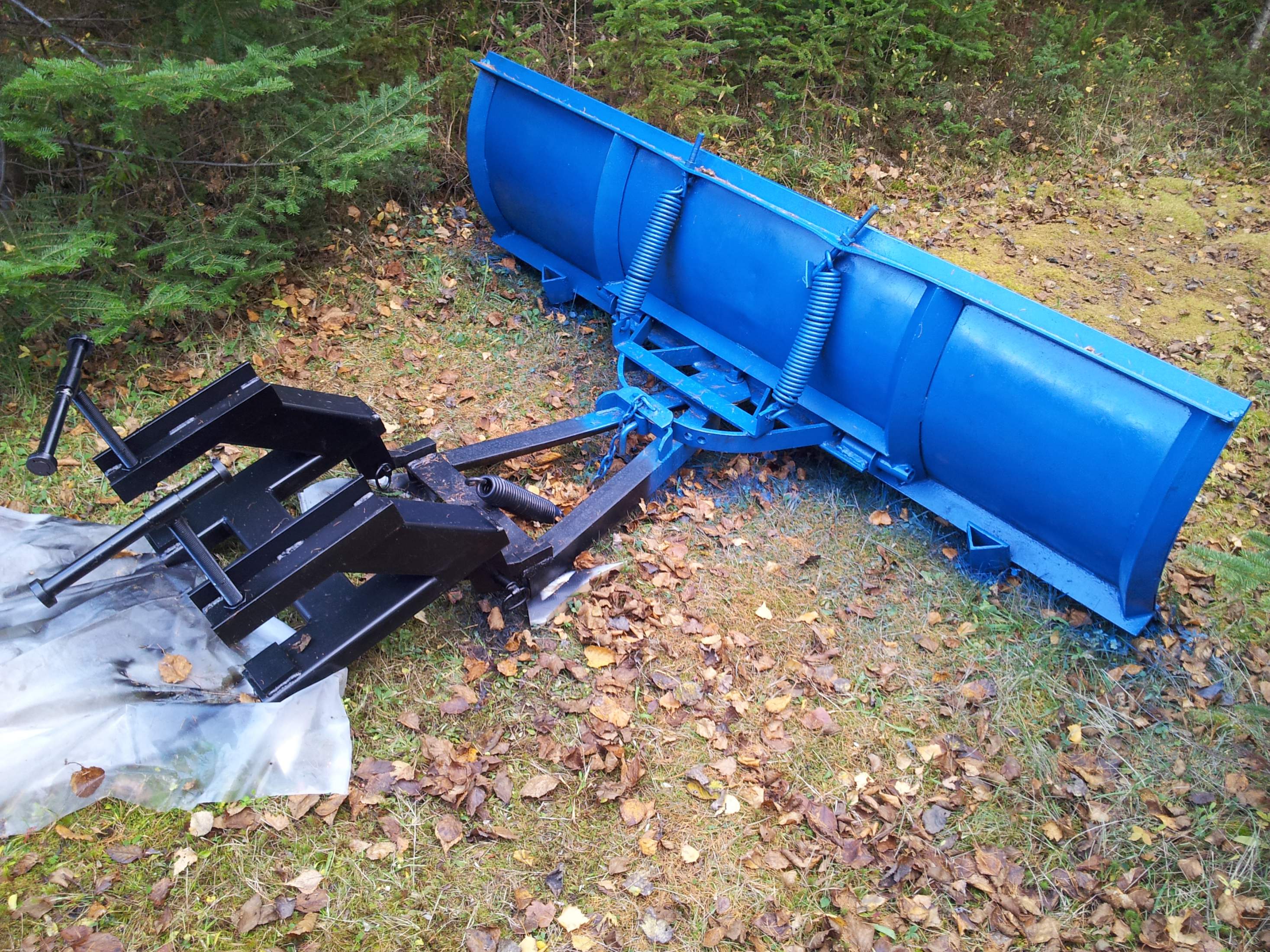

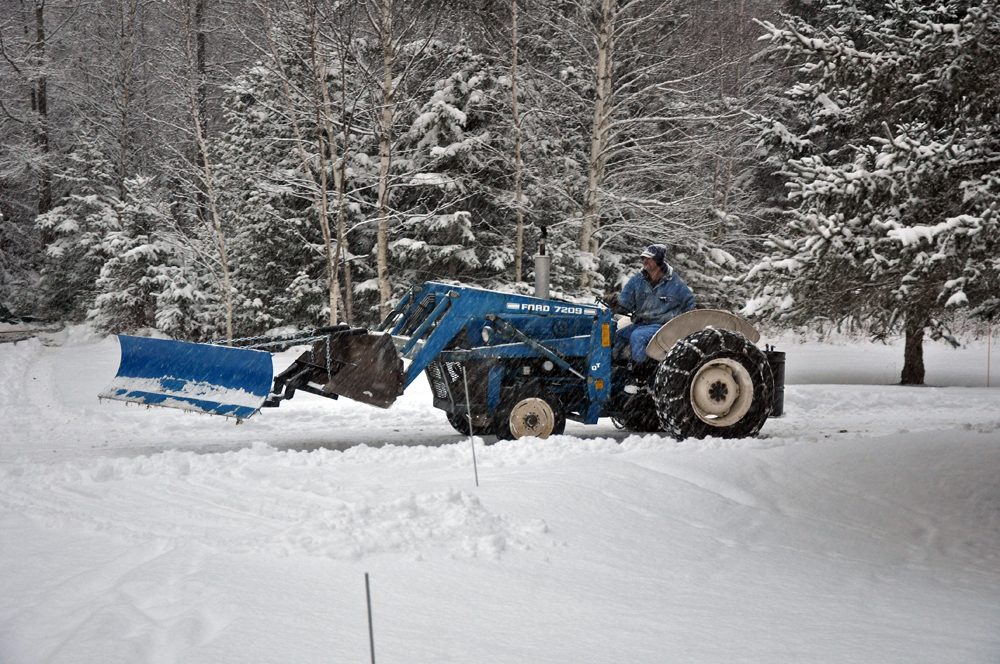

Hi,
After a few heavy uses, now my snow plow blade that is clamped to my FEL is angled up, and riding on its angle iron triangle, so it misses a few inches of snow. I've tried adjusting the angle of the bucket it is clamped to, but it still seems to skip over a few inches of snow. Any ideas would be most appreciated.
Thanks Much,
   / Plow blade angled up and skipping over snow #2
Curl-out your bucket some to change the angle-of-attack. That would bring the cutting-edge in, closer to the tractor, put your FEL in float & go to town!
