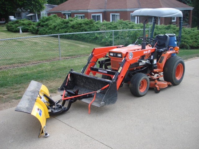

I just sold my ATV and used to use it to clear my 200'+ driveway, so I needed to come up with something....I looked at a snow pusher to go on my loader, but $1800 was a little steep. So I fabbed some mods onto my old ATV mount and plow. Here is the result.
   / Plow for my B5200 #2
I like what I see . My only consern is the distence from the plow to your front tires [side draft] see how it works if it pouls to mutch put weight in the bucket if still not rouning true I would mount it on the frame and yous the mower lift linke to do the rasing and lowering the loader would not need to come off This is how I see it I hope I am out to lunch
