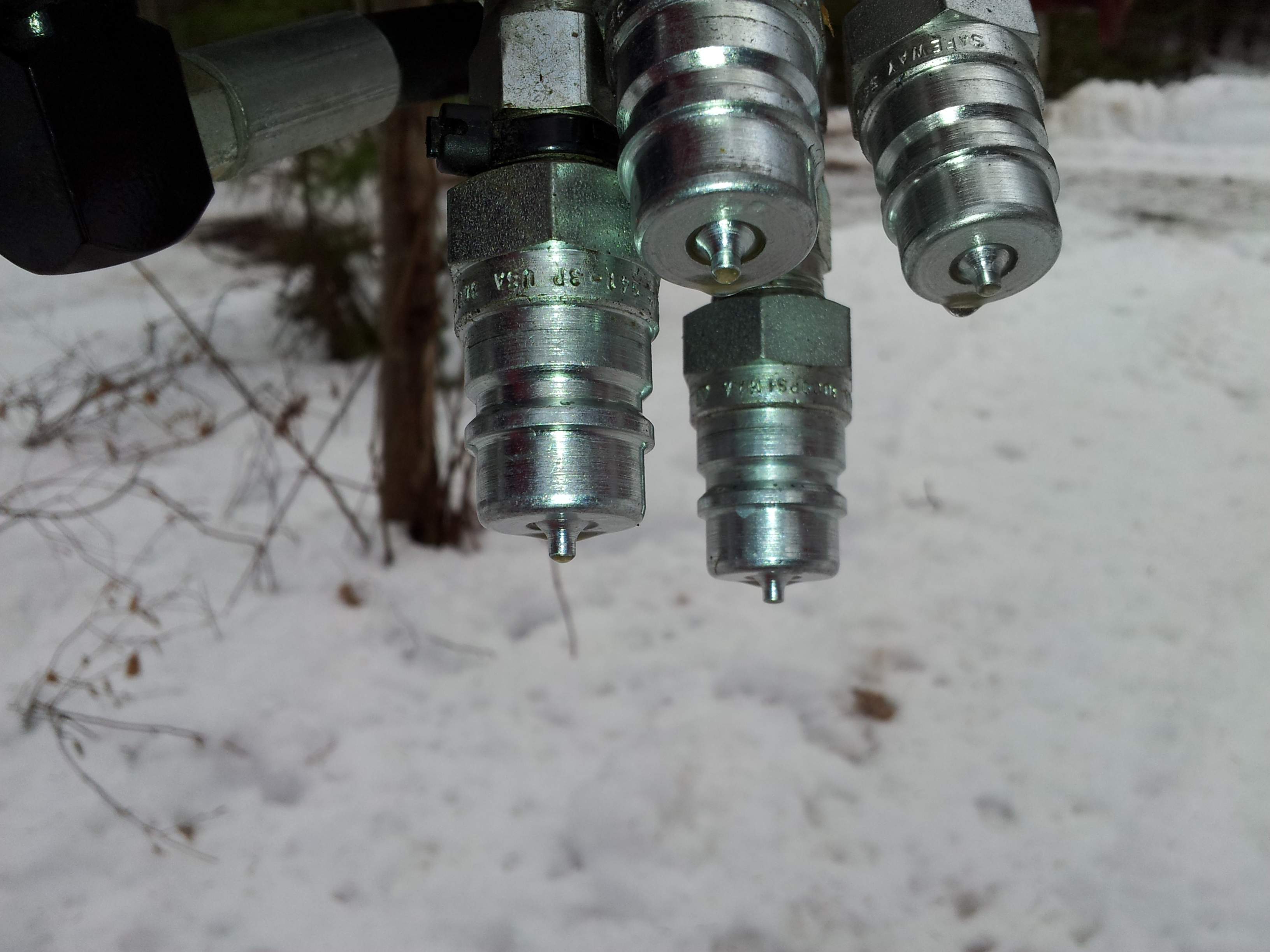

I'll take some pictures tomorrow of the hydraulic quick connects and post them, just maybe one is wrong or a different style/ type.

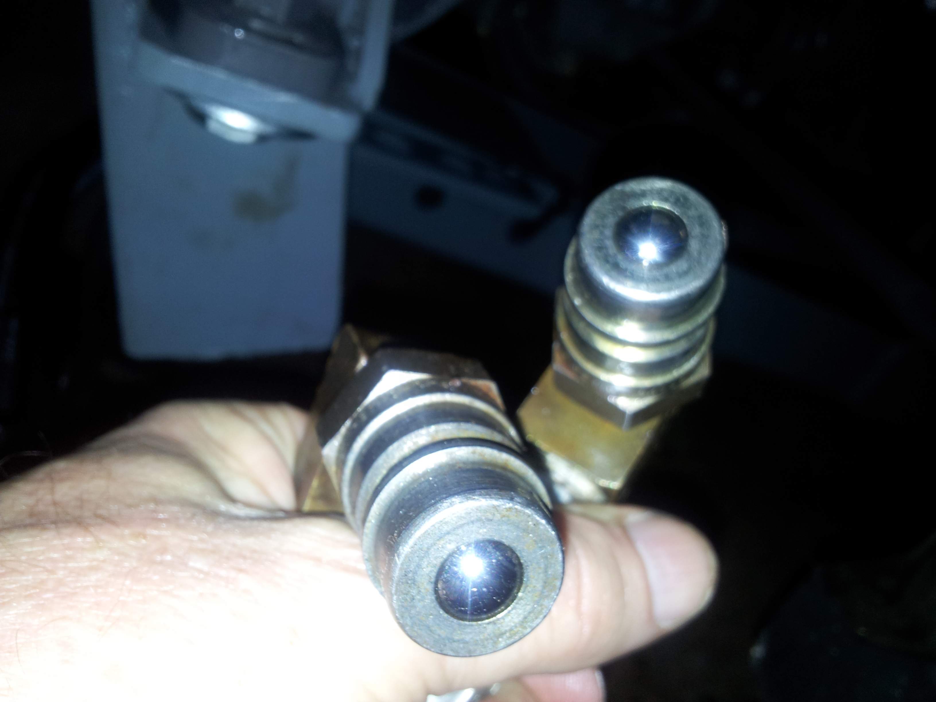

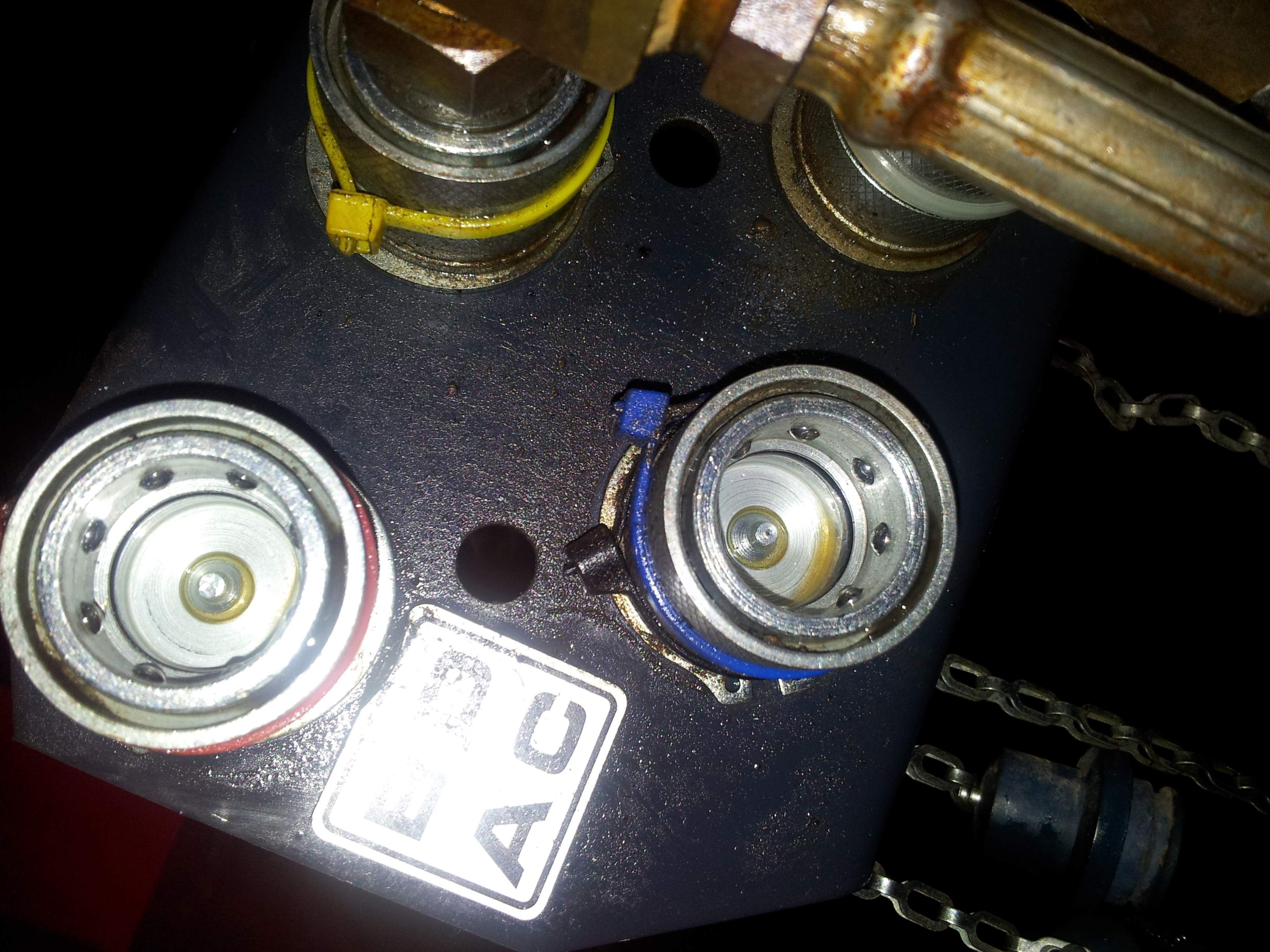

I attached the pictures of my couplers on the tractor,FEL and plow. The plow couplers were different from the MF front loader. Do you think this caused the lock up when raising the plow fast or even angling the blade too fast causes lock up it too. I guess the plow's coupler check ball get forced by the higher hydraulic oil flow to shut off the returning fluid?

Yes, some times you can interchange ball and poppet style QD's and some times you can't. If you haven't changed them already a simple test is to idle the tractor down and operate the functions with less flow / speed. If they work at lower flows and fail and higher flows then one of the QD's is closing at higher flow rates.
Had this same problem when using Ford 5000 Vs 5600. Factory QD's on the 5000 where ball style and on the 5600 where poppet style. Some times they would work and some times they wouldn't.
Roy
   / plow hydraulics locks up
Roy
You are correct, it would move slowly alright, but if I rev. The engine it would lock up. I purchased new male couplers, it did solved the problem. It was strange because it worked fine with my smaller mf1532, but as you said less flow it didn't locked up, good one to remember.

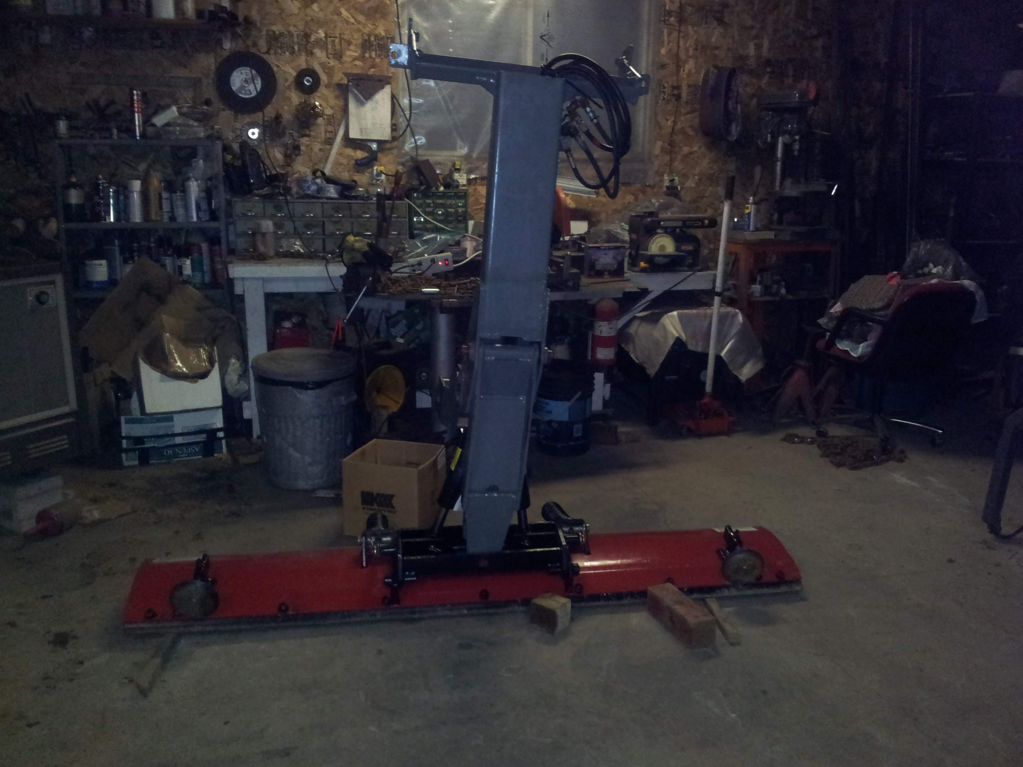

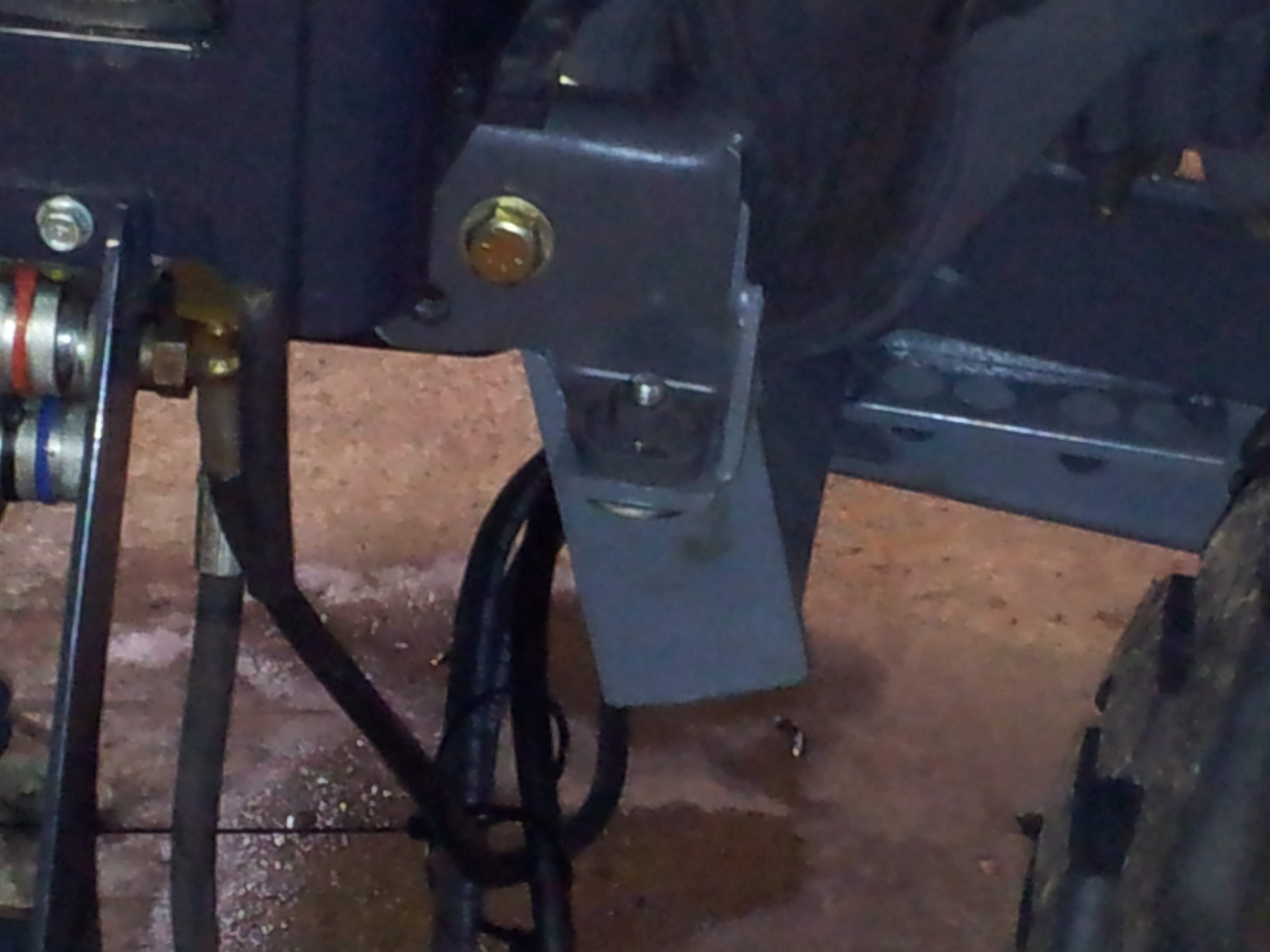

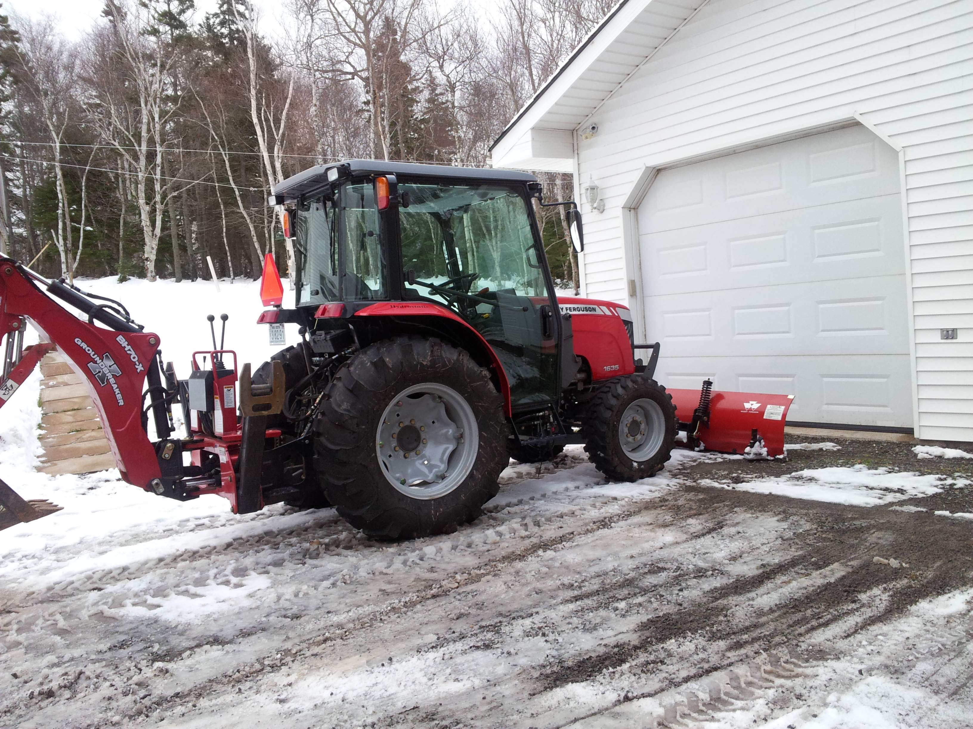

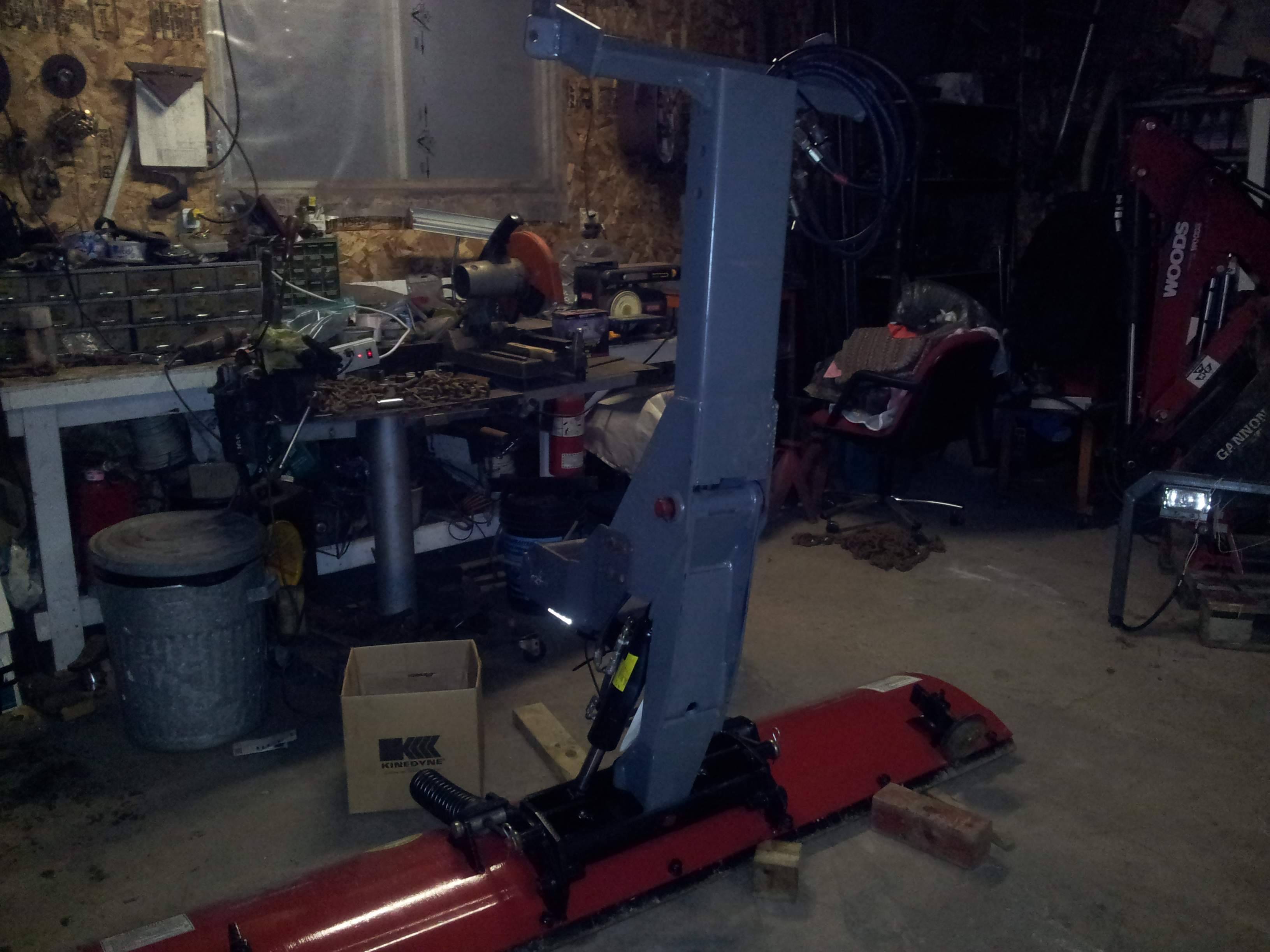

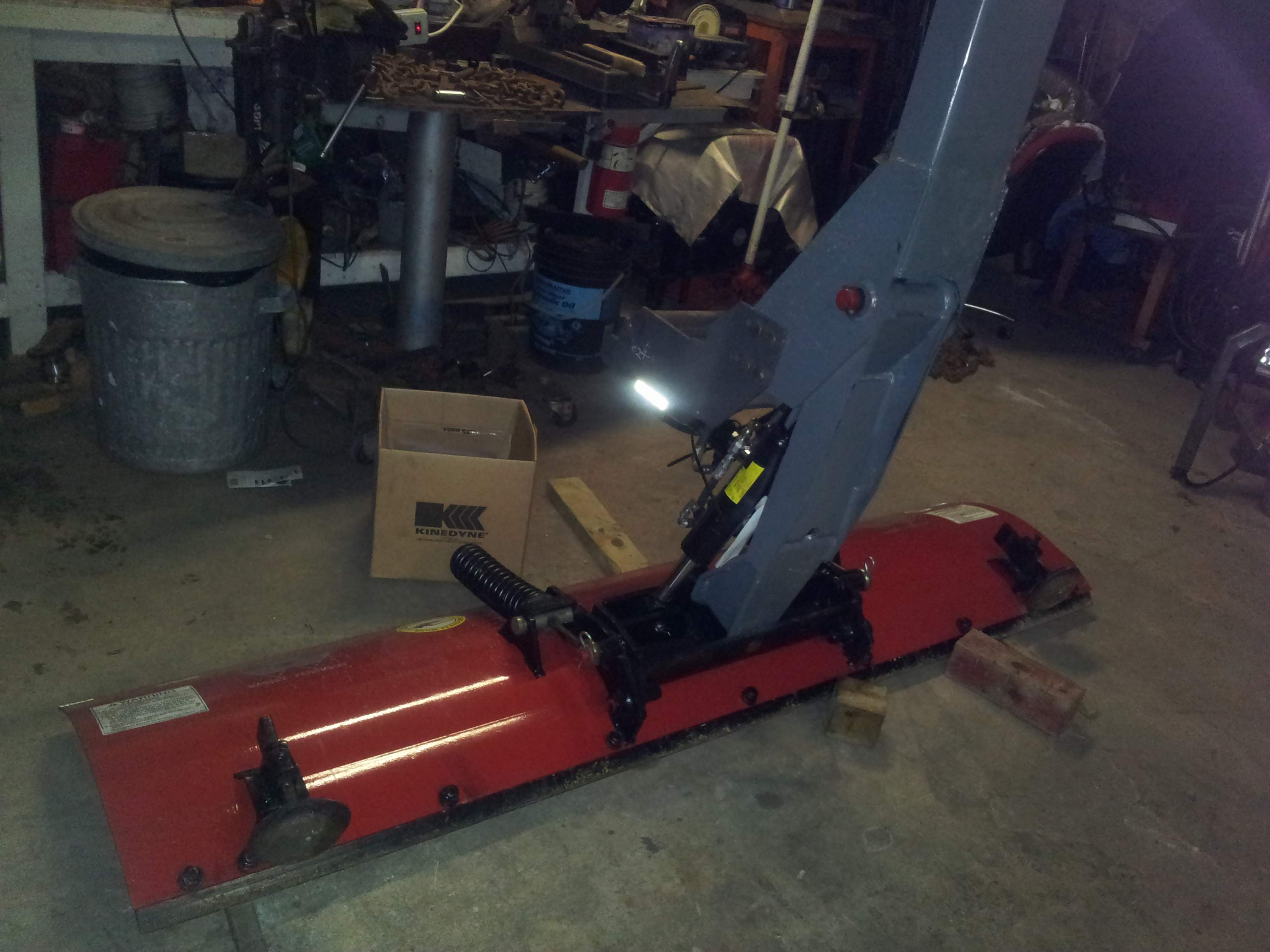

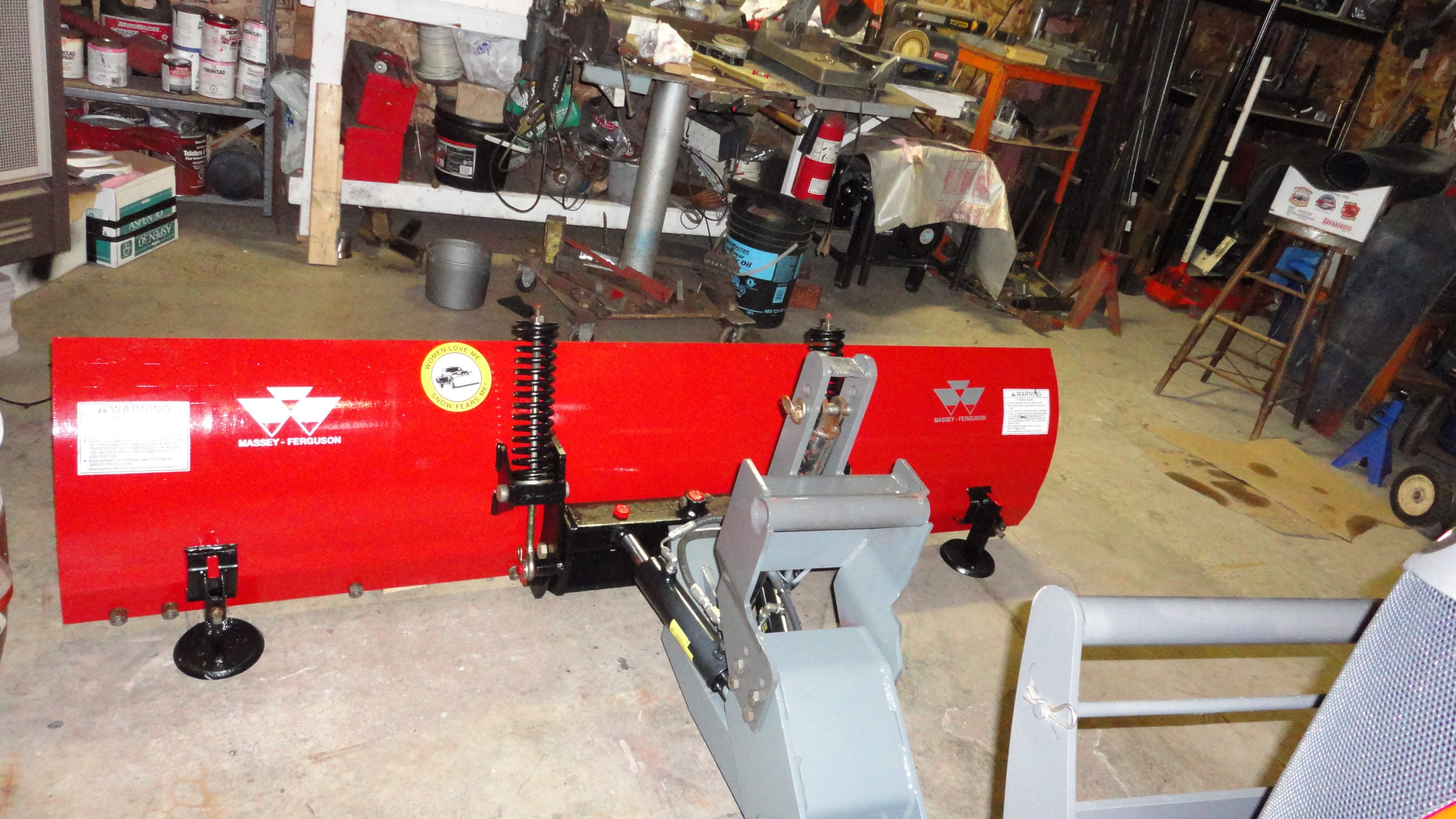

Some pictures of my frame parked in garage out of the way. 4 bolts connect it to the tractor frame just under the Cab. It uses all the hydraulic connections that the bucket uses. I had chains on my front tires of my 1532 and they worked great, so I ordered a set of ice cleats for the mf1635 front tires. THe cleats really make a big difference when plowing especially when using the angle. I only has a box scraper on the back for weight to keep some weight on the front tires. I just purchased a tire grover to grove the rear tires as well.
