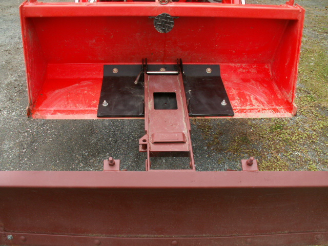

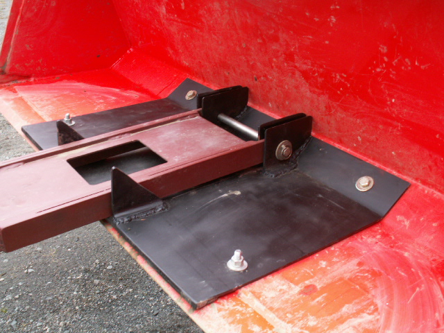

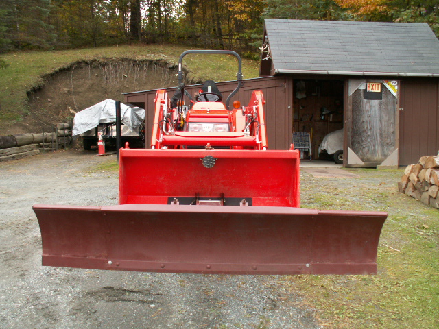

I also have L2800,didn't want to keep swaping bucket to snowplow each storm..pull one pin frees plow,manuel angel tho.

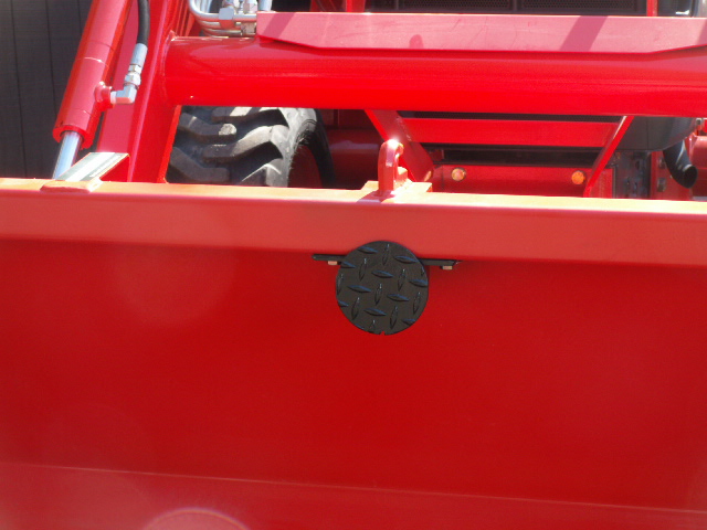

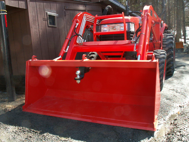

Ok, ill bite, whats the round black metal tab top center in the bucket?
   / plow mount #4
For trailer ball.
Thomas that's a nice quick setup!- Do you leave the mounting plate bolted to the bucket all the time ?
I also like how you have the hitch.:)
Thanks!
   / plow mount #6
Low Bucket
"Do you leave the mounting plate bolted to the bucket all the time ?"
Yes,I do leave mounting plate attach only during winter months.
1/4" plate..pitch towards back of bucket,on back side 3/8"x 4" flat stock for strenght.
Thanks for the words. :)
   / plow mount #7
Thanks Thomas!

That's a cool set up! I am trying to figure out how you would angle the blade if needed? Is that what the hole is for? To slip over the centering post one way or another?
