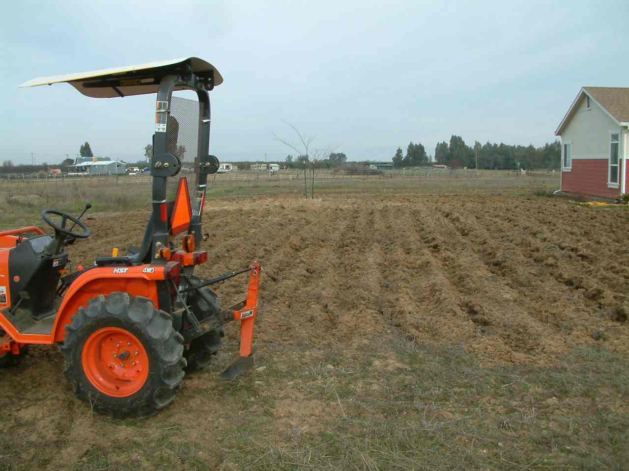

Use a middle buster. I have a 21-hp Kubota B7510HST and have just plowed about a 1/3-acre of ground around that house that will be landscaped in March with tall fescue. I'll use my 4-ft wide Yanmar RS-1200 rototiller in a few weeks to bust up the clods. Then I use a chain-link fence drag to smooth the surface prior to fertilizing and seeding.
You probably could plow your 1-acre with a middle buster in 10 hours or so.
