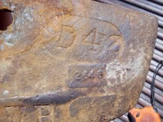

Hello all! Newbie here seeking your advise.
I purchased a 2 furrow Dearborn plow which is in of shares. I contacted our local suppliers but have come up with little success. I have been searching on the net but the numbers on my share don't seem to be matching up to anything I have found. This is all new to me so any advise is greatly appreciated.

If that plow does not have a shin on the front leading edge of the moldboard, Points are going to be next very expensive, if you can find them at all.(2 piece setup) The 3 piece setup, consisting of point,shin,moldboard, We can probably help with parts. Ken Sweet

Thanks for the quick response Ken. I got a friend to run out to the plow and it seems to fit the description you made about the 3 piece set up. He mentioned that there was a place for the share (which I have with me) a piece that runs along the bottom and the moldboard and that everything bolts together. If this helps, the number off the plow itself is 1015 L7 (or 17- it's hard to read) and there is a "DMC" logo in a diamond shaped emblem.

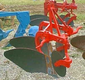

Here is a plow picture that shows what a modern setup with wear "shin" looks like--That is the rusty pieces(2-3 inches wide 7-8 inches tall) they run vertical on this plow in front of the moldboard. The points are buried in the gravel (sorry)--If you don't have the shins, it is a 2 piece deal? Ken Sweet

Uh-o......I may be out of luck. I'll double check but I'm sure it doesn't have the shins. I'll be in touch Ken if I'm wrong. Thanks again!
