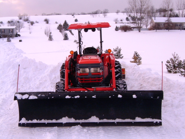

Hello, I recently purchased a ck35 and I am now looking to put a plow on it. Just curious what size snow plows people have ran on this size tractor. It will be used commercially. Any recommendations on brands to go with or stay away from?

Snow or soil?
   / Plow size for ck35 #3
A 7', maybe 8' snow plow should work fine.
I run a converted 9' truck plow on my DK 35.
With chains on all 4 it does quite well at moving some snow.
   / Plow size for ck35 #5
I have a ck35 and used to have a 7 foot W.R. Long snow plow on it. You definitely don't wanna go smaller than 7 feet especially for when the plow is angled. FYI
