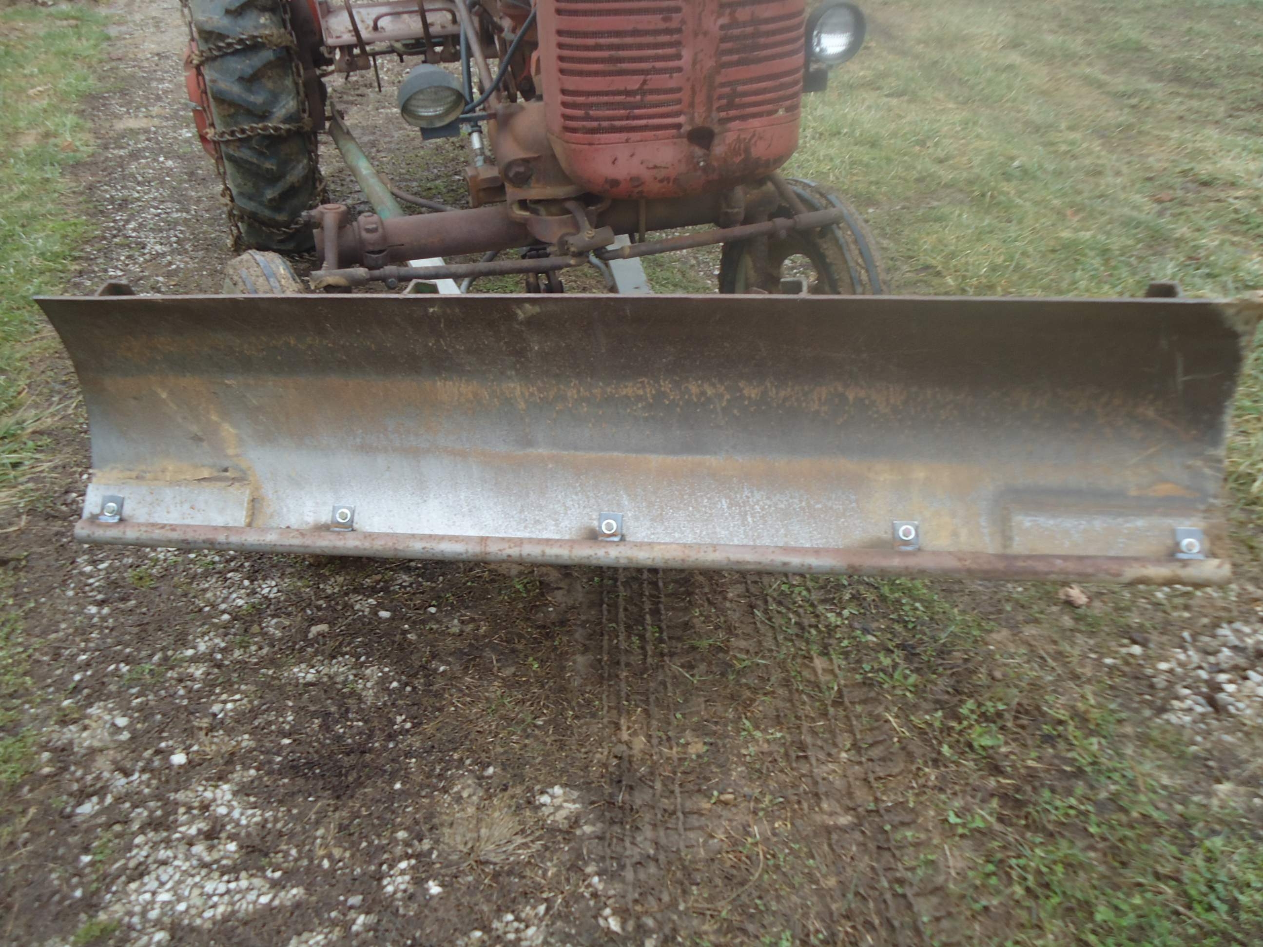

I use 1” schedule 80 PVC on the plow on my Farmall Cub. I just finished plowing a 4” snowfall with it today in fact. I plow our big gravel driveway around the barn, our small blacktop driveway by the house, and my aunts big blacktop driveway next door, by her house and barn.
I’ve done (4) 6” snowfalls earlier this winter, and the PVC wore thru after I finished our stone driveway today. I find that I really only need it when the ground is not well frozen. It was froze up real good now and there are no warm temperatures in the long range forecast so I should be good without it for a while.
I had hundreds of feet of 1” PVC in a pile out back but I gave most of it to a buddy to use as conduit for wiring his barn. I think I got enough left over to last a few more years.
To make the plow edge cover, I just cut thru one side of the pipe with my table saw, and drive it onto the blade edge with a hammer. It takes less than 5 minutes to replace.
The pipe really does a good job of keeping the driveway stones off of the lawn. Prior to using that, it would take me days to take all of the stones off of the yard every spring. Now I don’t even need to do that.
I also use that Cub plow for pushing up leaf piles in the late fall. The pipe needs to be removed for that job.

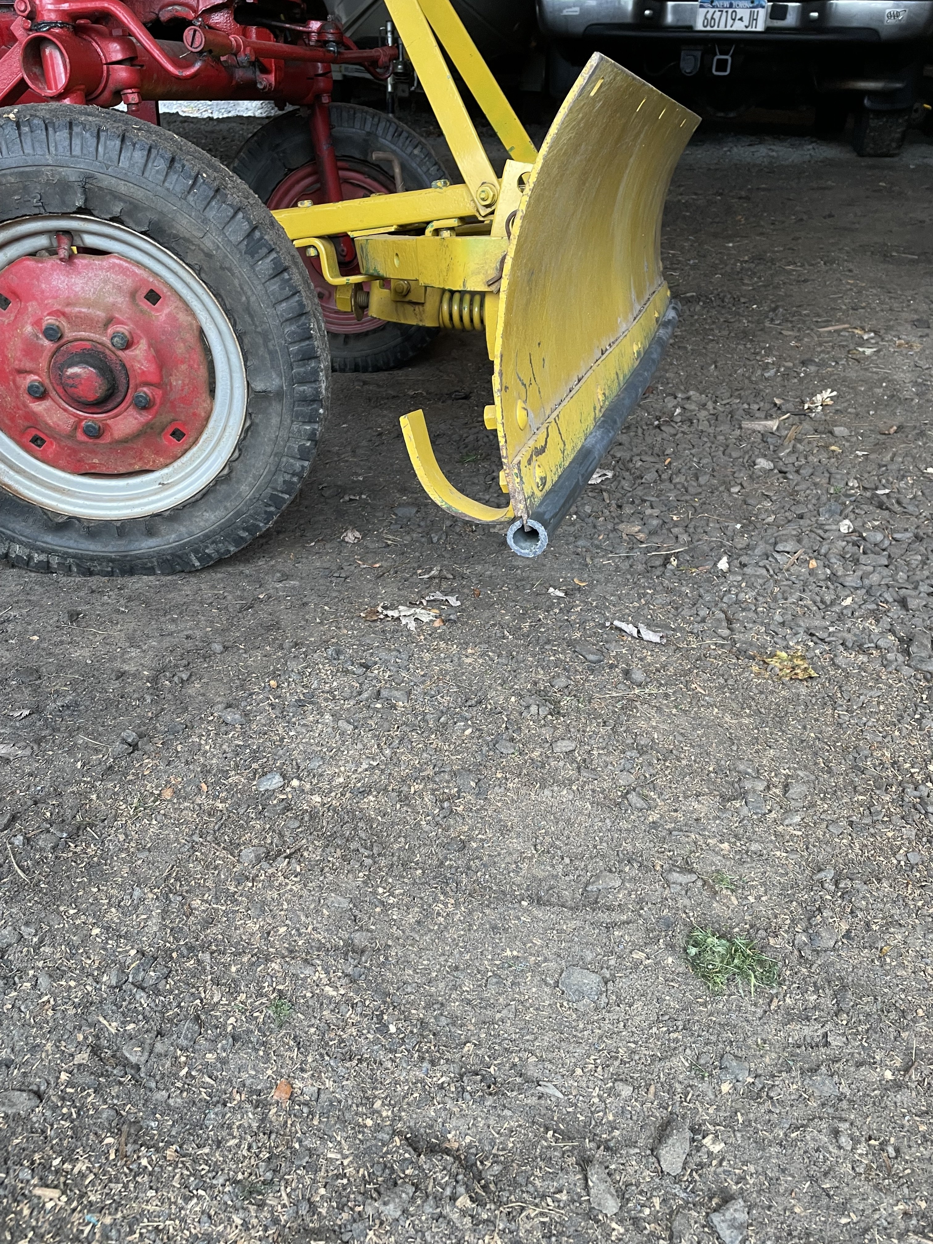

Being it's on the loader you're going to have to be on the loader control all the time, whether go to float for a second then catch it to hold, or just pressure down or up to match the terrain. It'd be much like operating a dozer, you have to "feel" what your machine and blade are doing, it's not just ride & guide.
My foreman told me years ago, a good dozer operator's brains has to be in his a$$, because you have to feel what that machine is doing.
I put a pipe on my old Farmall A probably 20 years ago, does wonders to keep it from gouging in. The lift cylinder is a rigid mount, so on uneven areas of my drive I'm on the hydraulic control all the time. But after 20 years of operating a dozer it's just second nature to me.
