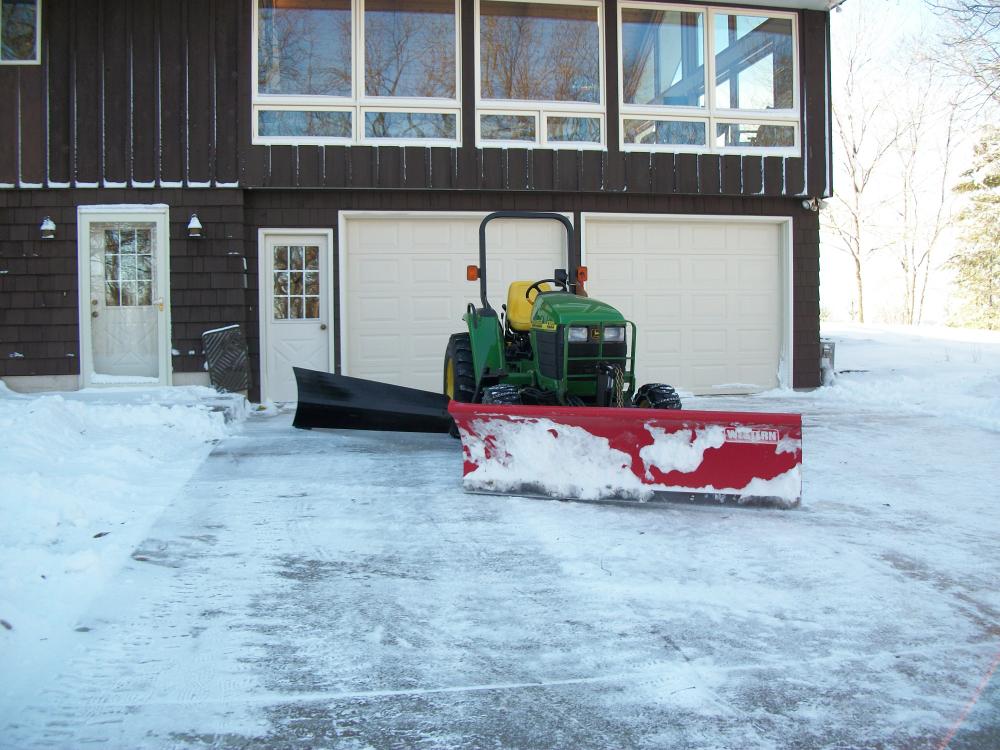

I can't get my plow close to a 45 degree angle. About 30 deg max I think, but don't know that I've measured it. What brand plow??
I move everything over to the "downwind" side to minimize drifting (not piling any snow on the windward side). So first pass is far left with about a 10 deg angle, come back up moving that over with full angle, and then a pass back down to finish. Then put on the wing and knock the berm over leaving a shelf of about 4-5'.

I can't get my plow close to a 45 degree angle. About 30 deg max. What brand plow will go 45 deg??
I move everything "downwind" side to minimize drifting (not piling any snow on the windward side). So first pass is far left with about a 10 deg angle, come back up moving that over with full angle, and then a pass back down to finish. Then put on the wing and knock the berm over leaving a shelf of about 4-5'.
My guess is they are talking rear grader blades because I am with you, running a truck plow on my FEL, and it will only go 30 deg or so.
I run down the center of my 25' wide by 280' long drive with the plow angled off the the right. I make a pass up and down then come back and clean up the edges. For my parking area, about 80'x40' I just drop the back blade down strait and pull it away from the barn then push it off into the grass with the snow plow pretty much strait.

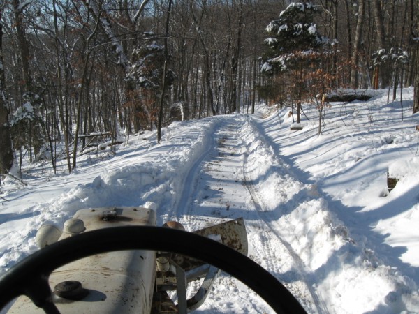

I have a 1400' long 12' wide gravel drive, with a long section cut into the hillside. In the past, I've used by Cub with a 54" plow and made a run down the inside of the drive and then returned to the top and plowed downhill again to the outside.
I now have an FEL mounted 7.5' snowplow and am considering trying the first pass downhill to the outside, so I pile less snow in the inside ditch. I've never used a bigger plow and I know speed is important. But I don't have the guts to go very fast on the outside edge.
It is snowing now and I'll do some experimenting this afternoon.
