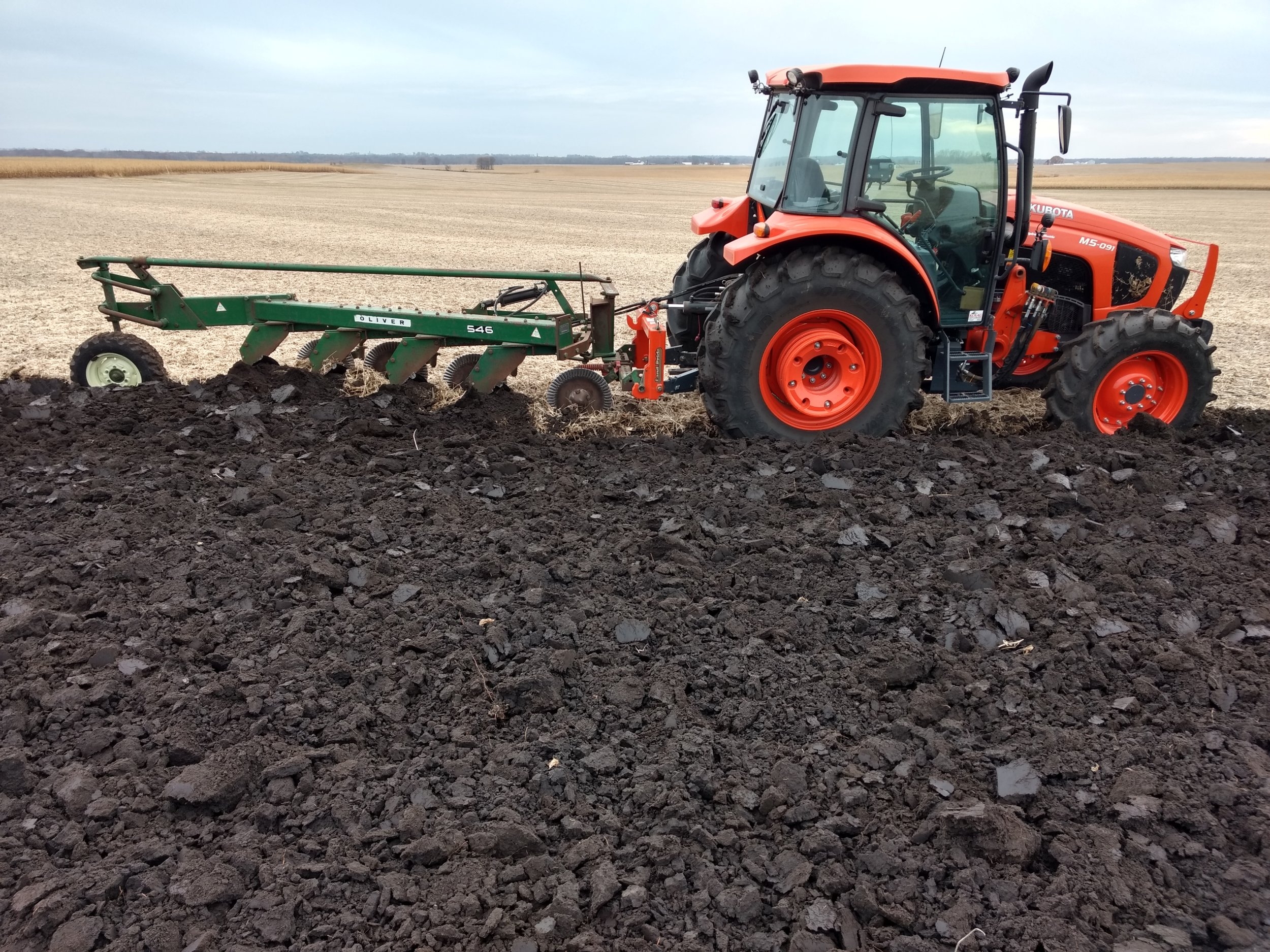

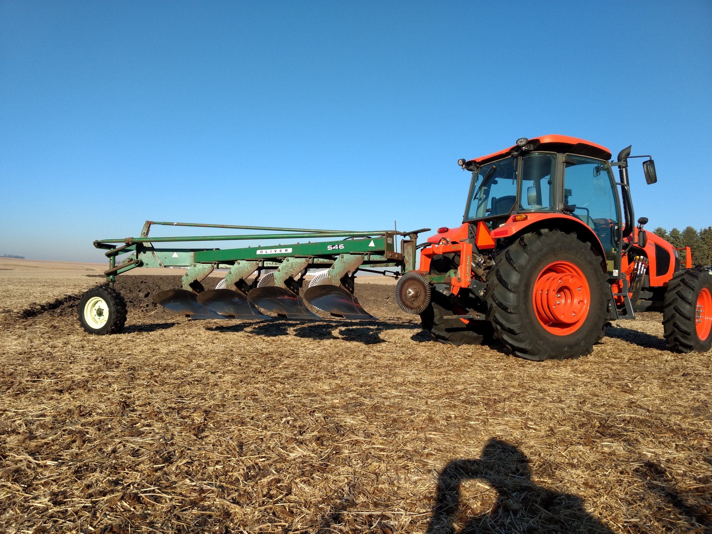

A little recreational plowing with my M5_091 and an Oliver 546 4-16" plow. It walks the dog through good Iowa soil, where there is compaction it will make her snort a little.

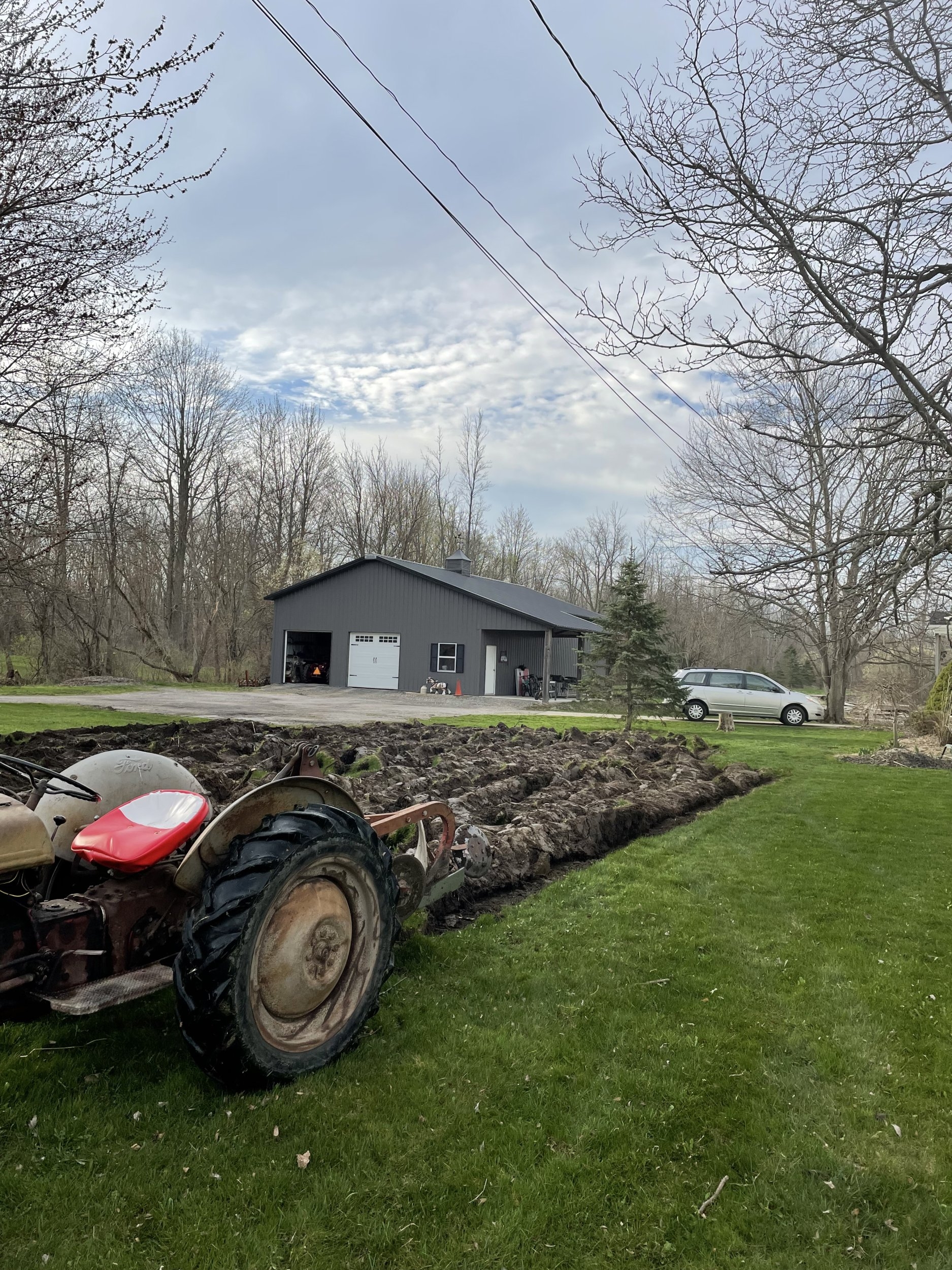

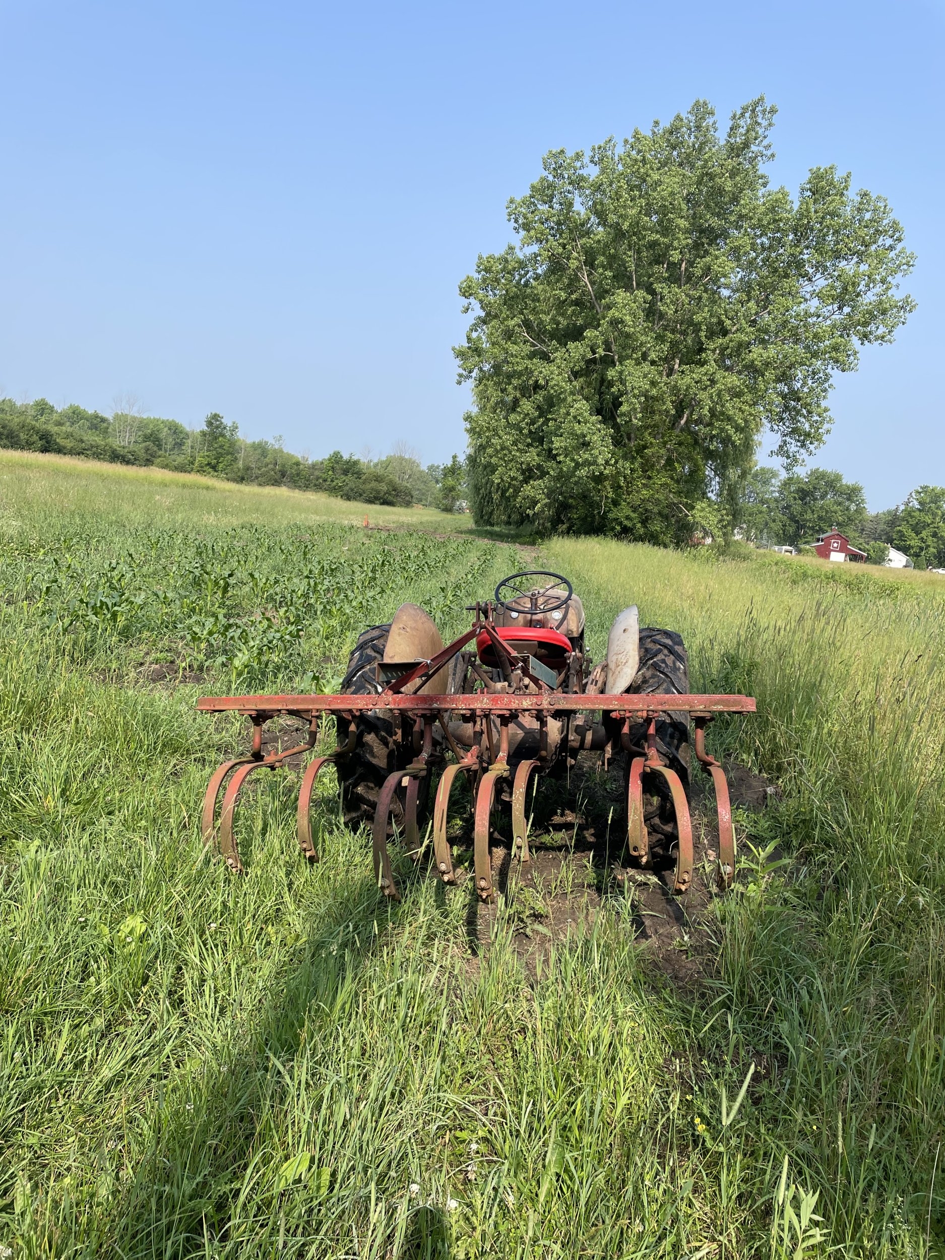

If you want to get an old tractor for plowing, I would recommend a Ford 8n. I use a use a 1951 on a 2x12 plow and it does a wonderful job with that.
I am the second owner and it has just under 2000 hours on it now (it had 1200 on it when I bought it). It still has the original tires and paint and has always been stored inside.
It always plowed good, with loaded rear R1 tires, but one of the original rims (furrow side) rusted thru (3) years ago. I was worried that it wouldn’t plow as good with just one loaded rear.
Much to my surprise, it actually plows better now, doing more acres per hour and using less fuel. Traction is better on the furrow side, so not having the extra weight on that side, evens up the pull force on the plow.
While it plows better now, the same can’t be said about pulling my two row cultivator. Now it pulls to one side with that, so I moved that job to my newer tractor, that has both loaded rears.
