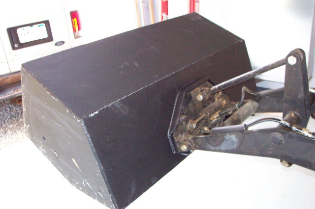

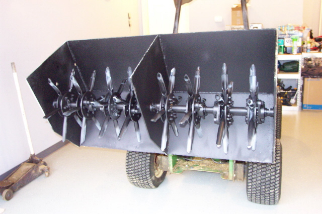

Built a core aerator for my PT425. I have not tried the unit yet and I'm hoping it pulls plugs properly.

   / Plugger #2
Wow, nice job. That looks like a helluva aerator Clarke. I cant wait to see pics of the results!
Its got a real 'mad max' look about it, I like it!!
Please bring yer camera with you the day you go to test it out.
   / Plugger #3
OK, details. Where did you get the tines? What about the rest of the parts?
   / Plugger #4
sg
Very nice indeed lets see some action shots.;)
   / Plugger
Scott,
I purchased the spoons from Agri Supply AERATOR CORE SPOON 3.5MM - Agri Supply
The 1" shaft came from Speedy Metals
The Flange bearings from an Ebay bearing supplier.
Most of the metal was scrape I found around the local area. I had to purchase 2 pieces that they sheared to fit. The unit is constructed with 3/8" and 1/4" high carbon plate steel in the PT tradition. The cost was just shy of $375.00.

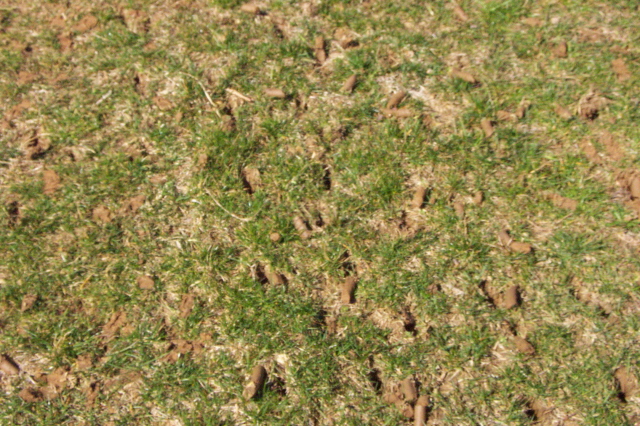

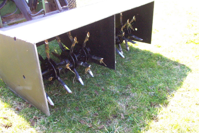

Pictures of plugger in action
sg
   / Plugger #8
Looks great! Can't tell, are you pulling it or pushing it?
