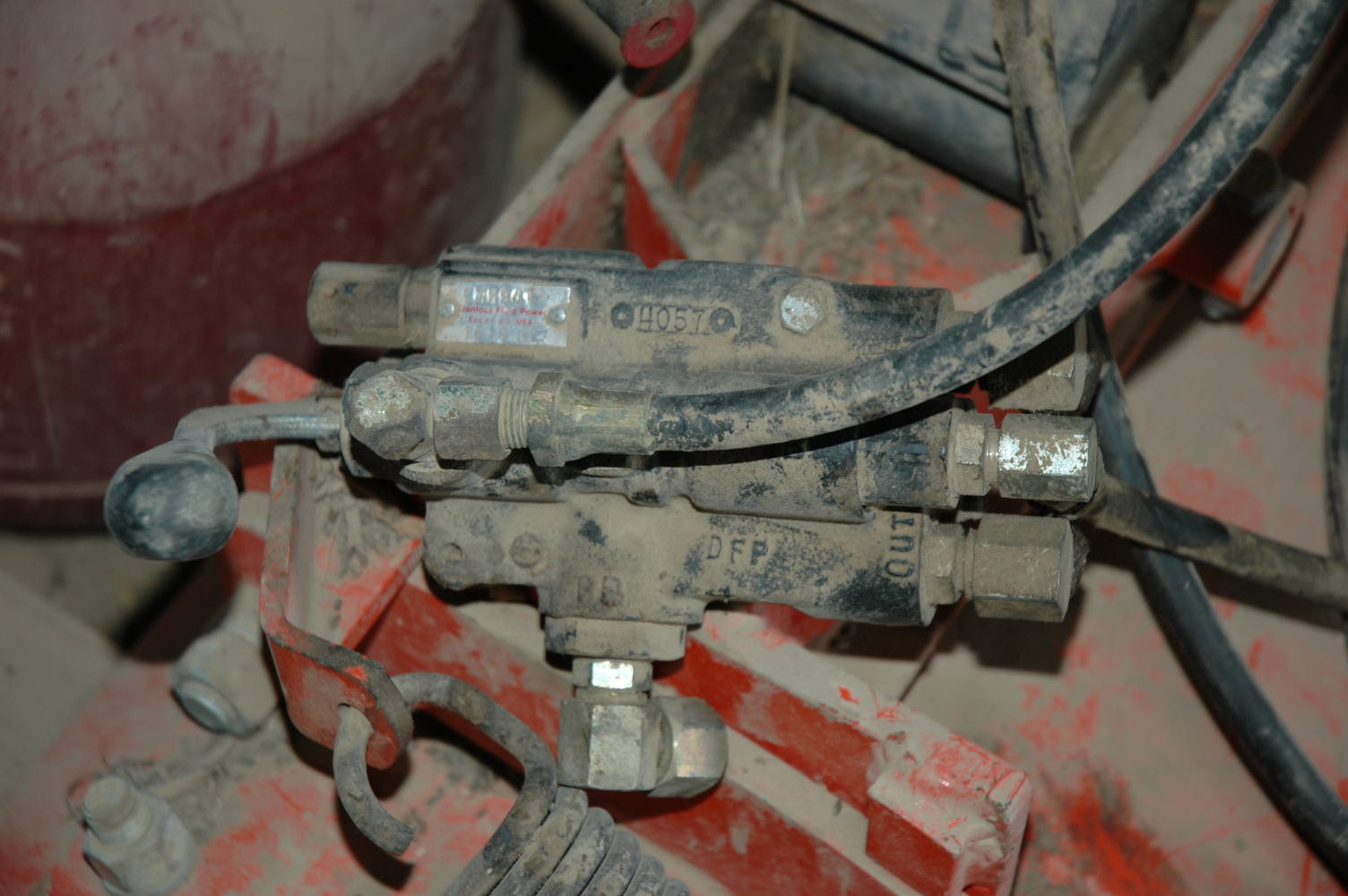

Does anyone have any ideas on whether or not it is wise to plumb another valve to a FEL valve?
I'm planning on attaching a snow blade to my FEL. I need another valve to angle the blade. I was thinking the easiest thing to do would be just to add another valve downstream via the FEL power beyond port. Is this wise?
I currently have a B2400HSD with the LA352 FEL. The FEL valve is a Hasco International 9210-B2C.
Can anyone tell me how to determine if a valve is open circuit or closed circuit? When I bought the blade it came with a Danfloss Fluid Power 1618AL valve. I could not find any info on their web site. I'm trying to figure out if I can use it with my B2400.
Thanks for any input. Tom

You have an open center system. You can easily add another valve downstream from the FEL valve. I have posted dozens of time on how to make the connections. It's no different that adding an aux valve for rear remotes.
Since you flow is less than 5 gpm, your best bet for a valve would be one of the Eaton-Cessna valves with power beyond that you can get from Surplus Center. However, you should be able to determine what you got with that Danfoss valve by simply looking at it. In the past I have found Danfoss info on the web. A few pics might help detemining what you got if you can't find any documentation online.
Take a look HERE. I found this in about 1 minute. The website is under sauer-danfoss. Your valve is there on page 27. You will need the PB sleeve for it to work correctly but it will work without it, you just will not be able to use the 3pt simultaneously.

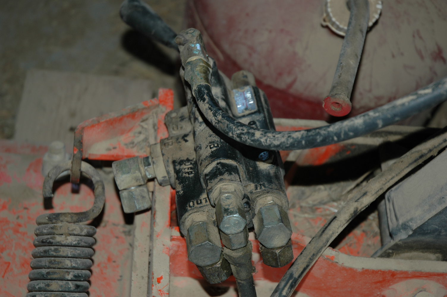

Here's some pictures of the Danfoss 1618AL valve.

Let's see if I got it right from the pictures. You have 5 hose connections. 2 go to the cylinder, one is the power beyond, one is the outlet to the tank, and one is the inlet from the pump or another PB source. If that's the case you are all set to go.
Also If I am reading the manual correctly, that valve has a float detent in one direction and a detent in the other direction too. You should verify that.
