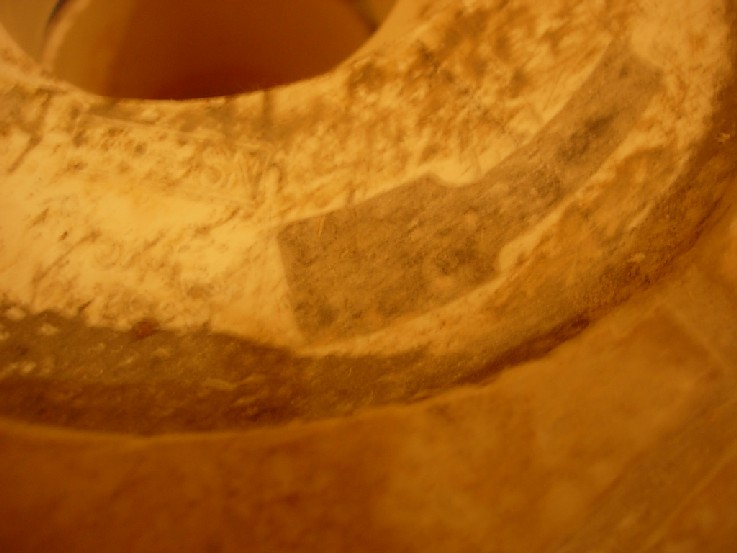

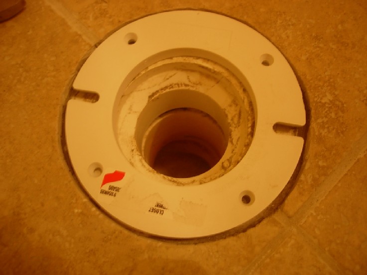

Situation: Just tiled floor in bathroom. Prior to tile, floor was simple concrete that we waited until now to get around finishing.
When the floor was first poured they made it flush with the toilet flange. Now that we’ve added tile the flange is roughly ¼” to maybe 3/8” of an inch below the floor.
In addition to that, the tabs used to insert the bolts are WAY off from being square to the wall. From the view of the picture #1, I’m facing the wall fairly square and the bolt holders should be at about 3:00 and 9:00. As you can see… their battery stopped!

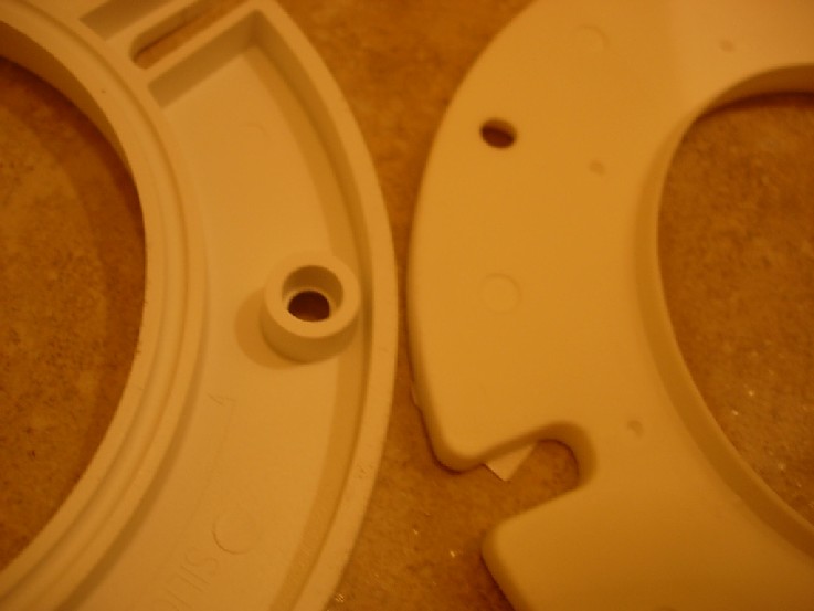

Pics 2 & 3 also show how the holes are filled with concrete.

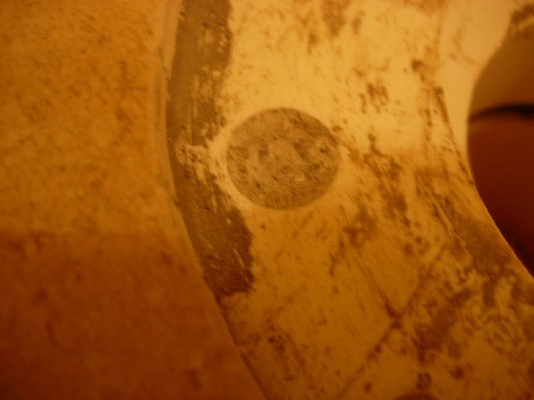

I was told I need to get an extender and that’s fine. It’s shown in pic 4. I was specifically told I’d need to get TWO extenders so the flange is raised above the floor and able to set into the toilet. Though that’s fine & dandy when I put ONE of them on the floor, part of it (maybe ½ of it is essentially flush with the floor and the other 1/2 of it is slightly ABOVE the plane of the floor tile. Meaning in part, perhaps the flange isn’t perfectly level, the floor isn’t perfectly level or some combo of both.

Ok…my question is basically what is the best way to mount these extenders?
I was thinking of putting 4 holes & concrete screws in the BASE unit, silicone an extender on top of it and drill through IT’S 4 holes (through it’s 4 holes but creating 4 MORE holes in the one underneath, not using the first flanges existing holes since they'd already have screws in them) so I could screw it down also, but on a rotated angle from the first. Meaning, I COULD line the screw holes up but since the bolt receivers are NOT square to the walls I have to rotate it SOMEWHERE to align the toilet.
I would then rotate the second extender (and silicone it) so the receiver holes are square to the wall and drill through IT’S four holes so in total I’d have 16 concrete screws going around this thing… 4 on each ‘level’ with each level rotated a bit from the prior level.
