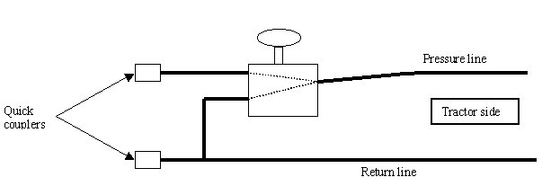

I'm having a slight plumbing problem with my NH TC29D ....
The trouble is with the hydraulic hoses that were added by the dealer to power a Woods 7500 backhoe. When the backhoe is removed, the two hoses on the tractor get hooked together to complete the circuit. Problem is - these hoses make a nice loop that interferes with the three point hitch.
Anyone got a "Best practice" recommendation or general thoughts on the subject?
Woods tech support suggested the aux tank and three point pump for the hoe which eliminates these hoses. I don't suppose that will cost anything ....
Thanks for any thoughts on the subject
Brad in NH

Brad,
I had a problem with my PB lines for my backhoe.also. The way that I handled it was to put a directional control valve on the hose ends and then a short piece of hose with quick connects on them. By using the valve, you can do away with the hose loop. The oil is looped internally in the valve. The valve is Energy Manufacturing item. The part number is B-1174, I think. Check it out at http://www.energymfg.com in the Directional Control Valves and Accessories section on page #5. If you have any questions feel free to ask.

Hi JerryG,
I looked at the control valve on the web site you posted, but I'm sure I don't understand the hookup. I've got two hoses coming from the hoe and two from the tractor, but I think the valve has three ports. I'm confused, however a control valve solution sounds like it would be very "clean". Any further explanation would be much appreciated.
TIA
Brad in NH
   / Plumbing Problem #8
Brad,
Here is a diagram of how the valve is set up. I have mine setup so that when the knob is down the flow is a loop, when the knob is up the flow goes to the quick disconnect.

#9
Thanks for your thoughts - the NH dealer and I decided the solution was a remote valve kit. The dealer picked up the tractor on Thursday and had it back in the yard when I returned from a trip on Saturday about noon time. The installation is clean with no extra hose hanging around to get damaged and everything seems to work fine.
