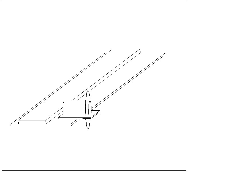

I'm not trying to reinvent the wheel here, but I'm looking for a cheap, portable, small jig to rip plywood. My table saw is a little under powered for this. Currently, I have to rip a small strip off of the plywood, then use the factory edge to cut the rest of my pieces. I could just keep the small strip for other sheets, but its a pain to store, and eventually it warps. I could make a jig that would be more substantial, but again, a pain to store. I just tried a cheapie 2 piece aluminum straight edge, but the joint was too flimsy, and my cut curved in where the joint flexed. I'm looking for a sturdy, collapsible jig to rip 8' plywood sheets. Any suggestions?

For a cheap solution that really makes not only cutting but lining up your cut a cinch, get two pieces of plywood. Glue & Screw one on top of the other. The top one must be straight on at least one side (both is preferable). Attached is a drawing that should reduce confusions some...
Cut the bottom oversize (for me that would be greater than 1.5 inches for one side of my saw, and greater than 5 inches for the other), and using the top guide, trim the bottom. Now the bottom will show you exactly where your blade will be...no offset measuring /forums/images/graemlins/laugh.gif
The reason you should set up both sides of the guide for the different sides of your saw is for clamping/cutting ease when getting close to the edge...you can reverse your "normal" cutting direction. Afterthought: I'm not saying to cut backwards! Really what I meant to say was that this allows you to cut the same direction (for righties, from right to left) with the clamp on either side of the saw. Sorry about any confusion!
I know this still might be confusing, so let me know if it is and I'll try again....
Sam
