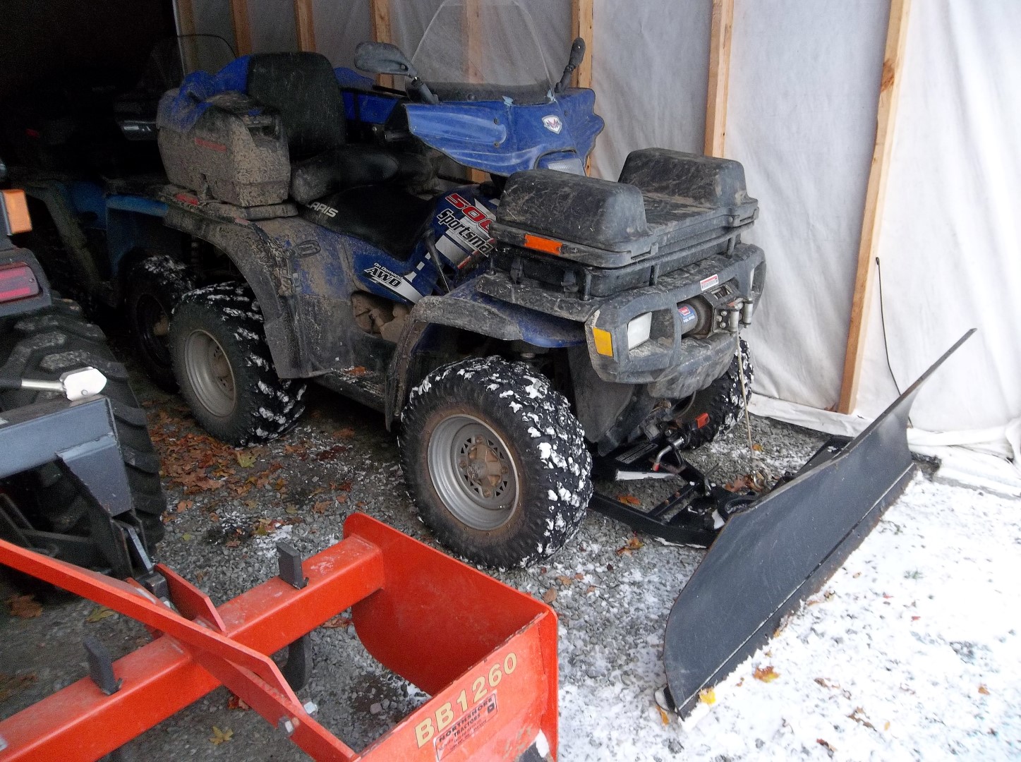

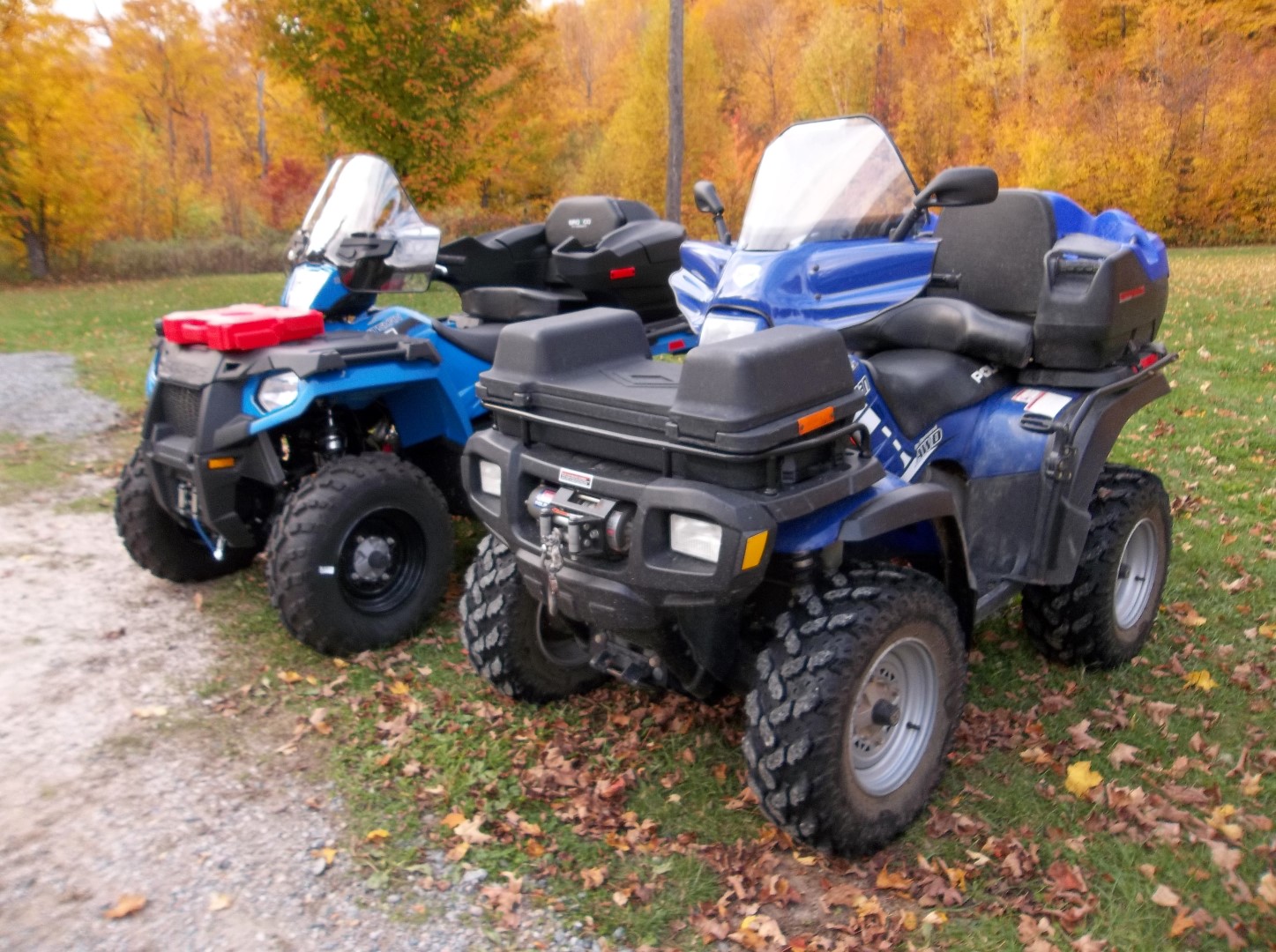

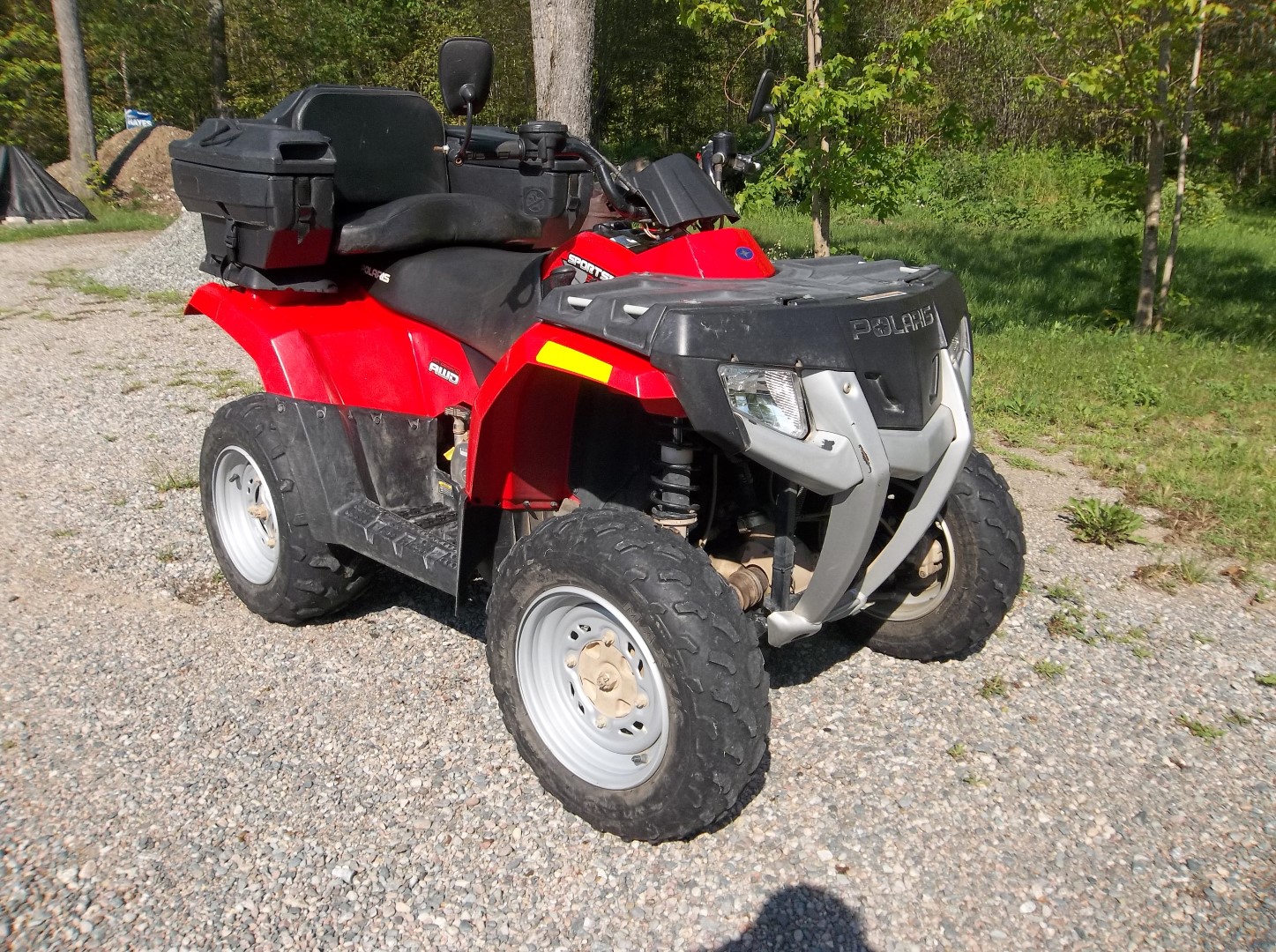

Bought my first Sportsman 500 H.O. back in 2004. It's the 04.5 half year model with the updates. One of the best purchases I ever made. It plowed my yard for 8 years plus all my trail riding. Only ever changed the battery and tires. NOTHING else. Has been bulletproof. Only today just noticed it needs rear wheel bearings.
Also have an 09 Sportsman 300 for my kids. Only issue with it is it is hard starting in the winter. But no mechanical failures.
So when it came time for another new one as my kids are outgrowing the 300 I naturally went Polaris, even though my fantastic Kubota dealer sells Can Am.

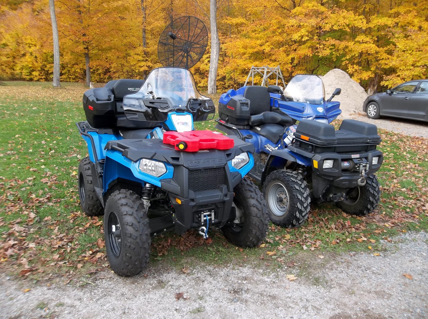

Well I have to say, I am disappointed in the build quality of my new Sportsman 570. The good....it will outrun my 500 by a huge margin. It rides like a Cadillac and the power steering which I always thought was foolish...is amazing. It is so nice to ride.
The bad....the day I picked it up, the salesman and I noticed the side panels did not fit and stay in pace properly. So he ordered new ones. Still the same. Polaris's answer......drill holes and put screws or push pins in the bodywork to hold it in place.
Then it was hard to shift. And the coolant kept going down. Brought it back to dealer for warranty. Found out the clutches were out of alignment and it had a bad water pump housing. Then they gave me a bill for $56 to use the warranty at 25 hours!! Not to mention the $90 PDI I paid when I bought it.
Called Polaris.....they said, that is normal. There is a deductible to use the warranty!!!!
And the water pump housing is still leaking around the gasket.
And the first ride the Lock and Ride windshield cracked around all the mounting bolt holes. No warranty on that.
Pretty disappointed on this one. Either going to replace it with an RTV or a Can Am now.
