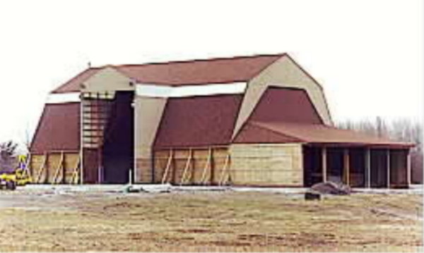

   / Pole Barn cost questions #4
This Shed Has a nice homey look to it. /forums/images/graemlins/grin.gif

Hey that must be one of those new Super Beer Barns. /forums/images/graemlins/grin.gif
