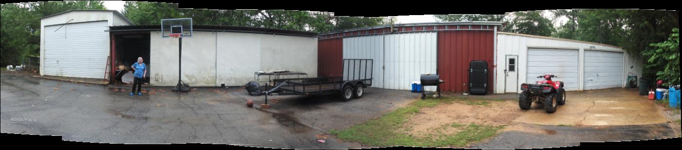

I've got roll-up on two workshops and sliding on two.
The "garage height" roll ups on the right are not bad. The 12' (?)tall roll up on the left can stick and be a bear to get up.
The sliding on the two middle workshops take up a bunch of space but I think they are more reliable.

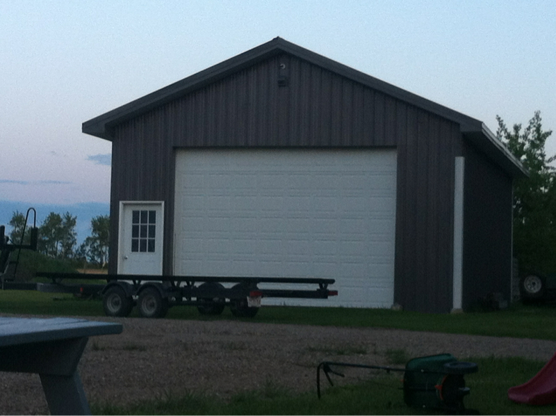

   / Pole Barn Door framing dimensions #11
I have an eleven foot tall by sixteen foot wide garage door in my twelve foot pole shed. On the side wall I have a seven foot by eight foot sliding door. I much prefer the garage door as the sliding door gets snow blowing through it.
Sent from my iPhone using TractorByNet
