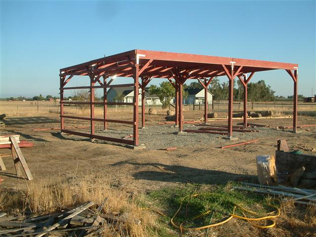

Use Simpson angle and T-brackets--two brackets per joint on each side of the beam-and 1/2" hex bolts-hot dip galvanized
