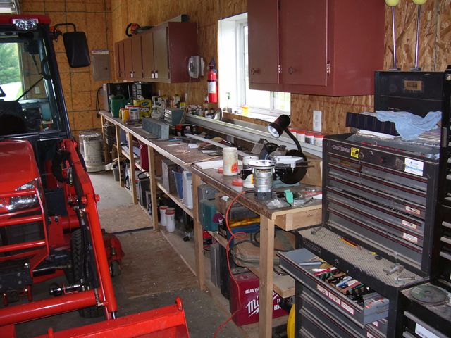

I've just finished insulating the walls of a pole barn that's about 30 years old. I was able to find some used polyiso roofing insulation sheets. I layered it into the walls, sprayed some "Great Stuff" into any cracks, then covered it with 4 mil plastic as a vapor barrier and finished with OSB and paneling. I was going to use metal liner panels, but I went with OSB to save money and make it easier to mount things on the walls. I think the walls are about R-30 now at a reasonable cost.
The used polyiso is available from roofing companies around here periodically. 4x8 sheets, 1.5 or 2 inches thick, usually go for about $5 each.
I put horizontal nailers between the poles on the inside at about 4 foot spacing. I ran wiring in the walls before I insulated, but if I had to do it again, I would run the wiring in conduit on the surface. I spent way to much time fitting around wiring and boxes.

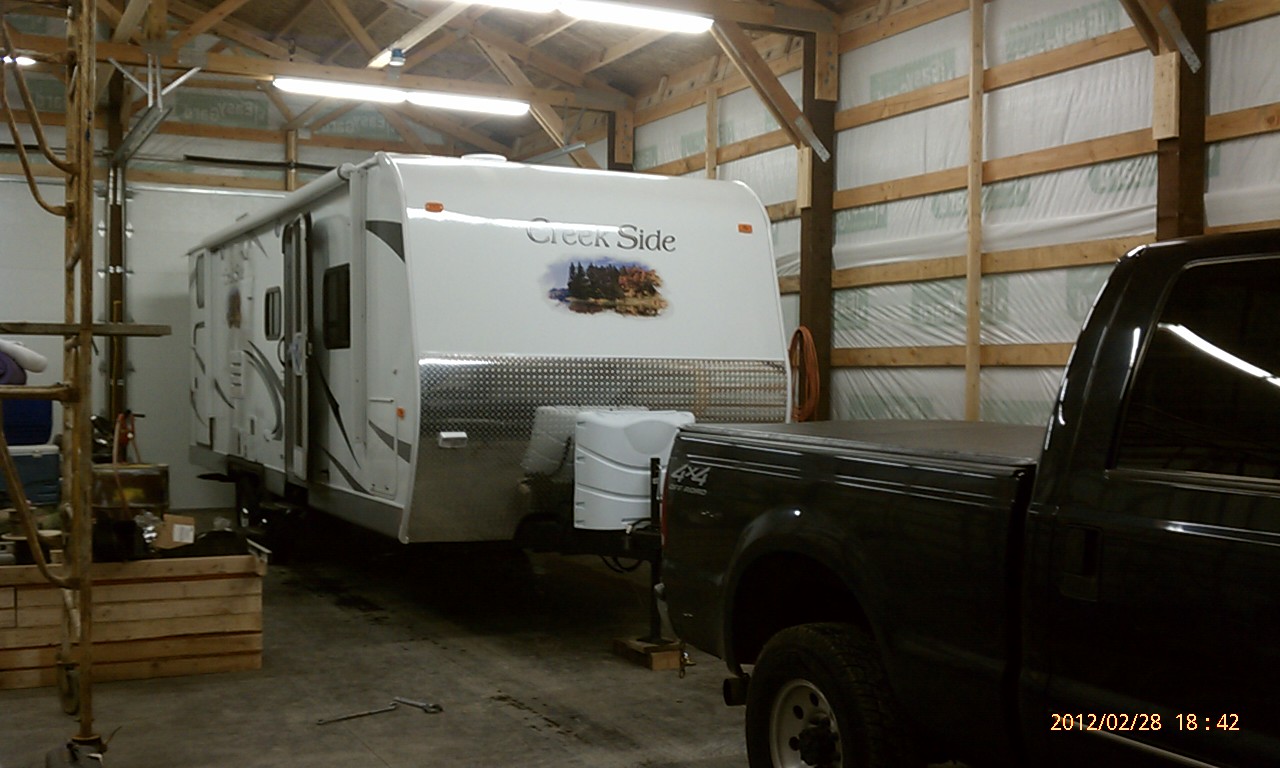

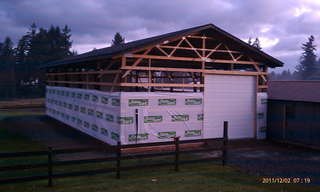

I am just now finishing a 30x60 pole barn with 14' ceiling.
In preparation for insulation I wrapped the buiding with tyvek prior to putting up the metal. Wind infiltration and also water leaks should be kept at the metal and not enter into the insulation within the wall this way. You can install tyvek after the fact by wrapping it around the inside of the posts and stapling it to the wall girts.
I plan to frame between the posts and install regular batt FG insulation, cover with plastic and then fire code sheetrock. This is the cheapest way to do it and the framing will give you lots of oopportunity to mount electrical devices, cabinets, shelves, workbenches, etc. and make the wall stronger. The framing is a good thing.
The attic will be done as you describe, add 24" OC ceiling joists between the trusses and attach something to that. Blown in FG or cell above.
Spray foam has some benefits but they do not justify the cost if you have other choices. Sometimes spray foam is the only choice.
Oh and I did the radiant tubes as well, 1800 LF on top of 2" EPS 25 psi foam. Don't let anybody tell you that you must use XPS foam, contact the manufacturer for the facts.
