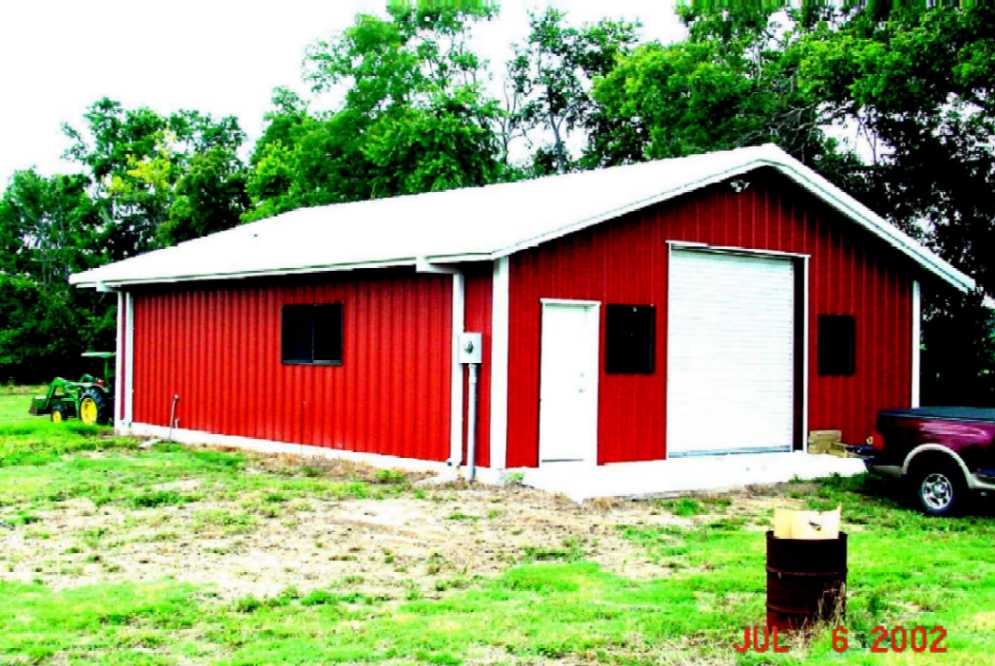

I put up a 30'x40' prefab steel building. Not hard at all. All the primary frame members just bolted together. Then the sheet steel went on with self tapping screws (a LOT of self tapping screws). Mine is fully insulated with 2' overhangs all the way around. I had help with the frame and the roof panels and hanging the 10'x10' doors. Otherwise, I did it all by myself.
