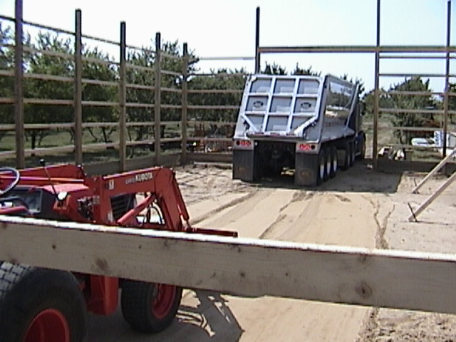

Thanks to all with the good info. The original plan was to go w/ 4-6 HID w/ MH equally spaced. Each would be on its own switch. Maybe a couple of the electronic flourescents over the benches, mounted lower. Attached is only pic I have with a tractor in it/w3tcompact/icons/wink.gif. (sand delivery)
Regards
Mutt
