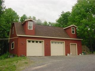

I have one that is 28 x 40 x 10. Studio apartment up top. I did not build it, it came with our house. Unique thing he did was use recycled sliding glass doors for windows. Lets in alot of light in the day. Right now I have our tractor and utv in it. I think you will have plenty of room for what you have planned.
   / Pole Barn Must Have's
<img src="http://www.tractorbynet.com/forums/attachment.php?attachmentid=305873"/>
Nice looking barn! Do you have any problems with the single bay doors? Are they wide enough for you?

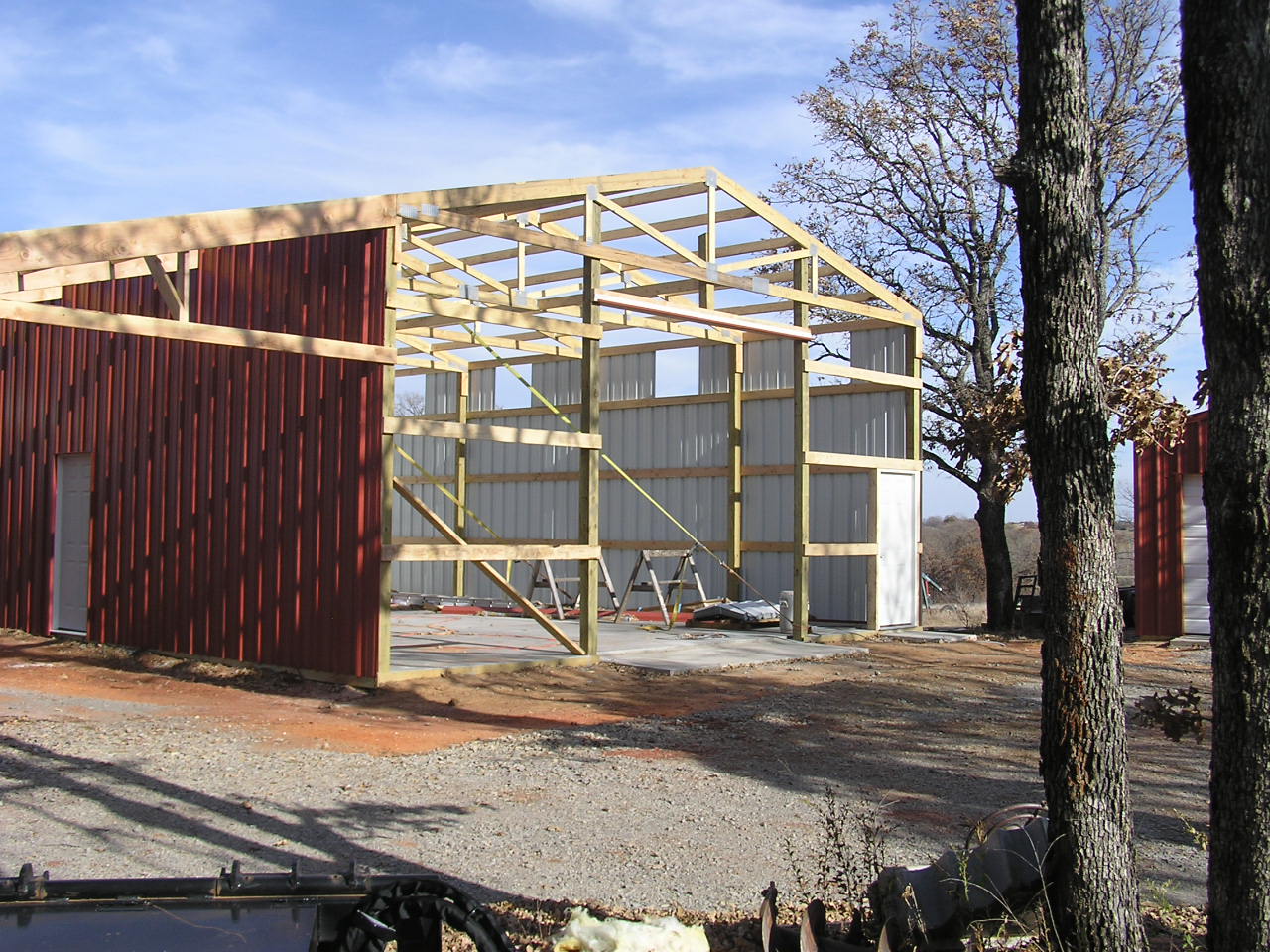

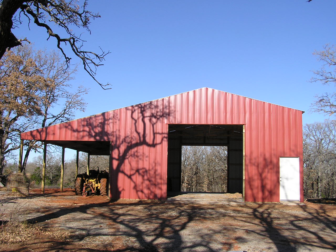

I would recommend bigger doors, you said 10 by 8, I would go at least 10 by 10.
I have a 12 by 12 door at each end to let the south wind blow through in the hot summers down here.
My old shop had the walk in door on the north end, it would freeze over in the ice storms we get.
Put windows or skylight panels high on the south or west wall, to let light in.

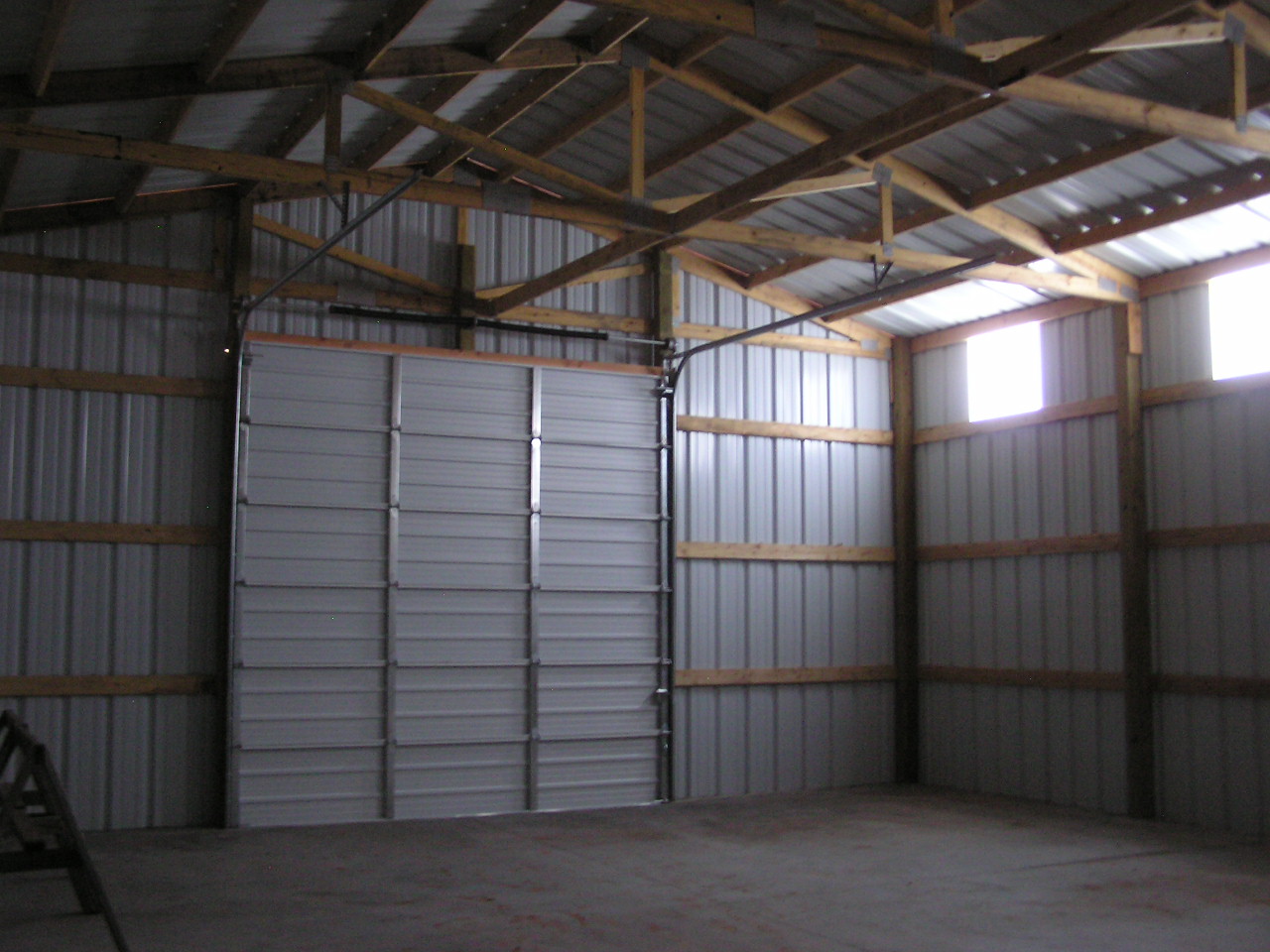

One thing is a Lean Too off one side for me, that way you got some open air storage for implements with eve high enough so ya can back in under it to hook/unhook the items. Make it maybe 10 or 12 feet wide.
I also like the WIDER Garage Doors on both ends for cross draft in summer to help cool it inside or BIG windows all around (like mine.) I put in 10ea 4'x5' sliders and 8ea DH 36x50" up stairs.
north-east pick inside
I have pretty much a 50x50 with 10' lean-too & should have gone 12' lean-too off it. Mine is on North Side (mainly due to that was best way for property layout. I intend to someday MAYBE put a 10' greenhouse off the south side.
