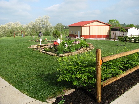

I had a 30 x 40 pole barn built my an Amish Company that we have used before. Our building was built on a rolling hillside and required some dozer work, foundation walls 2 to 6 feet tall, 5 1/2 inch concrete floor, floor drain, 10 foot tall sliding barn doors, man door, two windows, color siding, roof overhang, closer spaced roof truss, and they moved a 12 x 24 foot storage building about 10 feet. Total cost was $14,000 plus change. I did all of the electrical work (outlets and lighting). Nice thing about using a contractor is in one day the excavation/dozer work was done, one day to place the concrete, 2 1/2 days for the building, and it was done!!
I'm just getting ready to re-side the storage building (now a potting shed) in the same colors as the barn. I also need to paint the man door.
