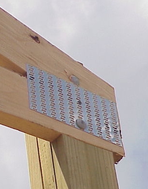

1. Would you suggest going with solid 6x6 or 3-2x6 nailed together for the poles
2. Is a 32x64 with a 12'-16' lean to on one side big enough?
3. Is a 12' ceiling high enough or sould I go 14'
Also I prolly wont have quite enough money to side the whole thing with metal the first year so I was going to just put the roof on and then put the side metal on next year. What are your thougts on that and are there any special considerations I should take if I don't put the metal on the side this year.

I would go with 3 - 2x6 with the top center made to accept the truss sandwiched between the two outer 2x6 and cut the top of the post off roof pitch slope after the trusses are set and bolted. The end rafters are set flush as seen in the pic.
Building height is mostly personal preference and what fits what you'll be housing in it. There have been bunches of open sided buildings built and sometimes they are called a hay shed. One problem with open sheds is that high winds can be detrimental occasionally.
You are lucky to have free lumber assembled and good luck with your building.
Personaly preference. They are built both ways and last a lifetime. BUT, typically, the 2x6 method is cheaper since only what is in the ground is treated lumber, whereas a 6x6 is treated all the way. IF you dont plan on siding right away, I would go with the 6x6, or at least treated 2x6's all the way incase you dont get around to siding it for awhile.
We cannot really answer these questions. It all depends on what you are going to store/use the building for, how much equipment you have, and what your future plans are.
Special considerations...See above about the posts.
Also, dont frame the walls until you are ready for the siding either. Non-treated construction limber doesnt last long out in the elements. So just keep that in mind.
