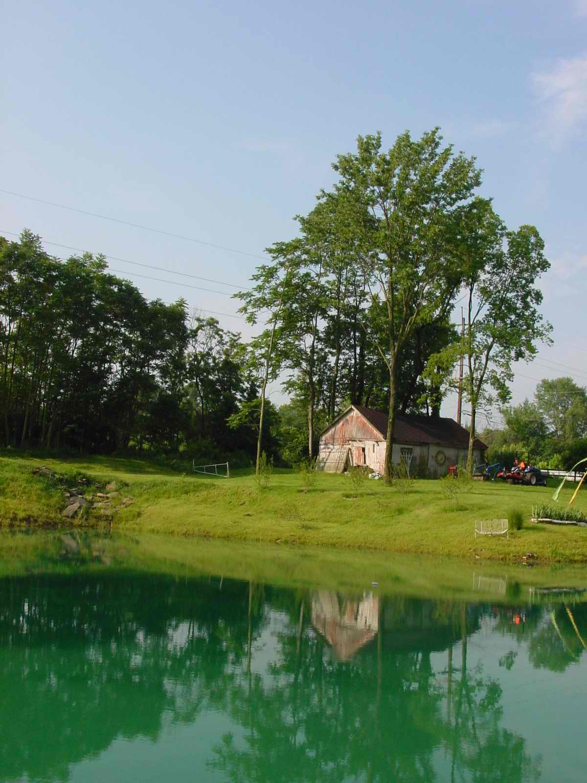

Buck--
I didn't see your post for a couple of days. Work started on May 1 2000, and took 20 days. It just filled up in early July 2001. The pond is about 12' deep in the middle, and it does have a dam. The dam keyway was dug down about 20' and then brought back up with on-site clay compressed with a sheepsfoot. It has about 3 acres of runoff and is about .65 acres in size.
Rick
   / Pond building #6
A second view . . .
Rick
   / Pond building
Thank you for posting.
That looks very, very nice.
Thanks again,
Buck
