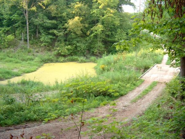

We've got very small drainage creek between our property and my neighbor to the north. There is deep ravine and bridge at the bottom of it. Starting Monday a contractor is going to tear out the bridge and put in a dam. The dam will be 10ft. taller than the bridge is now and we're going to knock the top the hill down some to further reduce the grade. It should make a 2-3 acre pond. Here is a picture from the bridge.
Kevin

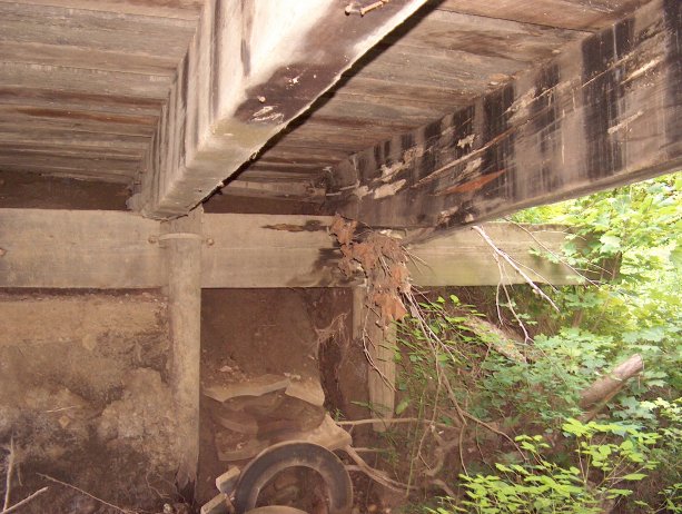

underside of bridge

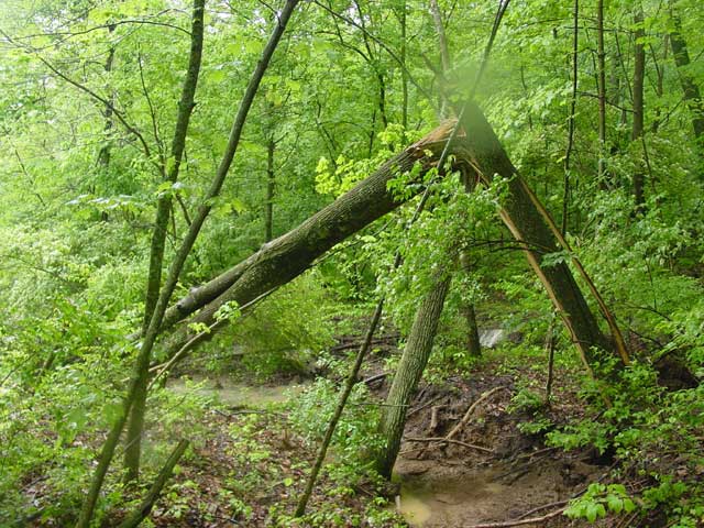

south of bridge
