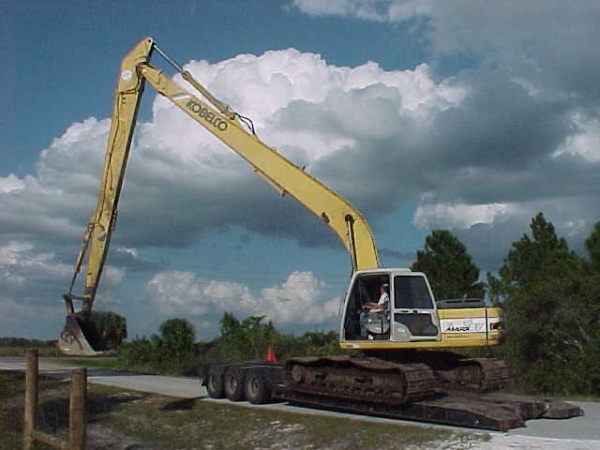

If you want to dig the 70' pond deeper, you're going to need something that will reach halfway across, from a safe point above the bank, and still have enough reach to go down 6' below you. That's a good size excavator, like the one the contractor brought in to do my pond (see attachment), which has a 52' reach.
You could probably learn to run it, but something that big will likely be difficult to rent. On a smaller scale, the folks building on the property next to mine rented what I would call a mid-size excavator, a JCB with about a 30' reach, and it cost something like $1200 per week.
Before hiring my contractor, I also considered buying a "beater" excavator and digging it myself -- when making a new pond, you don't need as long a reach, because you can keep moving back. I've seen excavators on EBay for as Little as $4K, usually from someone who bought it to dig a pond and is now selling it. I ended up not taking that course because I also needed to move the spoil (over 2,000 yards), and grade it, and I found a contractor who would do it all for a good price.
Considering that you will be likely to find a contractor that will do the digging for about $1 - $1.50 per cubic yard, I think my advice would be to hire the contractor and find another project to have fun with. You probably have less than 700 yards to dig. I bet you can get both ponds cleaned out and deepened for about a grand. While my contractor was on site, I had him run next door and clean out my son-in-law's pond, make it a little bigger and reslope the banks. It's about 125' x 85', and about 12' deep. He charged me $500. You usually have to pay one-way on the transportation of the excavator, also.

I dig a few ponds each year, Itd be bes to hire it out as many renatl stores wont rent out a long reach excavator, You might rent one from ad ealer if he knows you. One other thing if you digg too dep and go past the clay if there is any sand or a ridge of bedrock you may loose water there. On the smaller pond it may be best to drain it and dr1y it out then have a scraper and dozer com in and dig it out. With a good 10 yard elevation/paddlewheel scraper you I can move 800 to a 1000 yards a day. The last one we dug we took a 762 J scraper and i stripped the topsoil and piled it. then took the scraper and dug my clay out and stock pileds it and went way into the sand. When we goteh the right depth and form I packed the sand by loading the scraper and driving in the bottom and sides. Then went and started picking my clay up and putting 5 inches of clay down and packing it. then lay another 5 inches down. and pack. The scraper exerts more PSI than a roller when loaded. Digging the other pond out would be hard without a drgline or a long reach hoe. APC300LC Komatsu hoe may reachthe 35 feet from each side of the pond but it would leave a little in the middle because of the booms travel radius.
