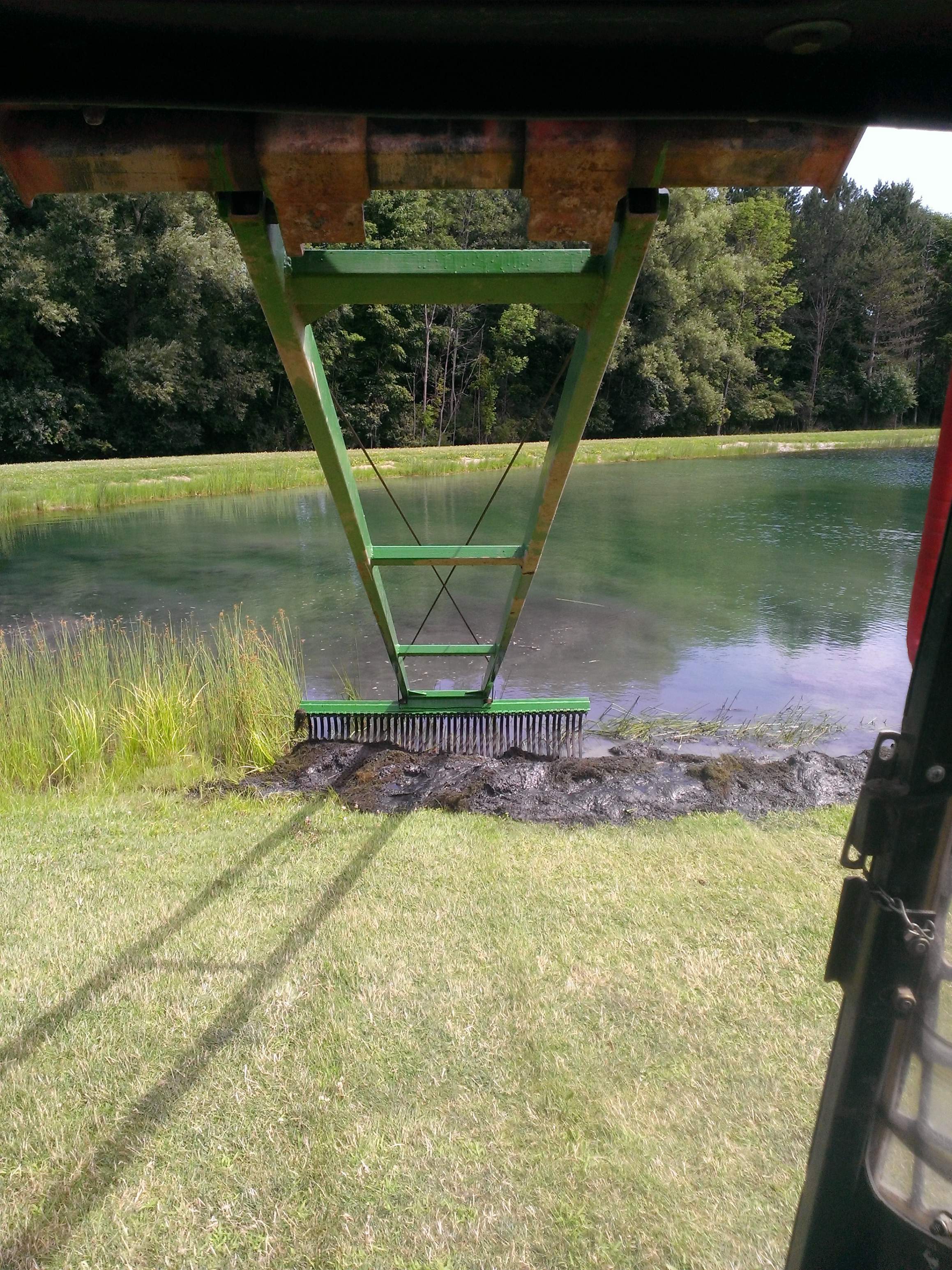

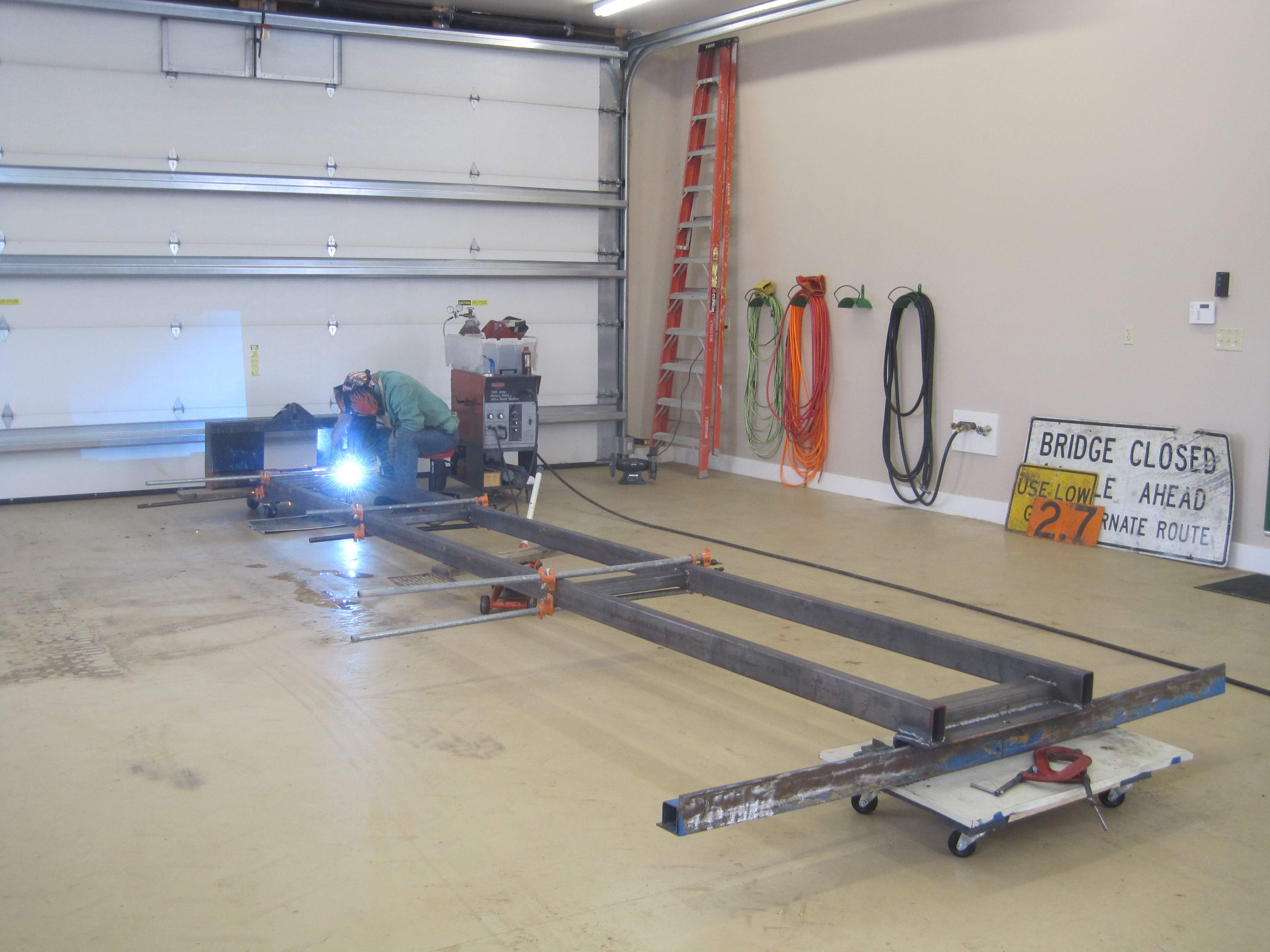

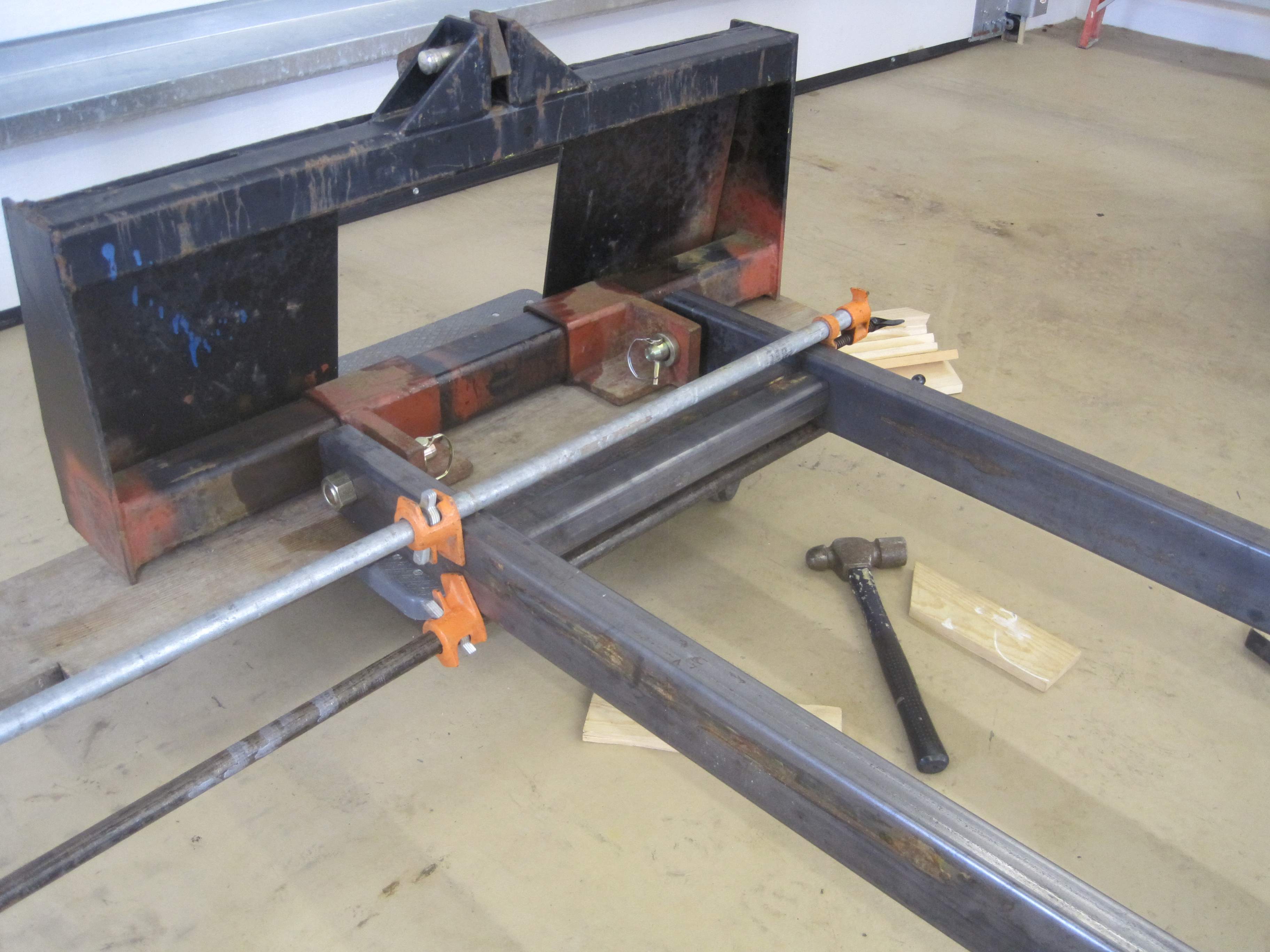

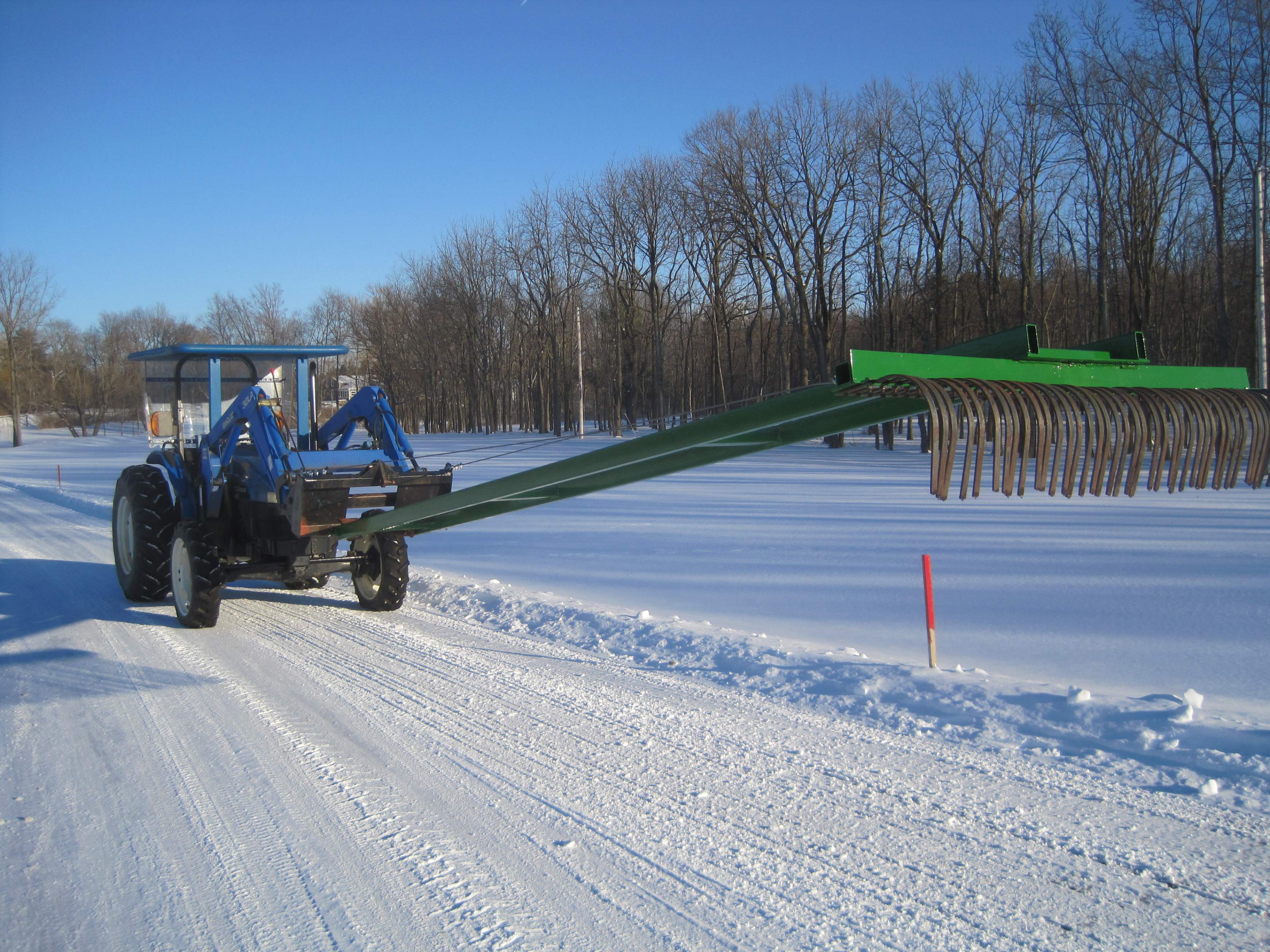

Latest project was an "Extendo-Rake" built to clean up the debris & vegetation along the banks of a pond. 20 feet long, fabricated with 2x4 steel tubing. Hinged at bottom to prevent excessive downward pressure from the skidsteer arms. Weight of steel is sufficient to rake up debris without digging into the pond banks. I needed raking action rather than digging. Lifting cables are 5/8 and crossed to prevent sideways swinging. Quick adapter is a 3 point adapter plate using the lower pins as hinge point. Skidsteer stays up on safe, hard ground.
Works better than I anticipated. Where the vegetation was heavy, a few weeks in the sun to dry out before burning. Grass seed over other areas of ballast, muck & mud germinated quickly. Water was cloudy for a few days but cleared quickly. Pond was being overtaken by cattails, the rake pulls them out by their roots. Stone ballast originally around the banks was pulled back up.
Video is displayed 2X times actual rate. Three pulls in the same spot brought up most vegetation and muck. Also works good from a tractor, but skidsteer is easier without braking & shifting a tractor transmission.

You could make an attachment, for use as a roof rake, for heavy snow removal.
