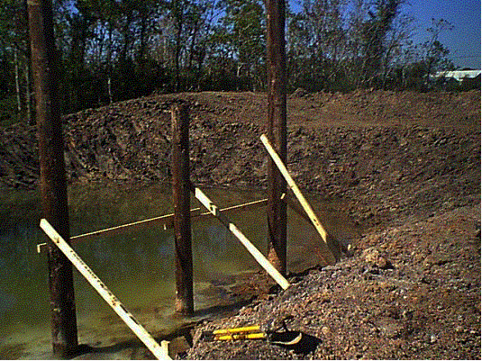

Nick,
I tried the same thing last year and I would not recommend doing it. I got about 3 to 4 feet down in a small area and the hole would fill up in a day or two because of the water table in this area of Texas. I gave up after a couple of days and rented a track-hoe and a dozer and dug my pond in two days.
The way I did it was I hired a dump truck for a day at $35 per hour and had him dump the dirt where I wanted it (way better than pushing it.) then spread it with the dozer.
Total Cost:
Komatsu PC200 Track-Hoe 2 days at $450 per day $900
Dresser TD7 Dozer 2 days at $220 per day $440
Dump Truck and driver 12 hours at $35 per hour $420
Delivery charges, taxes, fuel $600
Total $2360
The bids I received ranged from $1.75 to $3.00 per cubic yard to dig my pond I did it for less than .50 per cubic yard.

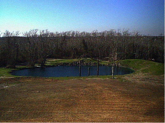

   / POND????
A better picture
   / POND???? #7
Nice job you did there Mr350. I just wish the pics were a little more clear but they made the point. Now that's some nice equipment you got to run and rent. I just tried to rent a big excavator and without contractor's insurance the local rental yard doesn't let the average home owner do it anymore. They said they have lost alot of business that way and I can see why. Boy talk about ruining a person's day when I found that out. /w3tcompact/icons/frown.gif Oh well nice job you did there.
I wouldn't suggest doing it with nothing else but a excavator and dozer or just one. But you sure woudl get some seat time doing it with boxblade and loader. /w3tcompact/icons/wink.gif

   / POND????
Thanks to all of you for your advice - I think I'll listen to it and go for a bigger piece of equipment to do the job. There's a few small operators around here that I think I can hire for a day or so to get the pond dug and pile the spoils where I can get to them.
Mr350 - that's almost exactly what I had in mind - thanks for the pictures.
I forgot about the water table - which was the main reason the county is requiring an aerobic system - very shallow. Your comments made me realize that I would be fighting water the whole time I'd be scraping. I much prefer the idea that in a couple of days I can have the hole dug and then have some fill dirt available.
Thanks also for posting the general costs - it helps to know what somebody else has paid as a comparison.
Great place to ask questions before I get in over my head - wait a minute, I forgot - I'm already in over my head /w3tcompact/icons/smile.gif!

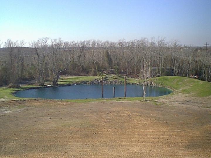

   / POND???? #9
That is a great job. And thanks for the price list. Always helps in decision making. What was the final size of your pond? How deep did you have them go? And finally, (gees, like that's not enough /w3tcompact/icons/eyes.gif) was there a 'plan' to guide you on how steep to make the sides? Thanks for your help........
   / POND????
The pond is 100' X 85' and I wish I had gone bigger.
Them? Them who... All work was done by me the prices listed are for equipment rental only.
And the pond ranges between 8' and 16'.
Bummer.
No I just eyeballed it.
Nick, A few other tips. Cast the topsoil off to one side for latter use also save a few loads of clay (You'll have tons) to reline the pond.
