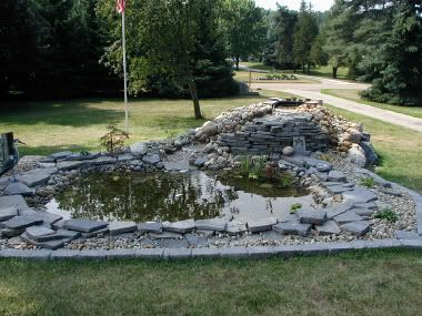

I have a pond that was dug with my BL4690 BH in 2002.
It is 11' X 16'. Just about right for us.
Use a good liner material. Put a good sand base and protector for liner.
Ours is a skimmer/bio-falls type. Pond started at 3' deep. By the time all sand and rock were added depth is just over 2' deep. This a good depth that allow you to get into pond and work on bottom with water in pond. Any deeper and you cannot rear bottom without getting wet.
The biggest thing we have done is eliminate all vegetation in pond. This has cut down on pond maintainability greatly. Wife is not that happy with this change. But it has really made a difference. You do not have to worry about freezing where you live. We always had some type of heater in pond. Did not put one in this year. It was cold here in MI. this winter. Mine and my neighbors pond did not loose a single fish and saved a lot of money running the heater. Yesterday I replace the pump in the pond. These thing can use a lot of electricity and are expensive to buy. Our uses about $30 a month if run full time. I put our on a timer that shuts pump off during the hottest time of day. This kills off the algae that collects on the falls and saves $'s.
One other problem we have is Cranes. There is a rookery about 1 mile from our place. Our neighborhood ponds are one of their favorite places to visit. We have a motion sensor lawn sprinkler that keeps them from spending to much time at our pond.
We have stopped trying to raise Koi. While they grow bigger than Goldfish. They are not as forgiving of water that is not just right. No problems with Goldfish and they thrive on clear water.
Please ask questions if you need more help.
