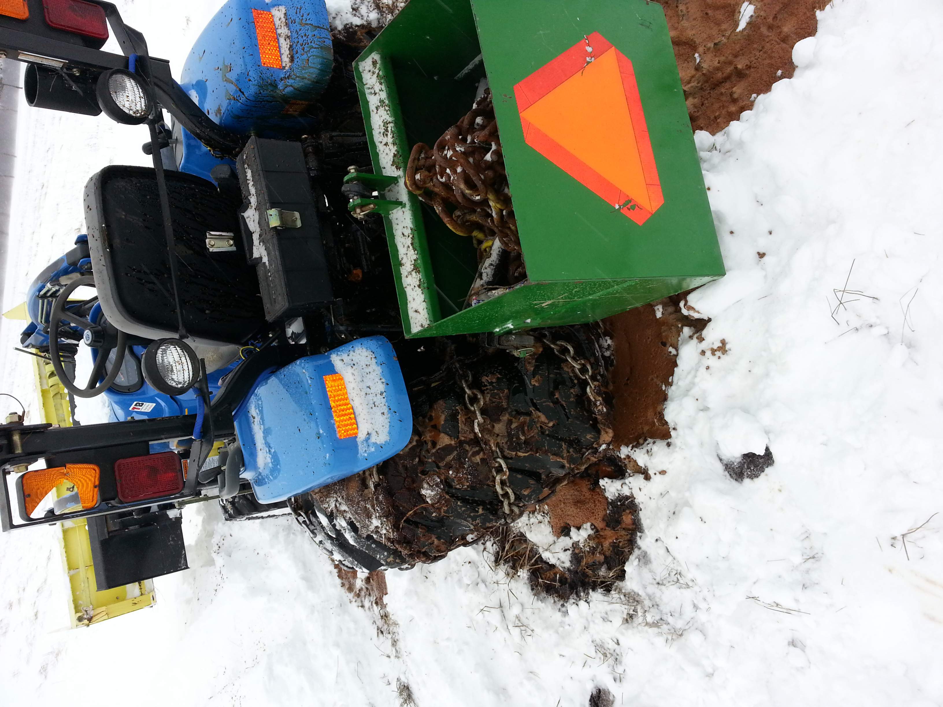

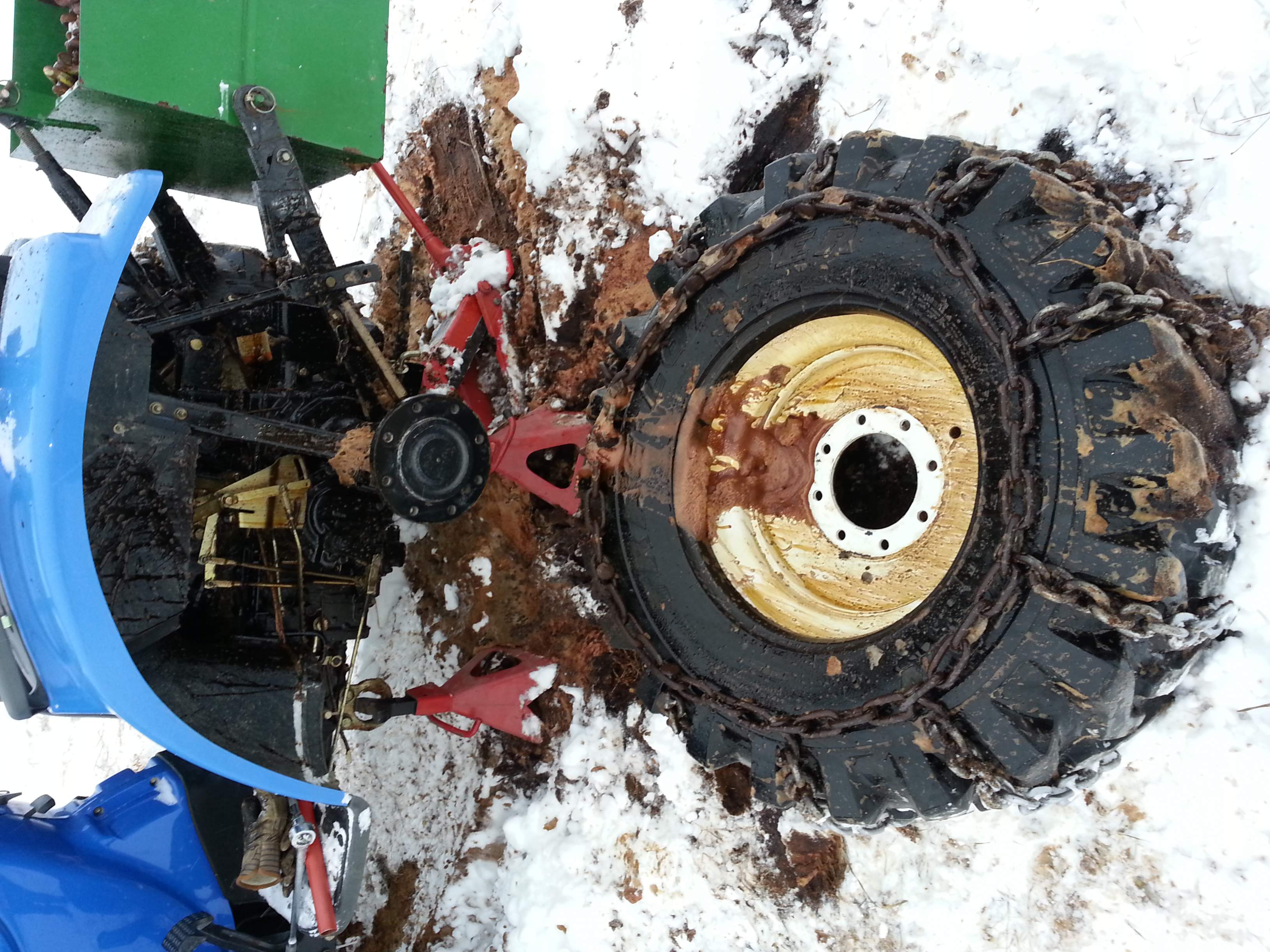

I was pushing Nemo around last night, making my boy a snow mountain. Pushing in low gear and using high when in transit. Not real sure what happened, but hit deep snow and ran out of steam. Shifted to low, and right about the time I thought "binding", there was the "blup!" Of large tire bead letting loose, a sudden drop and the left rear followed by and EXPLOSION of Rim Guard that covered myself and the tractor.
Inside bead let loose. Near as I can tell, I forgot, and never noticed, that I hadn't put the pins in the 3pth stabilizers. One of the pins got caught in the chain and somehow blew the bead. One leg of the clevis at the bottom of the lift link was also bent out.

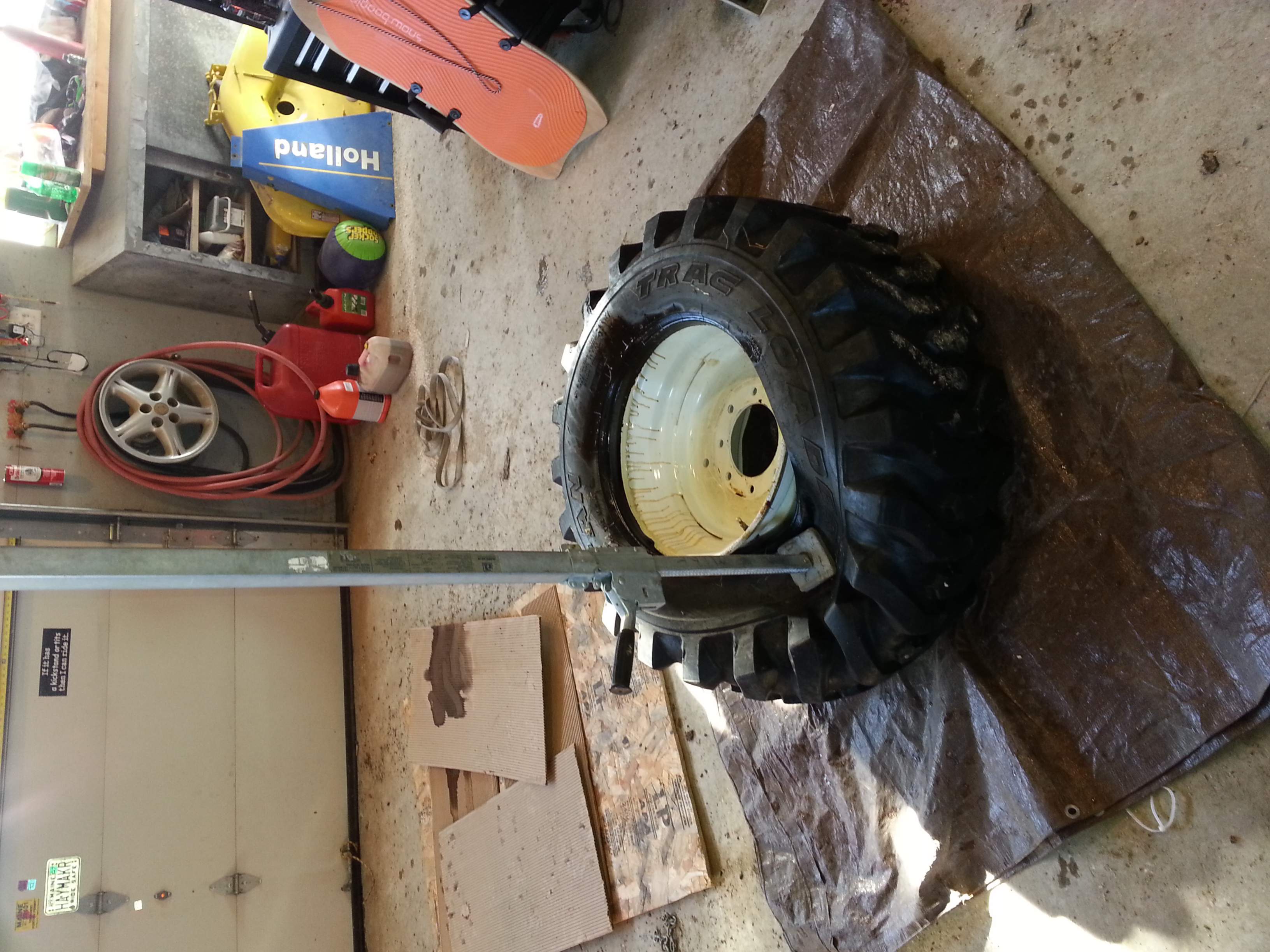

Miraculously, there was no damage to the tire! I'm out many gallons of Rim Guard and the joy of removing a wheel, 300 yards into a field, in a blizzard. Oh, and shoveling out my pickup that I used to drag the tire to the house.
I also threw in a pic of what made remounting the tire much easier.
