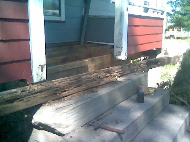

I want to put new planking on my covered porch. At each supporting column, I can jack the roof up slightly and remove the old planks after cutting through a few nails at the column base with a reciprocating saw. The nails hold the square base piece to the planking. I did one, and aside from gravity, nothing seems to attach the bottom of the column to the square piece under it that rests on the porch planking. How should the columns properly be attached? The columns are laminated wood.

I would guess the fasteners rusted away. If you don't want to get real involved, how about urethane construction adhesive, (the good stuff), when you get them jacked up?
I did a floor like that a while back, and the columns were just 1x6's made into a hollow box. The 3 of the 4 that mattered, were rotted on the bottom, the whole rim joist was wasted, and they were somehow still holding up the whole porch roof. :eek:

I'm not familiar with that. Are they solid or hollow? I saw some fellows building a wooden cover or roof over a concrete patio recently and the supports are 4 x 4s. I've seen some done in a similar manner before where "L" brackets were attached to the posts and a screw into the concrete to ensure they didn't move around. But the job I watched recently doesn't have anything visible to prevent the posts from moving around because they drilled a hole into the center bottom of each post, and a hole into the concrete and put a single metal pin in each one. You could very easily jack them up and remove those pins, but they sure won't slide around.

Gravity is probably all you need, except for the occasional tornado! Is there a block inside that keep the post from scooting sideways?

Your porch looks just like mine did, damage and all. About 10 years ago I ripped everything down, poured new concrete footings, added new stringers and installed new flooring. Here in NE most older porches are done with 4/4 x 4 inch vertical grain clear fir. Costs like the wrath of God, but is very durable. I've seen porches that are a hundred+ years old still in good condition because every few years they were scraped down and repainted. I painted all four sides of the boards and toe nailed them in place AFTER they were dry. Don't put them down with wet tongues and grooves. Once in place, another coat of porch and deck enamel and you're good for another 8-10 years of normal use. The columns on my porch were held in place by the weight of the roof and did not appear to have moved at all since they were installed.
