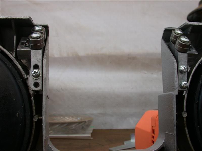

A little over a year ago while shopping at Harbor Freight, they had a portable bandsaw on sale for $49.95 I figured for that price I couldn't go wrong. This last weekend at the property, I found out I was right. It was the first time I opened the box! I also bought several other items such as a chain saw chain sharpener (still in the box never opened) and a couple other tools like that.
Anyway, I had some sawing to do so I got it out of the box. First thing I did was check the roller guides out and saw they were out of adjustment a lot. I took the bottom of the saw off and noticed there was no adjustment for the guides? I wish I took a photo of it like that, but I didn't.
You can see that the tapped holes were way too low for the roller guides with the bottom tapped hole nearly off the casting. Their jig must have been off on that side because the other side was good. It supported the blade properly. To fix it, I drilled a clearance hole in the guide and turned it into a slot. I put the first screw in and tightened it into position. Then drilled through the guide into the casting and screwed in a self tapping screw. When I put the blade back on, the roller guides now supported the bandsaw blade correctly....sideways and the bottom of it. It only took me a few minutes to fix.

I had never used a portable band saw before so I thought it was pretty cool. It runs off 110v (I used a Coleman 3500w generator). The motor is very strong even at the slowest setting I used. The blade seemed pretty good considering there was no coolant for it. And the squareness guide allowed me to easily keep it square and parallel to my work piece. Aside from the one roller guide being in the wrong location, I give the saw an excellent rating on performance and cutting ability. The overall finish, screws, frame and plastic housing were about average. So only the guide problem, which I thought was an easy fix for me, was the only drawback. I would have tweaked the roller guides on any bandsaw I bought, to be sure they were perfect, so having to fix this one was no big deal to me. Over all considering everything, I think it was a good value with very good performance, especially for the price I paid.

I have the same HF saw and had similar issues corrected much the same. I also found out it is important to store the saw with the blade loose to keep from deforming the rubber on the drive wheels. A very capable tool.
