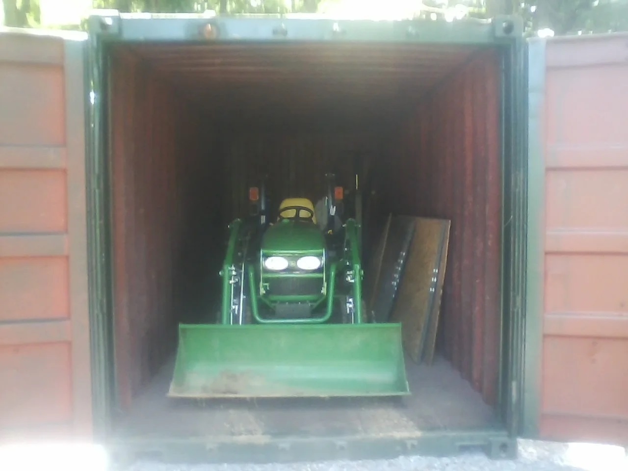

Ideally, a Shipping Container 20x8 is ideal. The price is fair too including delivery.

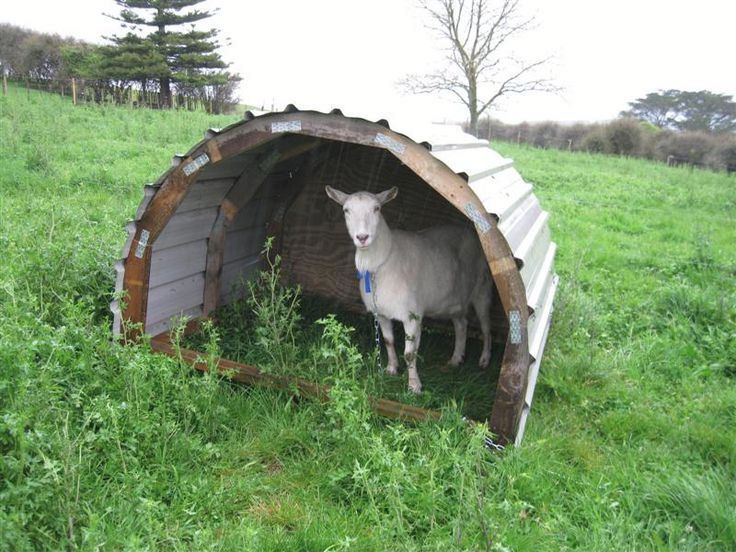

Ah, now were talking the details.

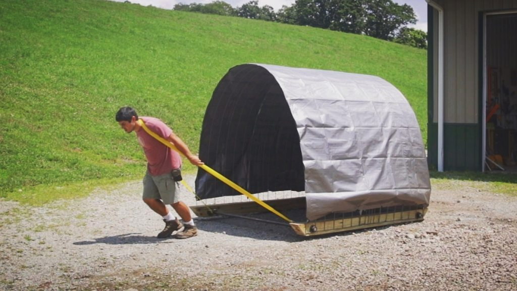

Univ of Ky and Oxford Univ have shelter plans for livestock. I've made 3 types over the years from their free plans. You need a structure like a chicken tractor, but for sheep, yet movable.
I made this type once. Put wheels on the back and a fold down wood bar up front. Then with the tractor 3-point, hitched it up and drove it around for goats. This guy is working way too hard. LOL
Sheep, goats and taller for donkeys.

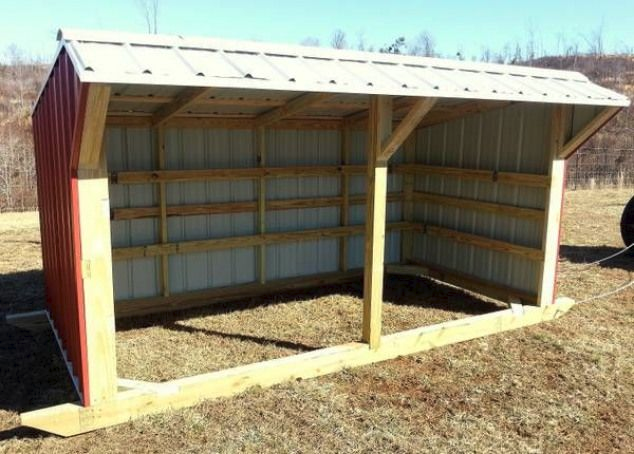

Most Amish shed makers can built this, but the price is about $3,500.
If you have the materials and skids, tractor pulling is easy.
   / Portable garage #9
If this is for long term use, it might be better to look at buying or building a metal run-in shed like bmaverick posted instead of fooling around with tarps that collect water, rip and tear and cause trouble during the worst weather.

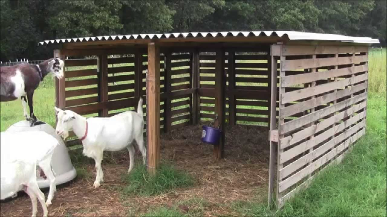

   / Portable garage #11
I've made a few of these. Pallets are generally free, the roofing sheeting was $26 each from Home Depot. 4x4x16 is $12.
