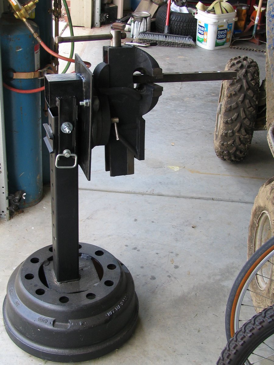

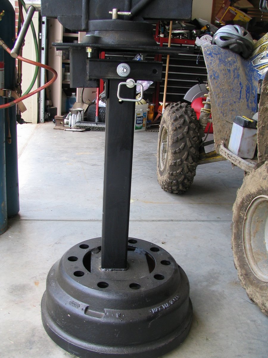

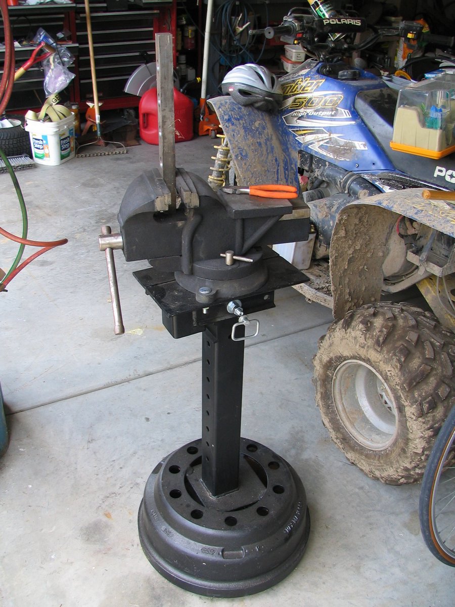

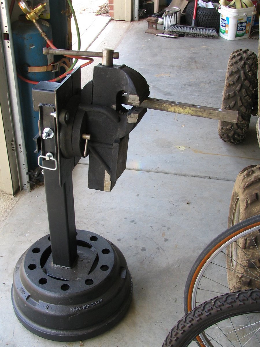

I have always envied those of you who had room for welding tables. For the rest of us, I would strongly recommend you build one of these.
This setup is portable, heavy duty and flexible. The base is made from a semi brake drum (free) and the vice is from Harbor Freight ($30). I made the top "flippable" so that it could be used both ways.

Very nice setup, but since not even the moderators can change the title of a thread, I just wish you'd named it properly as a "Portable Vise" instead of "Portable Vice".:D
   / Portable Vice
Good catch Bird (you stink!) .... I actually meant this as a pun (actually not) because I spend so much time tinkering .....
   / Portable Vice #5
That is nice, but it has one drawback. It is only as strong as the weight that you put in the brake drum. So, in order to fix that, for the times you have to really torque down on something, make a hitch adapter to fit your Reese Hitch on your tow vehicle. If that nice stand won't handle it, pop it off, stick it in the Reese Hitch on the back of your truck and twist all you want.
David from jax
(But it is still a nice vice!)
   / Portable Vice
Sandman-
Your right about the weight issue. I have some flexibility to crank on things depending on how it is positioned, but your point is well taken. I should have titled this better (besides the spelling) and mentioned in the title about welding. I almost exclusively use this for fabrication (cutting with a torch or plasma cutter,or to hold items while the are being welded or ground with the grinder. For grinding it works especially well because I can spin it out by the grass and let the metal chips oxidize in the grass instead of on my garage floor.
I would recommend this to anyone who needs these properties but to your point, look elsewhere for high torque applications
