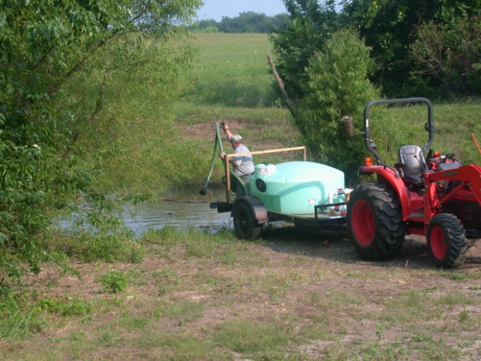

Ive been working on this project for a couple weeks now and finally finished it up today. I thought maybe you would like to see how it turned out. So far, it works very well.
It is a water wagon that I pull with my compact tractor to irrigate my crops and garden. I designed this system to help me do the following:
1- pump water out of my pond and into the poly tank very quickly,
2- then pump water out of the tank to irrigate my acre of sweetcorn, all our little trees and my wifes garden,
3- it’s also a portable pumping station which can pump water from the pond, bypassing the tank and having a straight discharge. For example, I am sucking water from the pond and then discharge thru an irrigation pipe straight up to my garden about 200 ft away.

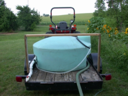

Closeup of the trailer. (Yup, I live in kansas)
I can fill the 325 gallon tank up in less than three minutes!

Here Im tossing the suction pipe into my pond.

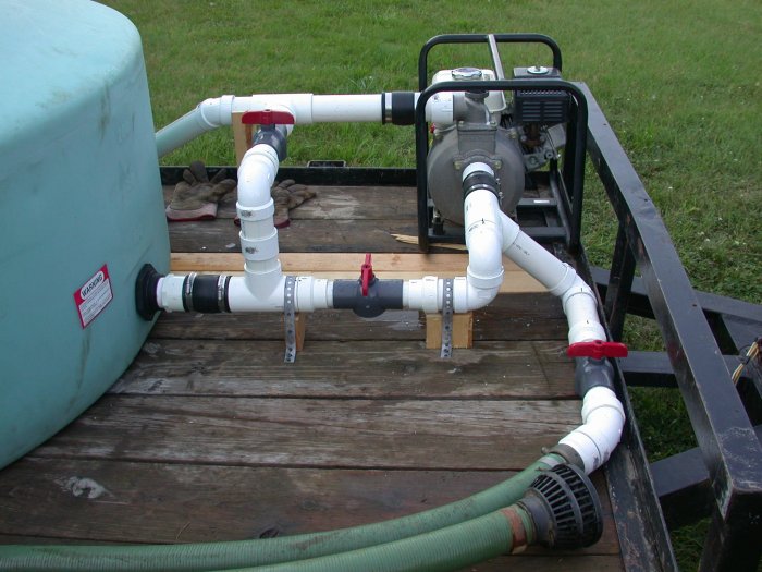

Here’s a view of the water wagon from the tractor seat. You can see how I set up the valves and the array of PVC piping.

A side view of the water wagon. Note, I had to use rubber couplings - especially on the suction and discharge of the pump to permit some movement of the pump while it is running.
Also, there is an inline filter located near the back of the trailer and is used only during irrigation, not during filling. There is one valve located between the tank and the fender tha the pictures don’t show very well. Therefore, there is a total of four valves.
Lastly, there is a relief line right before the filter. That line is routed up to the tank’s top fill opening.

Do you go fast enough to need that wing on the trailer? /forums/images/graemlins/smile.gif
All seriousness aside, nice rig. I like the way it's self contained. Interesting how the tank has notches to fit over the trailer tires... made to fit!
   / Portable Water Wagon Project #7
Actually the wing needs an adjustment, so it provides lift when the tank is full, and downforce when it's empty. I'd look for some other method than a wickerbill though, they are pretty slow. /forums/images/graemlins/tongue.gif

The wooden thingy at the back end of the trailer is just a couple of 2x4" studs screwed together to serve as a hand hold and it also supports a crude water boom/tower (not pictured) which dangles off the side to irrigate my sweet corn.

Id like to add that I also put a cheap pressure gauge on the discharge side, upstream from the filter. At 3/4 throttle, it shows 45 psi. For a 2" pipe, that seems like quite a bit of pressure to me.
When watering, I just let the pump idle and there is PLENTY of flow using an ordinary garden hose.
Also, the differential pressure (increase) across that filter is noticeable, giving me the 45 psi, so I dont like to run full throttle when watering and dont really need to. When I was testing it, I took out the filter and the pressure was only about 15-20 psi. Maybe someone could help me decide on how to keep the pressures as low as possible??? Different filter size mesh???
I did blow out the one rubber coupling on the pump discharge once. But whenever I fill, I can use full throttle and don't have any problems with the rubber couplings in the "fill" lineup, only the "emptying" lineup.
Overall, I think the pump is a little TOO much for my system. I think a 100 gpm pump would be plenty. Mine is 190 gpm.
Also, I confess I used vent and drain pipe which is not rated for a pressure system but it was a lot cheaper and my confidence was low that the whole idea would even work. Im still a little concerned that I might burst the pipes, so I want to keep the operating pressures low.
So far Ive pumped about a dozen tankfulls of water.
Any feedback from you all is welcome. Any idea what pressures a 2" vent and drain PVC pipe can withstand???
dwight
   / Portable Water Wagon Project #14
Dwight; Nice job!! Ah yes your pressure problem, real easy. Move your filter to the suction side of the pump, that will also protect your pump impeller from wear and tear. And then, on the discharge side, put in a tee between the discharge valve and pump, another valve, preferably a globe valve, and attach a recirc line back to the tank. By throttling the recirc and discharge valve, you can vary your pressure and flow, and protect the pump from overheating due to low flow. Sure works on the pumps in powerplants. /forums/images/graemlins/grin.gif /forums/images/graemlins/grin.gif
