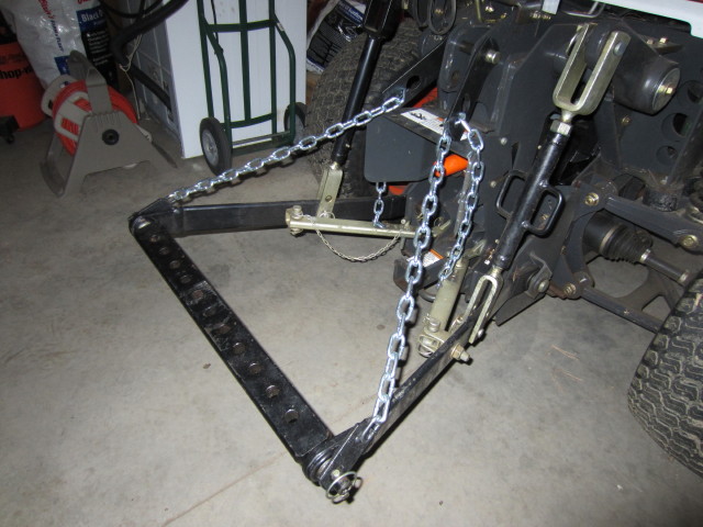

The other option would be how to use a chain from the top link to the lower links of the 3 point hitch to limit how far down the plow can go. Then it would act like position control on a larger tractor and you would not need the wheel. The downside is with bumps and such you may end up going deeper or shallower when the front of the tractor goes up or down.

You can get a chain kit like this. I greatly stabilizes the side/side movement too as it triangulates you 3pt lift arms.
