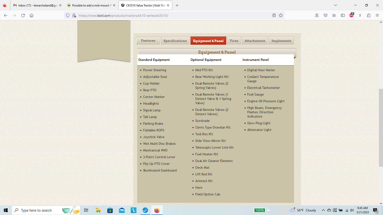

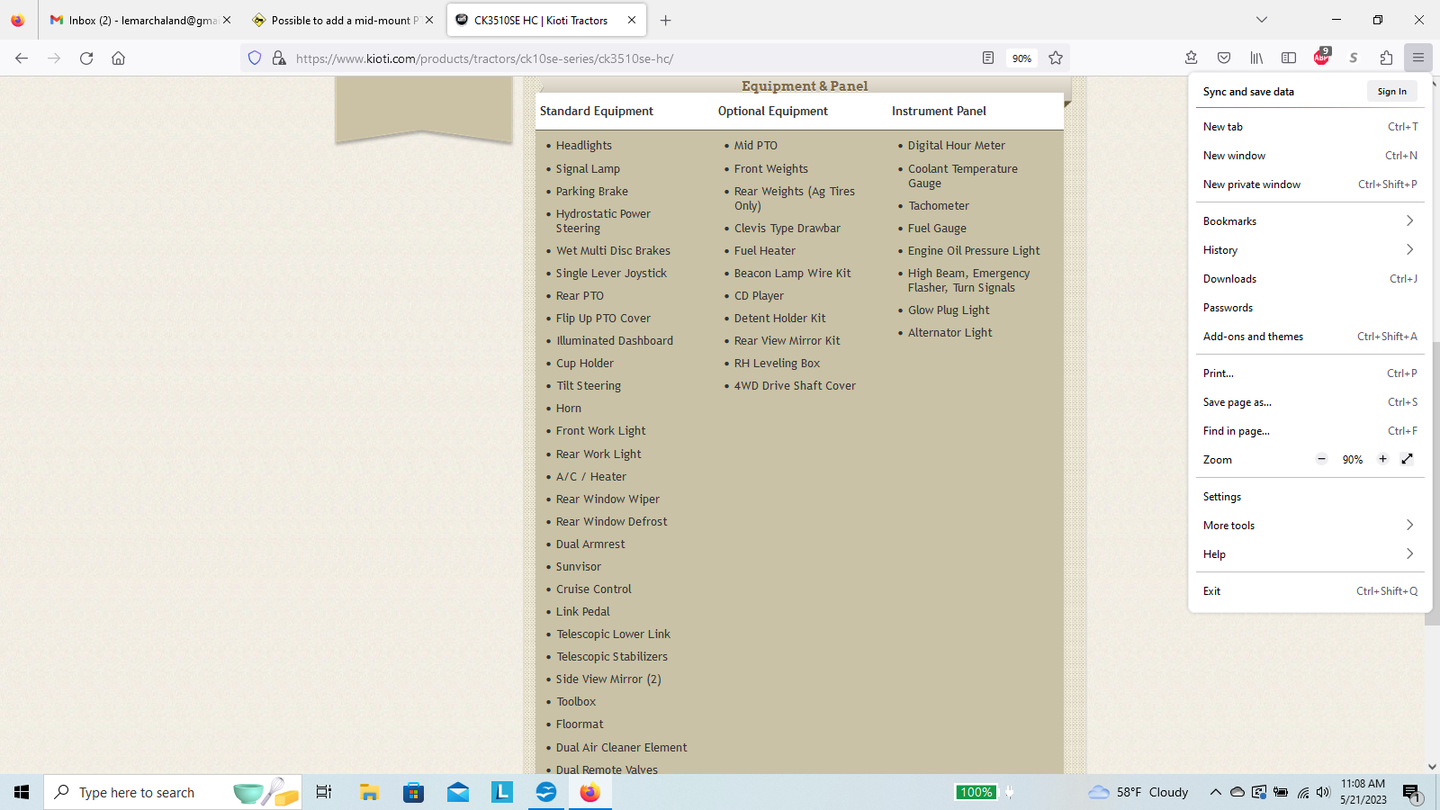

Ok, so my JD has a mid-pto. And I've tried the snowblower. But when I put a plow on with angle control via 3rd function, I'll never go back. Blower is just too slow. If you have to deal with high snow depth (2-3 ft), do it in time sequences whenever the snow gets to 6-12 inches.
Another option I've seen is a shaft run fwd from the rear pto, but you have to watch the shaft rotation direction your blower needs and the rpm.

Interesting -- I'll have to give this some thought, as I do have the 3rd function kit installed.
A blade would certainly be sufficient for my relatively short driveway, but the driveway is on an 1.25 mile gravel road that is not state maintained. I was thinking that a snow blower, even a slow one, would be much more efficient than a blade over such a distance. I certainly could be wrong, as I do not have any real-world experience with either yet.
Another factor is that I'm in north-central Virginia, where we only get a heavy snow every 3-4 years. Maybe we should just stock up on food and wait it out. :)
