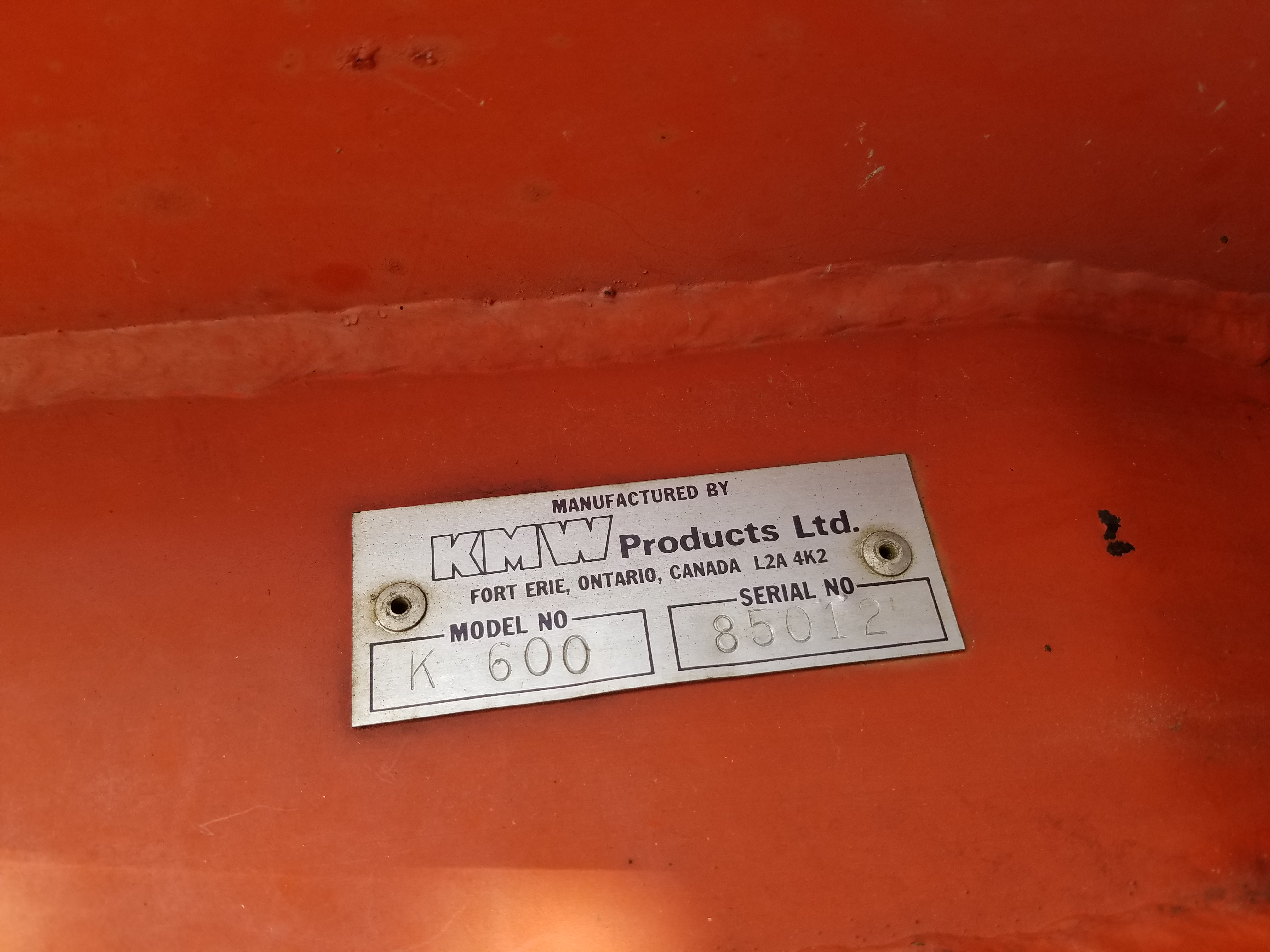

So I think I may have a minor issue with my loader/hydraulics or maybe I am just asking too much of my loader. I feel for the size of my tractor that the loader is a bit on the weaker side. I have a 5' bucket and itll lift just fine when picking up stone or dirt etc etc. Heaping buckets at that.
The part I feel that is lacking is: when I start to curl the bucket back with my bale spear (attaches to the bucket) and spear a round bale (4x4 600-700lbs) is that it has a hard time. Now, just to explain this a bit better, it will curl back if the spear is all the way in the bale but, if I can see a foot or so of the spear then there is not enough power there to curl the bucket back all the way to get it to slide down the spear. The bales we make are really tight so I don't always get it perfectly speared. Is this a case of just too much weight at the end of the spear for the bucket to curl or is there another issue at hand? It is my SAME mercury 75 tractor.

The loader is aftermarket. It is a KMW K600. Hydraulic level is where it needs to be. Not many leaks on the tractor itself. I changed out the hydraulic filter when I got the tractor roughly 3 years ago and only put on about 300 hours on it. I do have the owners manual and a repair manual. Not sure how many prior owners, I bought it at an auction. It did, however, have a dealer sticker on it and when I called them, they said they used to sell SAME tractors back in the early 80's so they did still have some left over parts for it. I have never paid much attention to the steering when lifting bales but I can say that the steering has its own pump and reservoir that I do top off periodically. I am not sure if this was put in afterwards because if I recall correctly, it is not in any of the manuals.

Are you aware the further forward from bucket attachment/pivot pin the load is located will exponentially increase the difficulty to raise or curl the load?

Like TXJim says: Sounds like typical operating condition to me. Large load extended out in front of the curl cylinders limiting ability to curl.
Take an empty 5 gallon bucket and hold it out at arms length and curl it up. Now fill the bucket and try it again. Same principal of force required.

I am aware. That why i was also included the part about maybe it is just too much weight in the front. It'll raise no problem with the bale that far forward but just wont curl.It'll also curl just fine when the bale is all the way on the spear. I just feel there should be more power there but maybe this is all the loader is capable of or maybe I am just used to stronger loaders.

As others have advised it's a matter of "foot-pounds". OEMs specify their products with a given distance from some reference point. Assuming you have a loader spec'd at some pressure and at some measured distance from some part of the loader say it's 2000# capacity. If you put that load at that point, it should lift before the pressure bypass safety valve opens and stops the lift.
If you move the load 2' out from that reference point, then you doubled the feet part of the equation. Since the limit is as stated, that means that you can only lift 1000#.
