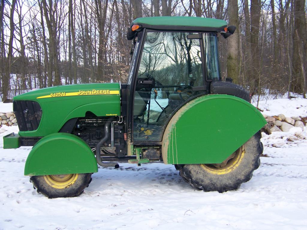

Gent on a neighbor farm, went back to work wrangling a keyboard and leased out his operation.
That left him with equipment to liquidate, and he gave me first dibs.
I'm not a Green guy, growing up and still running other stuff, mostly Landini and NH.
He's got a 5425N with the power reverser tranny, MFWD, and every gadget and gizmo Deere could shove into the cab.
The price is too good not to jump on it, swallow some blue pride, and ease off some on the old 85F and 1920.
The thing has 670 hours and is cleaner than my coffee pot.
The bizzarro tranny with the goofy toggle, electrogizmotronic 3pt controls, and all the electronic stuff in general has me wondering though.
I'm used to levers and not solenoids everywhere, and the whole flipping a lever without using the clutch is just...well..wrong.
Whats the track record on these power reverser trannys, and all the gizmos in general?
Do they hold up worth a hoot for 20+ years? Maint. costs?
The local Deere dealer is A+++ and golden plated diamonds IMO, but he does know how to explode an inputs budget with shop rates.
If this thing is a sick bay commando, and the gizmos don't hold up, it sucks the fun out of the bargain, and there's nothing I hate worse than a 2 day window to spray, and a tractor that gets a case of the Divas.
I'm looking for opinions and folks experiences with the model before pulling the trigger.
I appreciate folks taking thier time if you don't mind.

I can tell you this much, I have an 820 (1973), a 4520cab (2009) and a 110tlb. All similar in size and I like them all but the new tractors are much easier to operate in close quarters without a doubt. The 820 has been bullet proof and is 40 years old this year and I doubt that the new ones will be able to maintain this kind of track record no matter what brand. The newer ehydros I have have been great so far, I wouldn't worry about them. The power reverser trannies and power shift tractors have also done well. Nothing wrong with a gear tractor for most uses as they are dependable too but you do give up some convenience for the simplicity. My suggestion is to widen your scope and give the newer machines a chance. I say this because if you are not retirement age you will likely have to get used to it at some point.
Now I am not going to tell you that you won't have problems with all the electrical components in the newer tractors but they are not as bad as you may think. There are lots of things these newer tractors will do that a simple lever can't do. As an example a customer handed me a bag of seed that was about 15 lbs and $300 in cost, I need to spread this over 3 acres evenly. Being able to control my speed in .1mph increments makes this easier to do.
I suspect that narrow tractors are hard to find as low hour but older models. Most buyers of these tractors are commercial or farm oriented and would see more use than the common utility tractors. Lots of times I have seen very low hour utility tractors such is the case with my 820 bought it in 1996 with 1180 hours on it, so only 50 hours/yr.
My suggestion would be to look over the used tractors that fit your needs and try to determine their overall condition and suitability for your needs. I wouldn't be overly concerned about the newer electrical components so much.

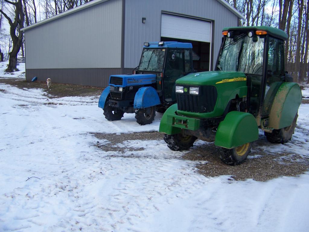

Well, I got her home.
Looks like it's off to the Deere shop for it's 600 hour valve lash adjustment, and general check up.
Untill I find a shop manual, and some time getting framilliar with it, I'm not taking a wrench to it...and there's no time for that, with spring looming and other stuff in the shop.
Thanks for the thoughts and opinions gang!
I suppose it will work out great for a Spray tractor, and for mowing/tilling once things get into the hotter months.
Darn thing is about as comfy as a tractor gets.
