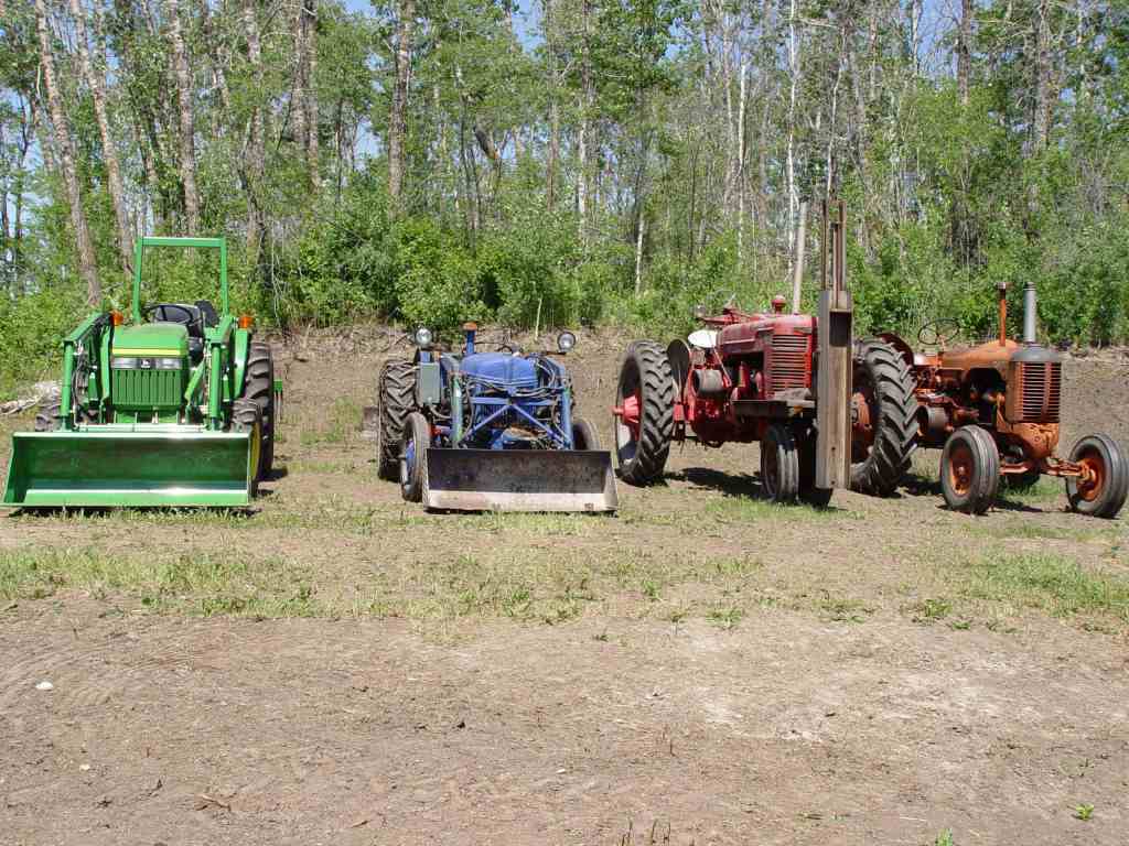

We've got an old Shafer post driver mounted to the front of a Farmall M. The bushings on all the tilt adjustments are worn out and the thing wobbles around a bit, and the M is not quite as cushy to drive as my 990, but it can't be beat for getting in tight places, especially with the narrow front end.
It is the red one in the attached picture.
