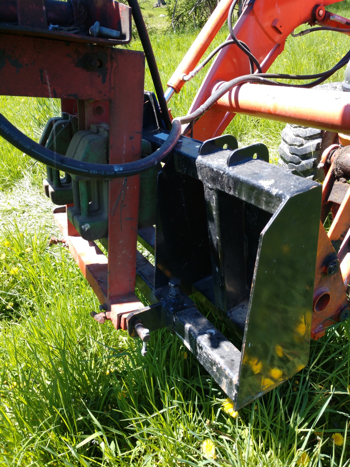

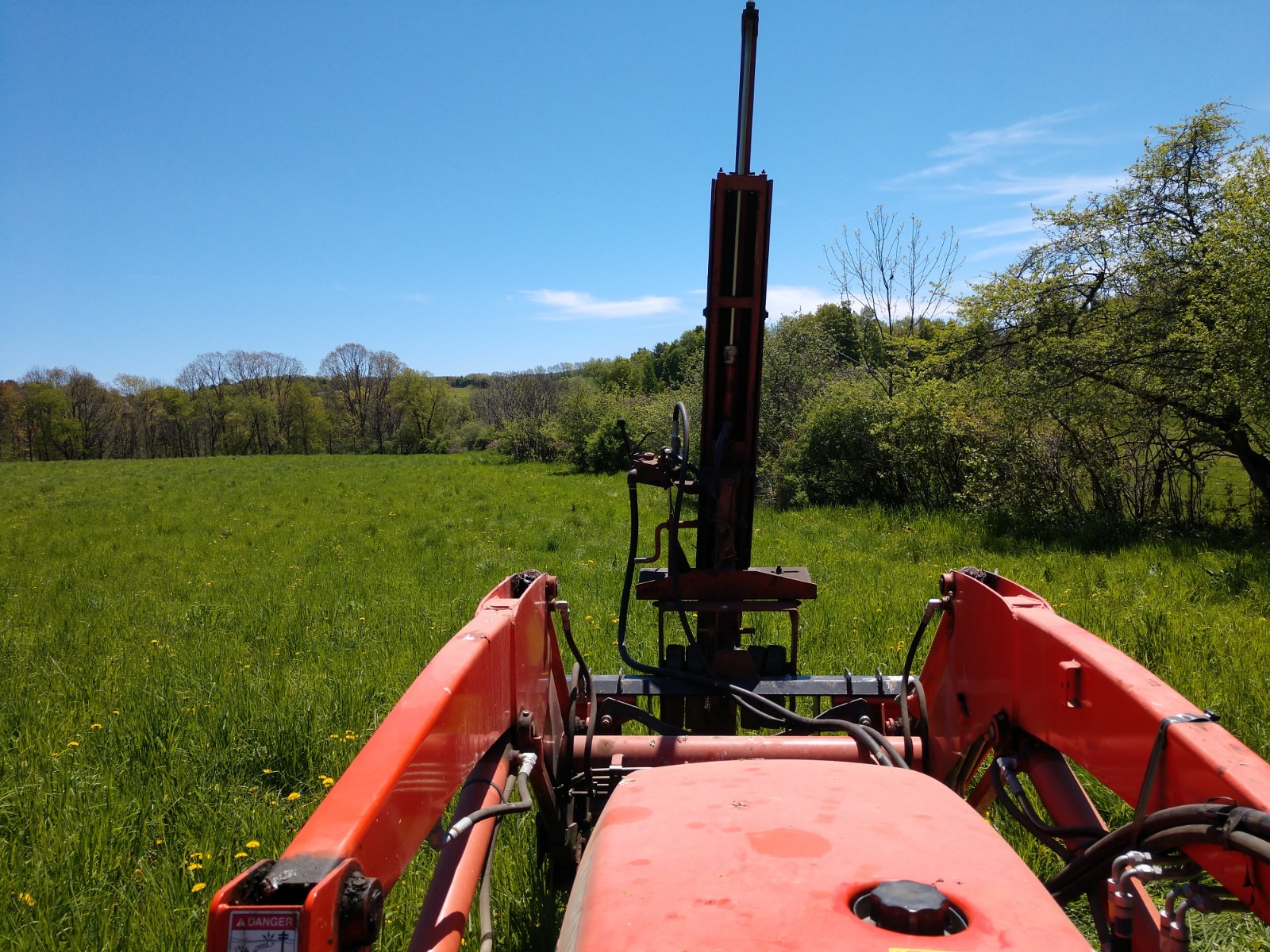

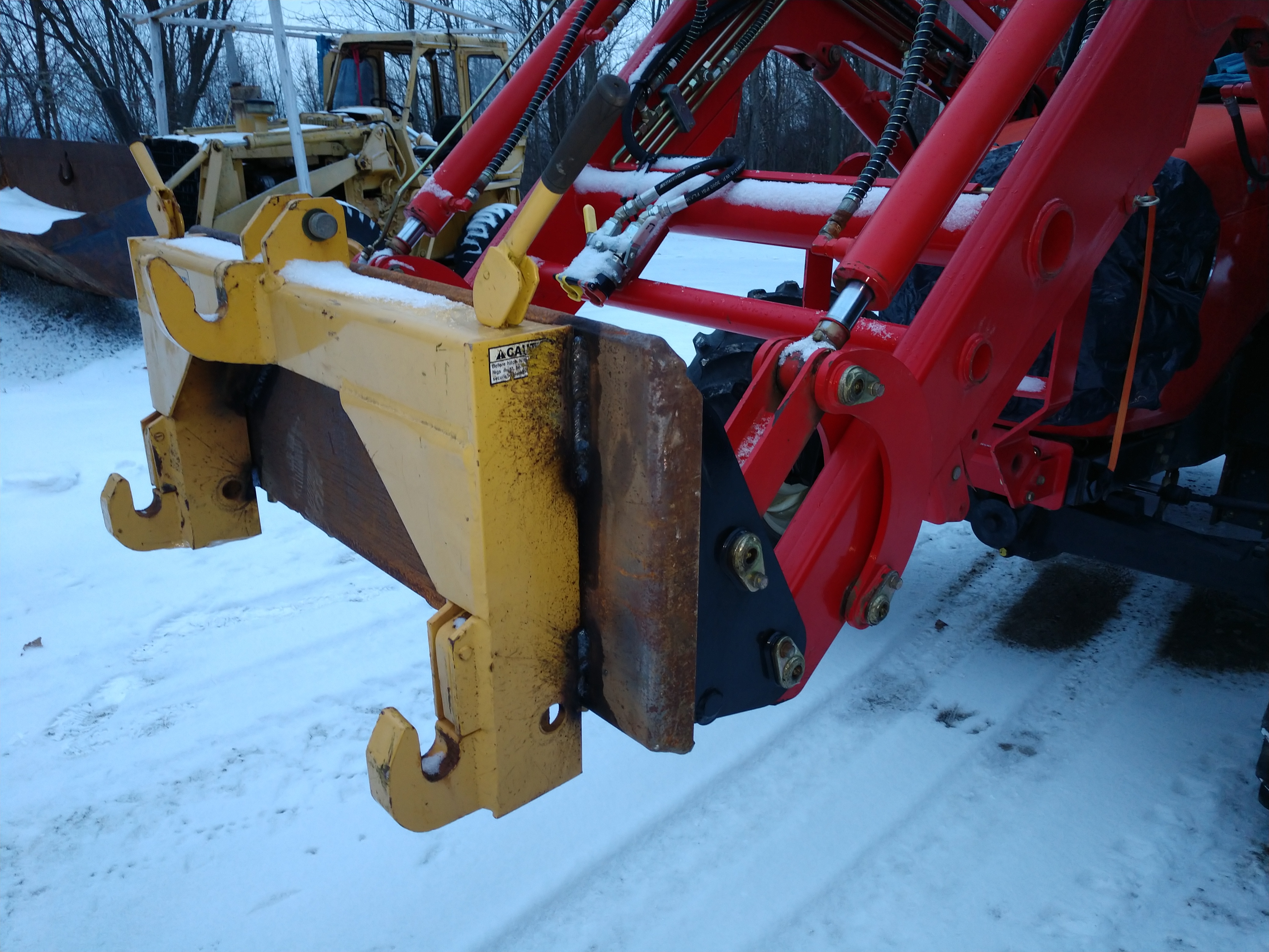

This one is using a light duty 3 point to SSQA adapter.
The curl takes care of one direction and ours has a hand crank for the left to right adjustment.
