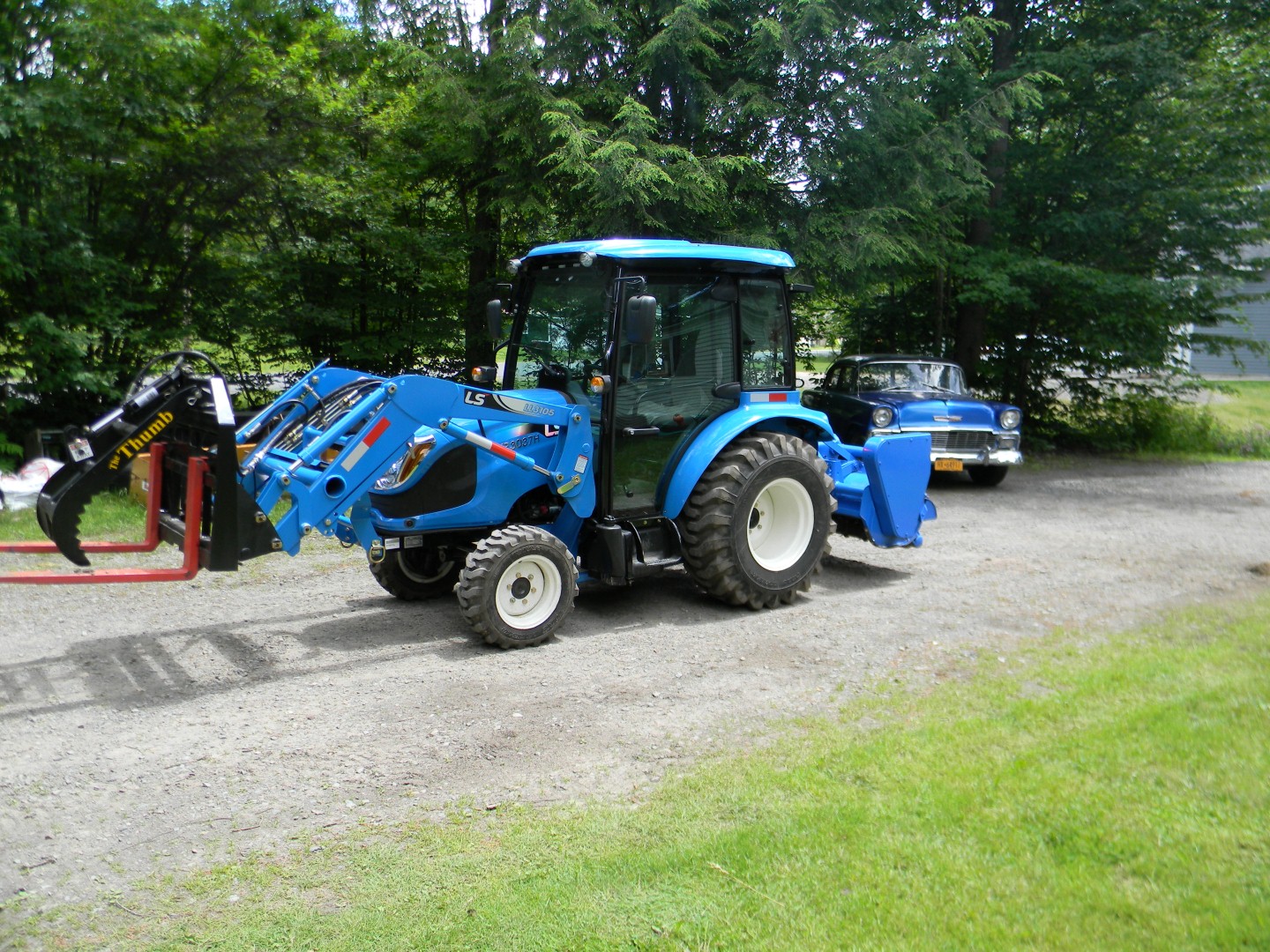

I also have been considering an FEL auger. Once I figure out which hydraulic motor to buy I'm going to build my own. My pump output is just under 10 so I need a motor that runs in the 6-15 GPM.

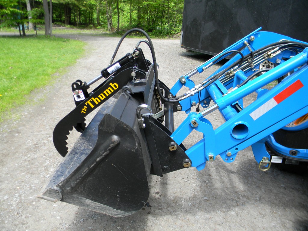

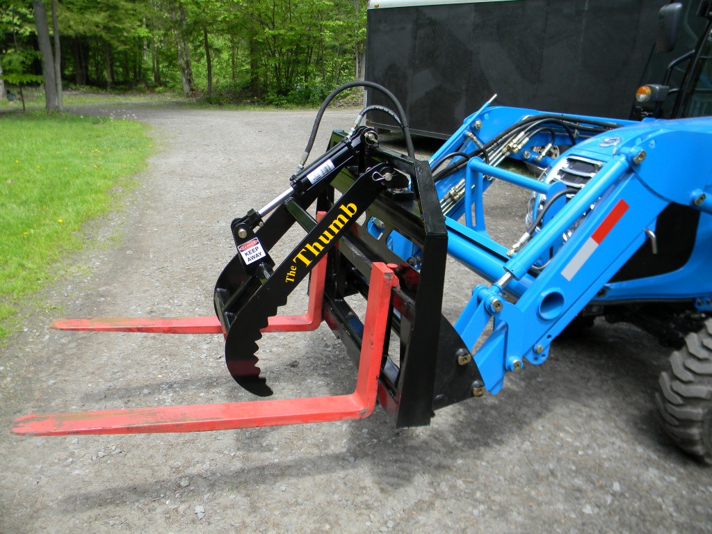

I ran 1/2" hoses from my rear remotes to the front for my hyd. thumb. I can use the thumb on the forks or loader bucket. I bought the quick connect fittings and ready made 3000 PSI hoses at tractor supply. The fittings were the most expensive items. I thought the hose was reasonable. Hoses were about $40 ea. QC's were $20 a set (male and female). All together my cost was around $200.
From what I've been told about mine (similar to your loader) you should look at the 750 unit in the 7-20 GPM range. Ready to go FEL QA augers with one bit seem to be going for $1900 and up so if you only need 100 holes it would be cheaper to pay to have it done. If you may drill more you might spend more now buy then you'd have it when you need it.

That thumb is awesome!! I just moved some piled up brush from my fence clearing project and that would have come in handy, I had a tough time with just my forks.
thanks for your input, ya, If I can spend an extra $1000-1500 and then still have the tools at my disposal after the specific project I would always rather do that.

My thumb was about $600 including 2 base plates (1 for forks, 1 for bucket) plus the hoses I mentioned so about $800 total. Now that the hoses are there I can use any hyd. attachment up front that my GPM will power.
