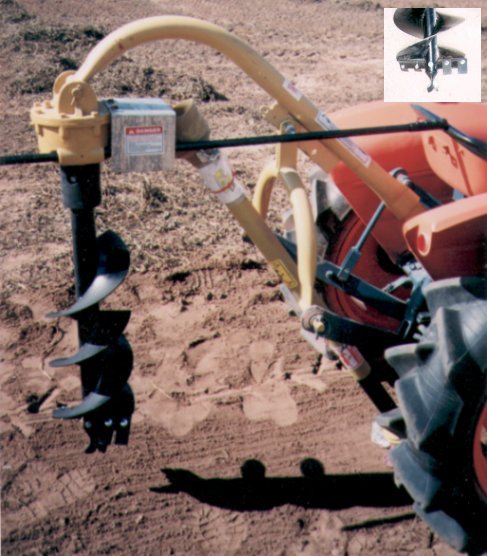

Try Vassar Farm Equipment. You can see their post hole diggers and other equipment in their on-line catalog. Great folks to deal with. They specialize in implements for smaller tractors. They offer a post hole auger that would work well with the BX or a 2210. I believe the auger depth for the estate size is 32" and comes with either a 6", 9", or 12" diameter auger. The next size up, which still might work with the BX or 2210, would have an auger depth of 45" with the same diameter auger. Call first and let them know what model you have. They will sell direct to you and ship to your door.
   / Post Hole digger for BX size tractors #4
Here's a pic of the estate post hole digger. I'm contemplating one for my 2210.

Hello KC, I bought a full sized Speeco unit and had the boom modified to be able to lift higher. There are three holes through the boom and the highest setting did not raise it up high enough, I had another piece welded on to lift even further. Now I am able to drill full depth, 42" or so and it does not drag on the ground.

KC,
The depth is 32" for the estate auger and 45" for the full-size auger. I think the full-size unit would have to be modified unless you want to drag a trench to the work site.
I expect the estate unit will break the $400 cost level so I am budgeting accordingly. I'm not done shopping either. Your best bet is to call Vassar directly for a quote and lift height specs.
