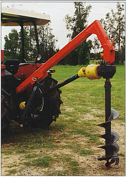

I have spent the weekend putting up some new fencing and I have a very bad habit of drilling the post holes crooked. While this is not too much of a drama because I fix it when I ram the earth home it takes more effort. Can someone offer tips and hints on drilling post holes?
The PHD I'm using is similar to the one in the attachment.

What do you mean by 'crooked'? It's not unusual to have to move the tractor slightly forward or backward (usually forward), to keep the hole perpendicular. I position the tractor so the bit is perpendicular to the ground then start digging. About half way to the depth I want, I stop the PHD, get off the tractor and look at the auger from the side. If it's not still perpendicular, I move the tractor until it is and start digging again.

I know what you're going through. I recently completed putting in 260 fence poles to make a pasture for horses. I imagine that when you say crooked, you mean that the bottom of the hole leans in towards the tractor when finished. What worked for me is that I would lower the bit until it contacted the spot I intended to drill, next I would move the tractor forward slightly, then engage the PTO. It takes a little getting used to, finding the right amount to move the tractor.
Remember the PHD is mounted in such a way as it will move in an arc. By moving the tractor forward (so that the bottom of the bit is slightly farther away from the tractor than the top of the bit) you'll reduce the effect of that arc. Hope that helps somewhat.

Yeah thats what I do most of the time but just sometimes I just get it wrong. I thought there may be some trick to always getting it right. I have noticed that there are diggers with a handle attached to the top. What is this handle for and how effective is it?

<font color="blue"> I have noticed that there are diggers with a handle attached to the top. What is this handle for and how effective is it? </font>
Some of the handles are for applying down pressure. Others for adjusting the digger from the tractor seat. My PHD had one for adjusting the digger from the seat. I found it got in the way more than it helped. I ended up tossing it away.

Finally figured out to start the hole with the auger angled back abit to offset the natural effect of the auger to work in an arc. It also works to pull forward a bit about half way through the hole. Also had a problem with the hole moving to the side as a result of the torque of the auger spinning to the right.
Made sure the chains on the lower links were as tight as possible but in really clay soil conditions had to have the help of another person to hold the boom on the PHD straight.
