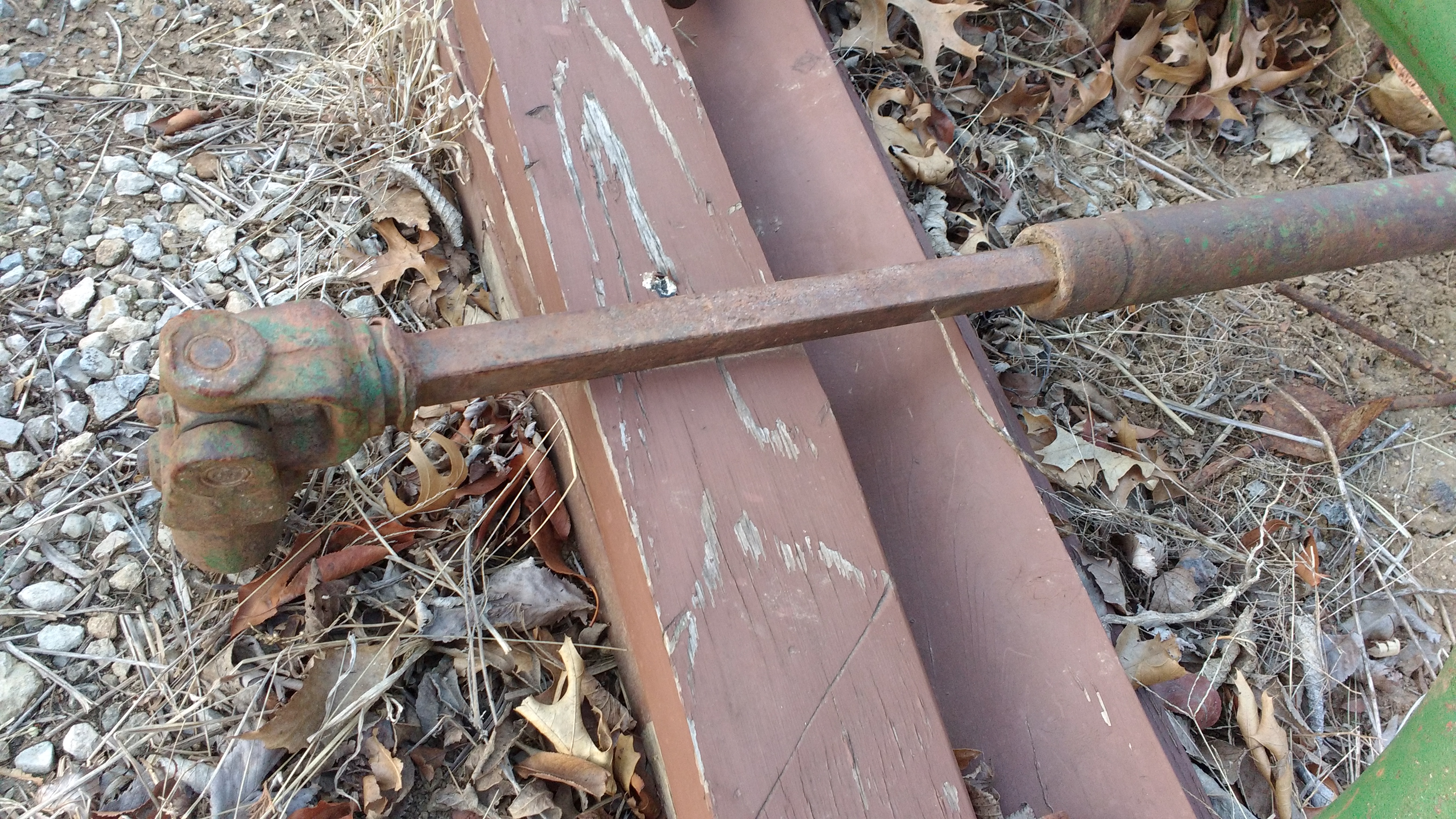

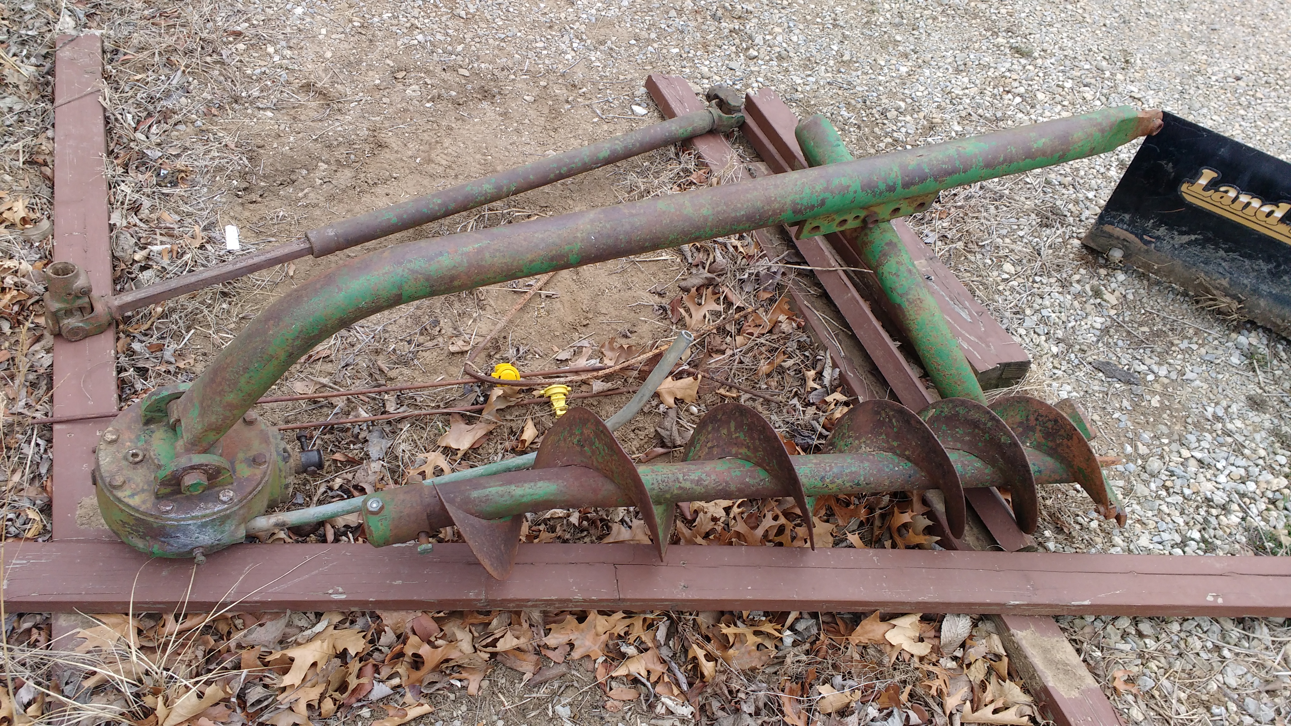

Relic PD with a frozen PTO shaft......... Can this be heated with a torch to loosen the grease or am I doing more harm than good? :confused3:
   / Post Hole Digger Question.......... #2
Yes you can heat it .Then try and pull it apart ,and clean it up. I doubt there is any grease in it
Thanks Peter 315! I'll give it a shot!
   / Post Hole Digger Question.......... #4
Worse case scenario a new shaft is under $200 or so at TSC. Penetrating oil, some heavy pulling while chained to a tree & maybe some heat might work. Cant hurt to try. Dont hitch it to the PTO on your tractor to try & pull it apart. Liable to break expensive things that way. Chain it to the hitch.
My old PHD ran fine for a long time after I bent & mostly unbent the PTO shaft... Twice. I was slightly off on reengineering the PHD to fit on my QH. Worked great as long as you extended the hydraulic toplink before lowering the 3pt.
   / Post Hole Digger Question.......... #5
Heat and penetrating oil are your friend. Penetrating oil has never done much for me when in a hurry but if no rush I have seen the stuff work wonders when you spray something daily for a week and then try taking it apart.
   / Post Hole Digger Question.......... #6
Let it soak in a bucket of evaporust that stuff works great.:drink:
   / Post Hole Digger Question.......... #7
Soak it in diesel fuel for a few days. A piece of rain gutter, cut to fit makes a good soaking container.
   / Post Hole Digger Question.......... #8
Get it hot enough for some candle wax to seep in.
JW5875
   / Post Hole Digger Question.......... #9
My 'heat wrench' almost never fails. I've never tried the candle wax thing, but I bet that does work...
Thanks fellas! lots of good ideas.......... replacing it might be the way to go..... Thus far I've invested $75, so I can afford to spend some money on it.... :)
