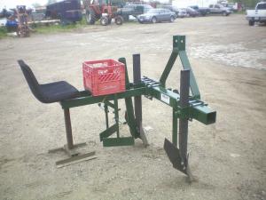

I have two potato planters, both are three point hitch and one is a single row while the other is a double row. I bought them with planting potatoes in mind but haven't got around to doing that quite yet...hopefully this coming pring we will have a go at it. They look quite similar to this one. I bought them used and haven't much money invested in them, about $200 for the pair.

If I was to do more than a personal garden, say multi family or small truck garden, I would use my homemade 3pt chisel digger, and row hiller for ground prep.. Then fashion a ride on planter similar to the unit Mace shows as ground speed to do these tasks are enough different to multi task.. Then you have to consider harvest.. Small plot potato diggers are available, and look to work very well... But it seems to me there would be a time to payback issue due to the cost of these machines...
